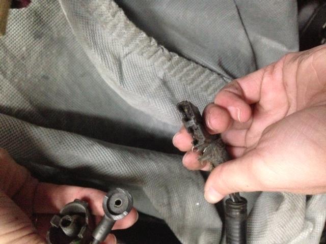

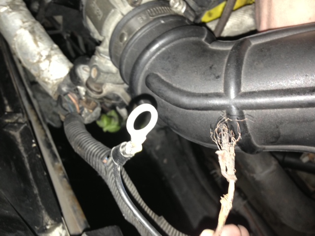

kathryn DEC 28, 06:02 PM
Hello again everyone,
I hope you all had a great day! For me it's been a little cold and frustrating with finding these electrical connections. Zep you are right, they are a headache. Thank you for all the advice I could use all the help I can get for this whole wiring harness. It is probably my second least favorite thing, after sanding of course.

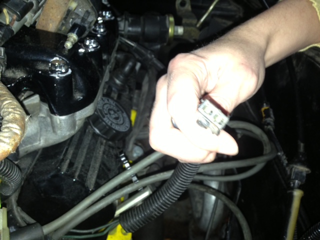

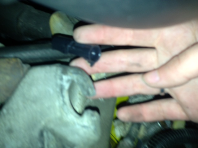

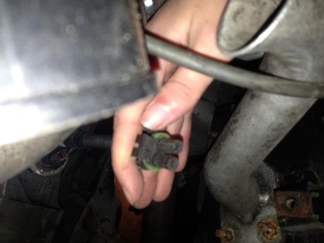

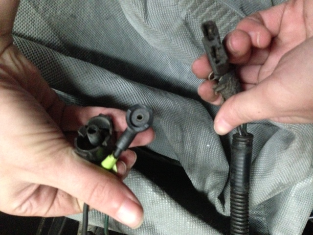

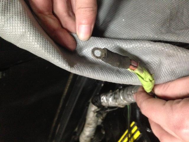

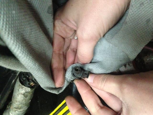

I have some photos with certain connections and pieces that I really haven't figured out what to do with. I'll add them to this post. If any of you know what they are and where they go that would be fantastic because my dad and I both feel like we've hit a bit of a dead end with this.
Other than that I fixed up a few mistakes with loose hose clamps and a missing gasket in the coolant system today along with finding a few more of the electrical connections. We've now got horrible weather here in Michigan, that snow I wanted for Christmas decided to show up today and it's now pretty cold outside.
Here are all the connections I am struggling with, any help would be greatly appreciated!
I hope you all are doing well and that you have luck with all your projects, work, etc! Thank you all for everything!
-Kathryn
88lambofiero DEC 28, 06:45 PM
Some of these may be wrong because I am use to looking at the engine. Hope this helps if you need pics of how thing run I have a 85 GT in the garage I can use.
http://images.fieroforum.com/2015/photo_3_7.JPG
O2 wire
http://images.fieroforum.com/2015/photo_4_7.JPG
oil pressure relocation tube. I believe
http://images.fieroforum.com/2015/photo_5_6.JPG
Tack filter
http://images.fieroforum.co.../photo_9_(Small).JPG
wire for the small stud on the starter
http://images.fieroforum.co...photo_10_(Small).JPG
looks like ground wires
http://images.fieroforum.co...photo_12_(Small).JPG
MAP sensor
http://images.fieroforum.co...photo_13_(Small).JPG
I believe this is for the EGR and cruise control
http://images.fieroforum.co...photo_14_(Small).JPG
EGR control solenoid
http://images.fieroforum.com/2015/16.JPG
The oval one is the temp wire. That dirty one has not been hooked up on the one I have work on
