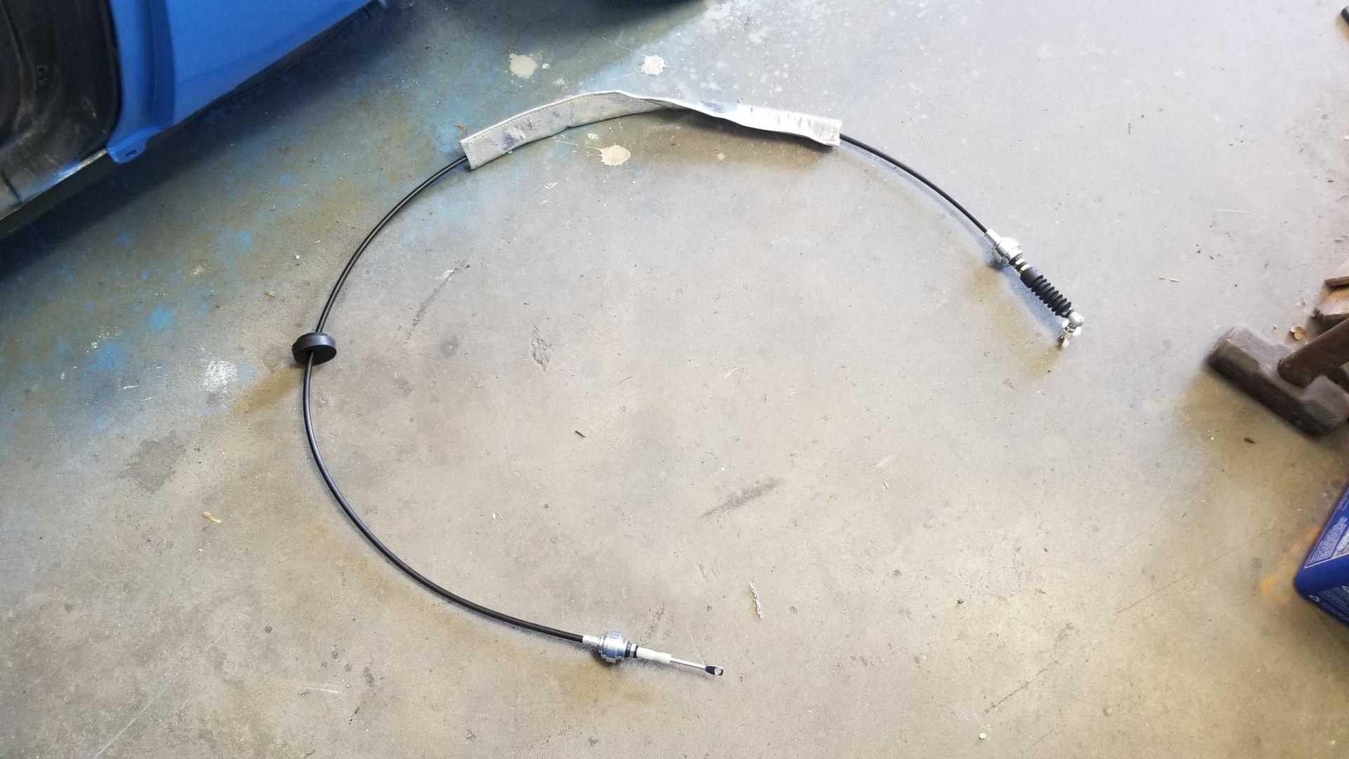

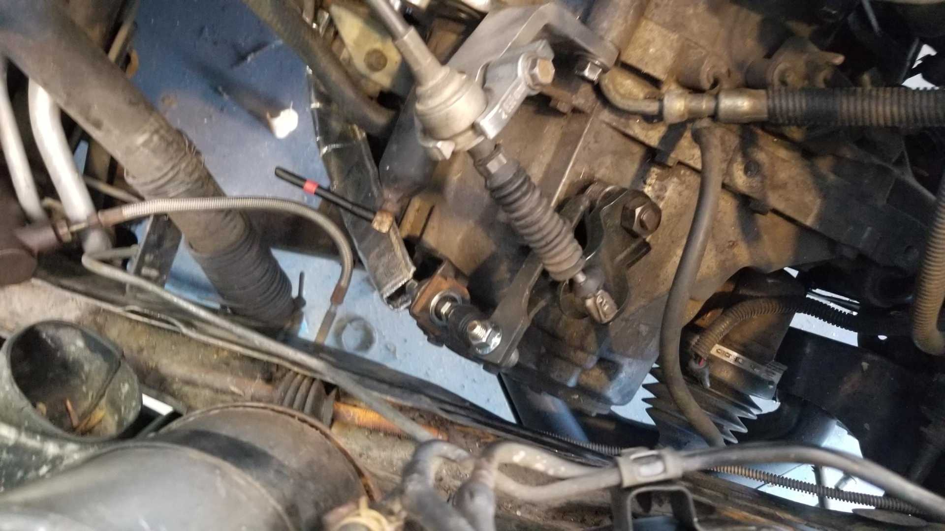

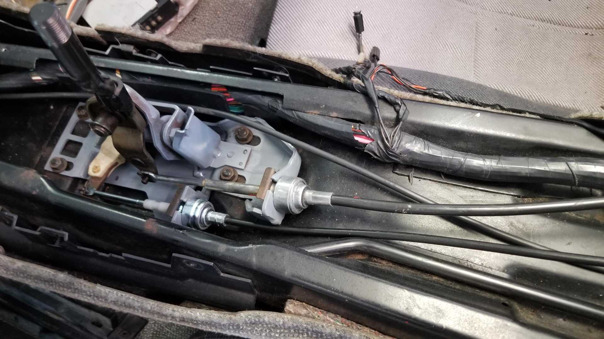

I ordered a new select cable from Rodney and installed it today. Shifting through the gears is much easier now (of course, it’s without the clutch pedal hooked up to the slave cylinder).

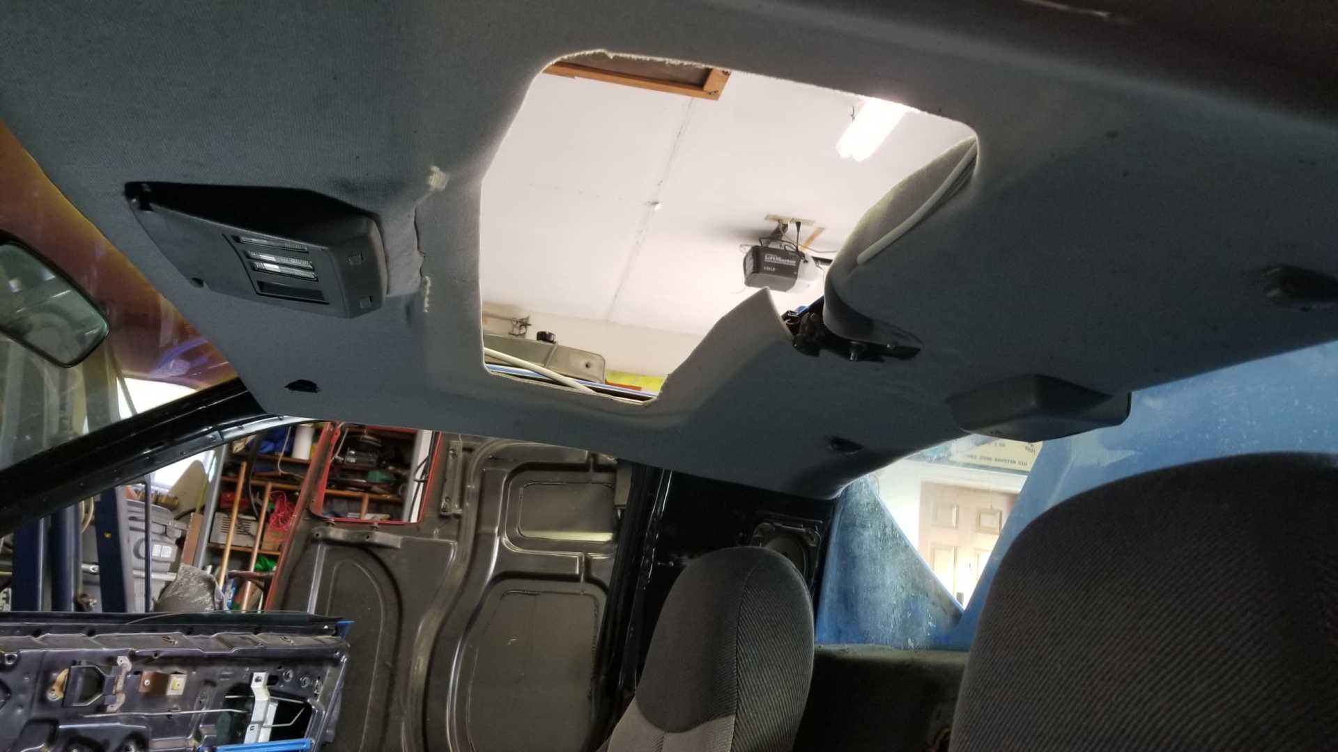

I tried gluing a new section of headliner material onto the backer board and screwed it up yet again. I’ll get some more material tomorrow. I figured out what I was doing wrong.

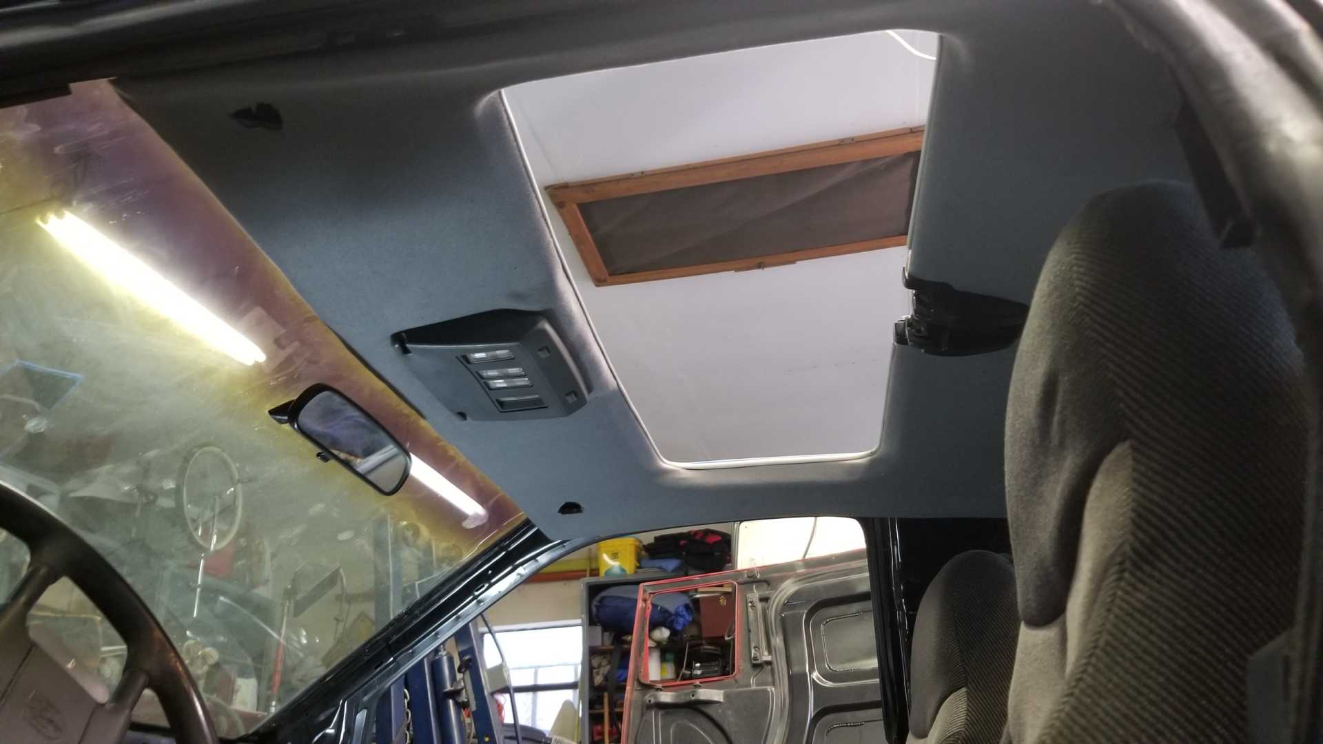

Quadfather DEC 23, 08:42 PM
I reupholstered the headliner backer board and got it installed. It fits much better now.

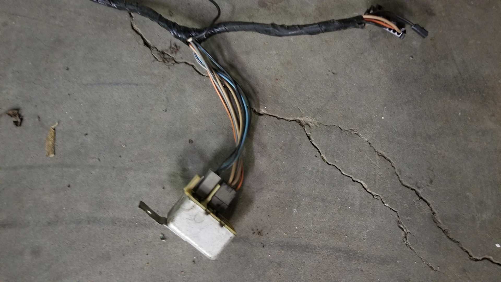

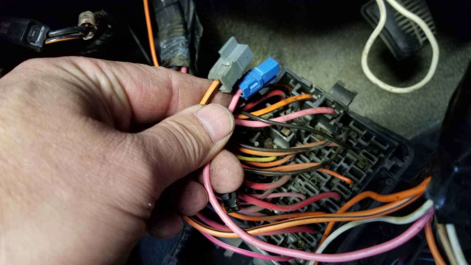

I’ve been working on installing the wiring harnesses for the power windows, locks and mirrors. Here’s a separate thread I started about connecting the harnesses to power:
http://www.fiero.nl/forum/Forum1/HTML/099136.html
I finally figured out that I need to connect the two wires I’m holding here to the similarly colored wires attached to the fuse block. I already added the 30 amp breakers to the fuse block years ago, when I first bought the power doors and wiring harnesses from a salvage yard car.
[This message has been edited by Quadfather (edited 12-23-2019).]

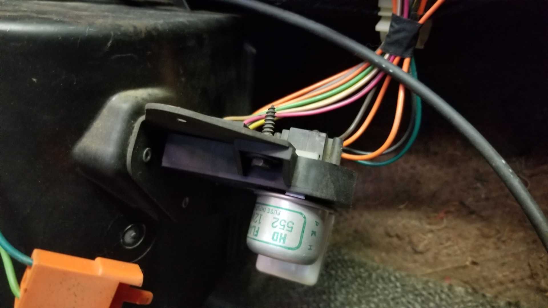

The passenger side installation was even easier. There’s a circle cut in the sound insulation and a screw hole drilled in the space frame to mount the junction block at the other end of the harness.
While I was in there I saw that my car doesn’t have a blue dingy thingy.
I’m also considering taking the shroud off to look at the heater core. Wouldn’t hurt to replace it while I have the dash out.

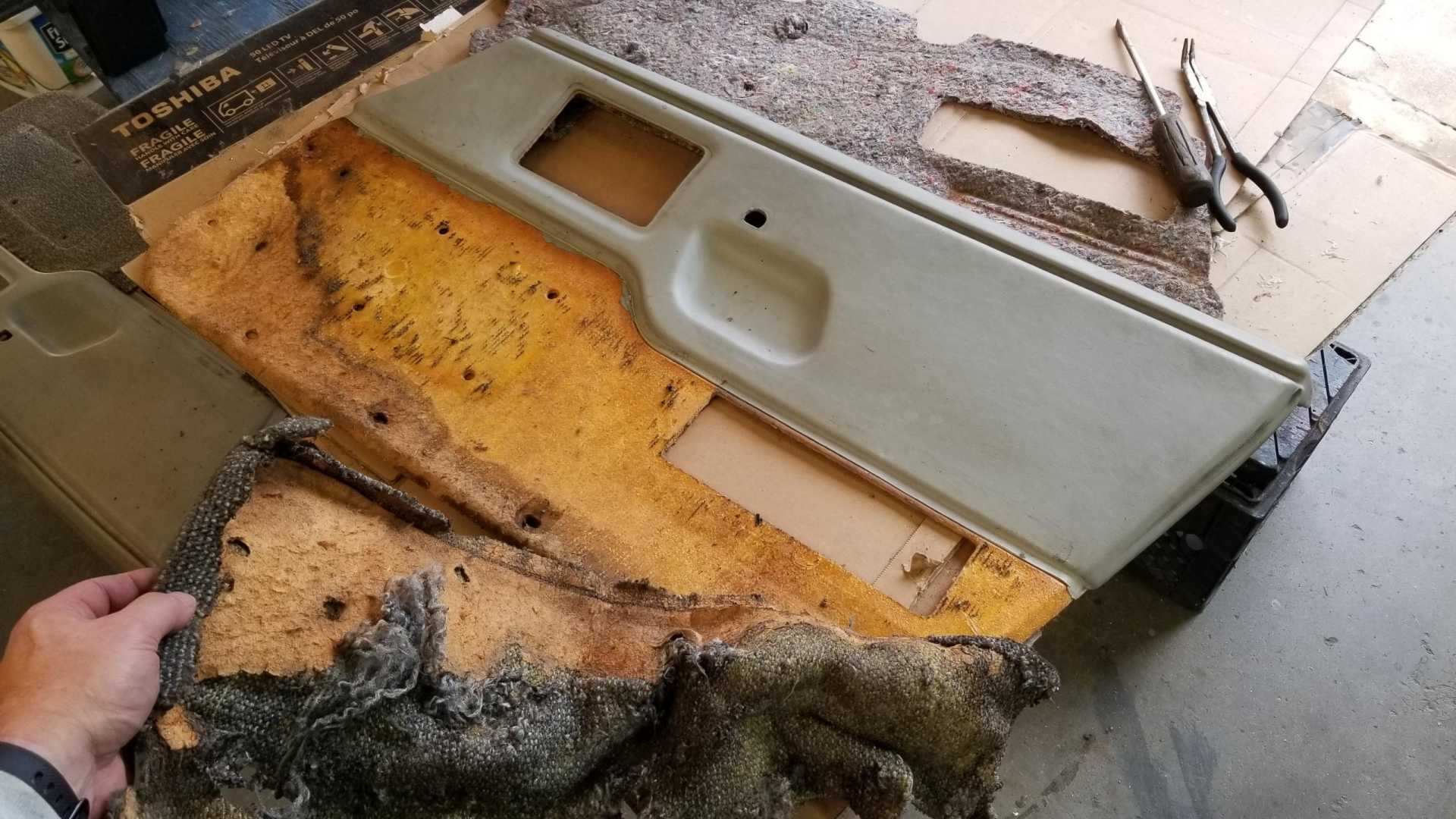

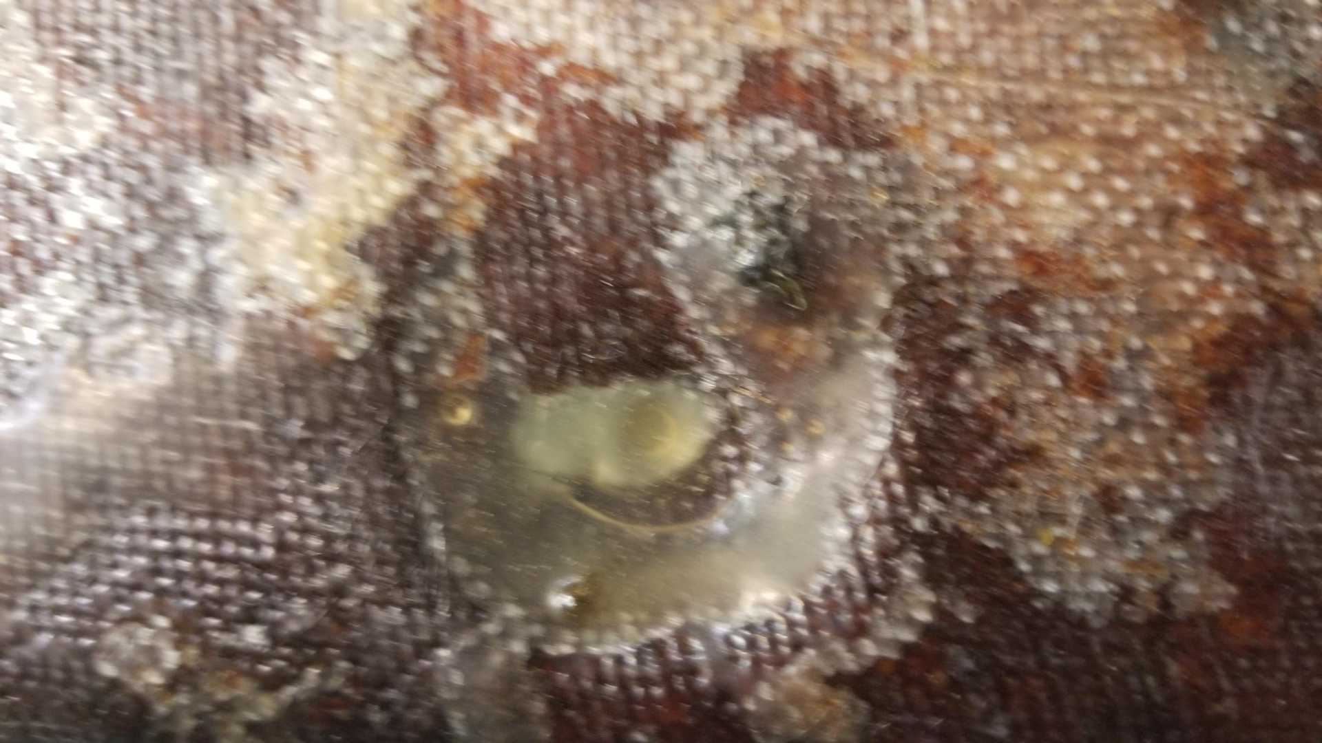

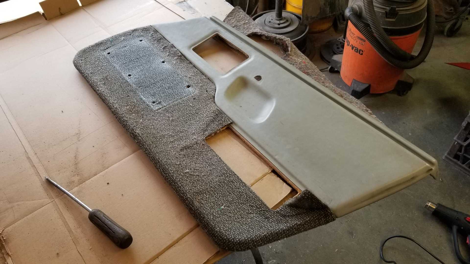

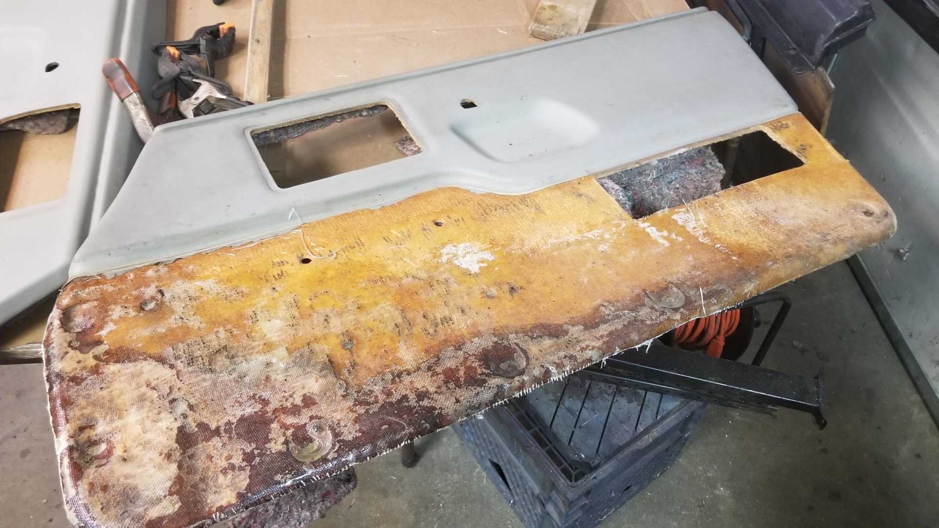

I’ve set the wiring issue aside for now, mostly because I’m hesitant to hack into the car’s original wiring. Instead, I started work on the door panels. I bought a set of power window door panels from a salvage yard car a few years ago. As usual, they’re in worse shape than I thought when I bought them.

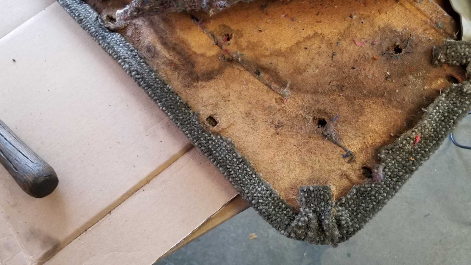

It appears the passenger side one got wet, so the bottom part of the backer board is very flimsy. I saw someone else’s post about removing the carpet using a heat gun and elbow grease, so that’s what I did.
Took at least 30 minutes to heat the carpet and pry it off while doing as little damage to the backer as possible.
I then put a layer of fiberglass cloth across the bottom 5 inches of the back side and glued it on. We’ll see how it looks tomorrow.
While Christmas shopping for my wife at Hobby Lobby today, I bought some black vinyl material that I plan to use to replace the carpet. More to come.

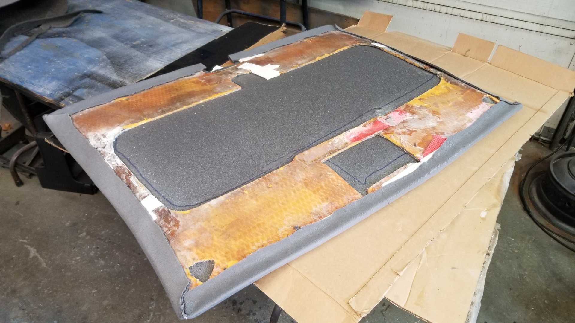

Quadfather DEC 28, 10:32 PM
More progress on the door panels. One needed a lot of fiberglass because of water damage, the other one needed some help around the mounting holes for the plastic clips that hold it to the door. I cut small pieces of fiberglass cloth for each one. A Dremel made quick work of opening up all the holes once the resin cured.
