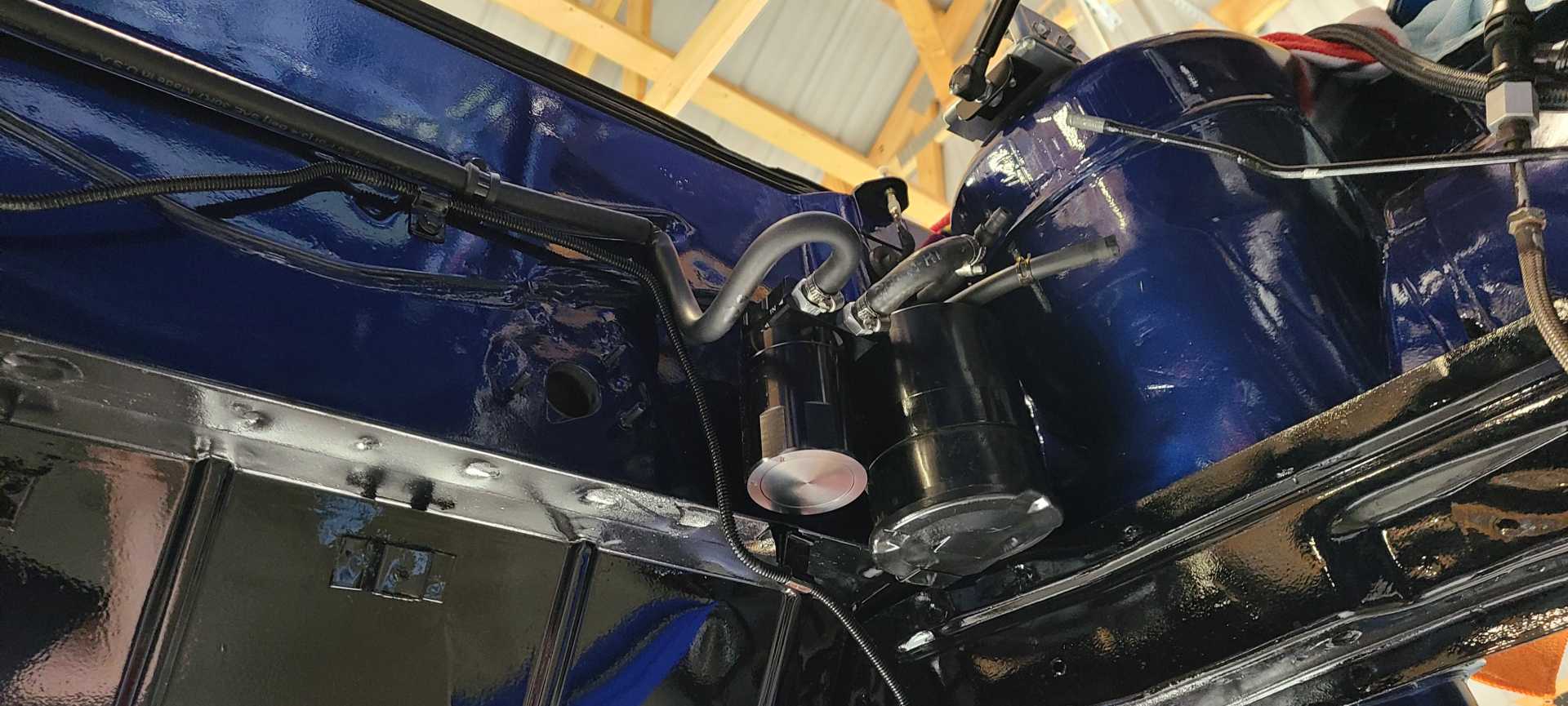

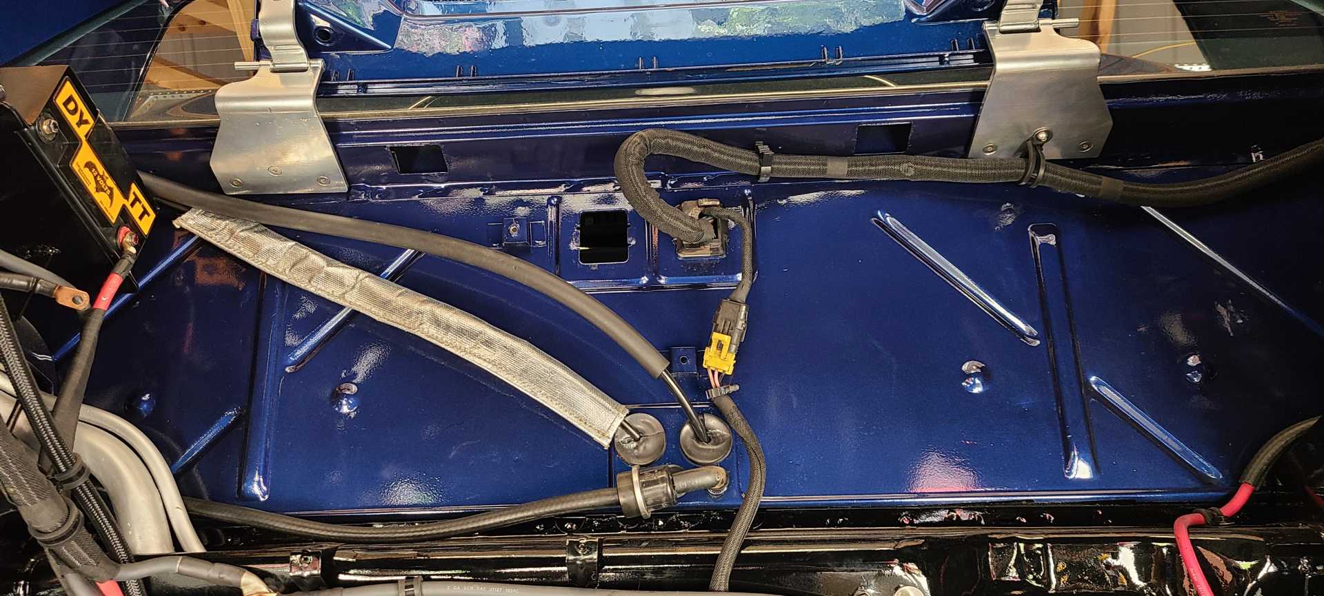

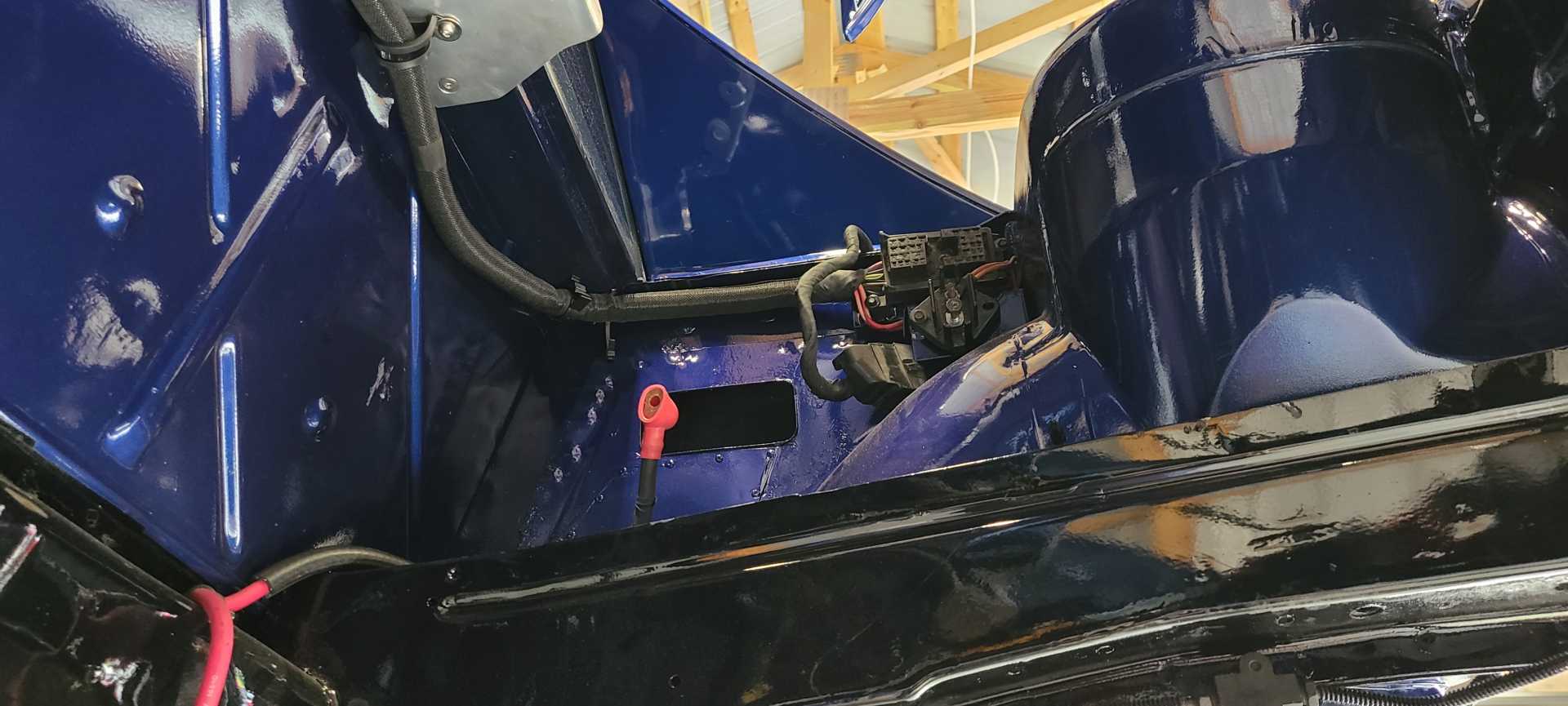

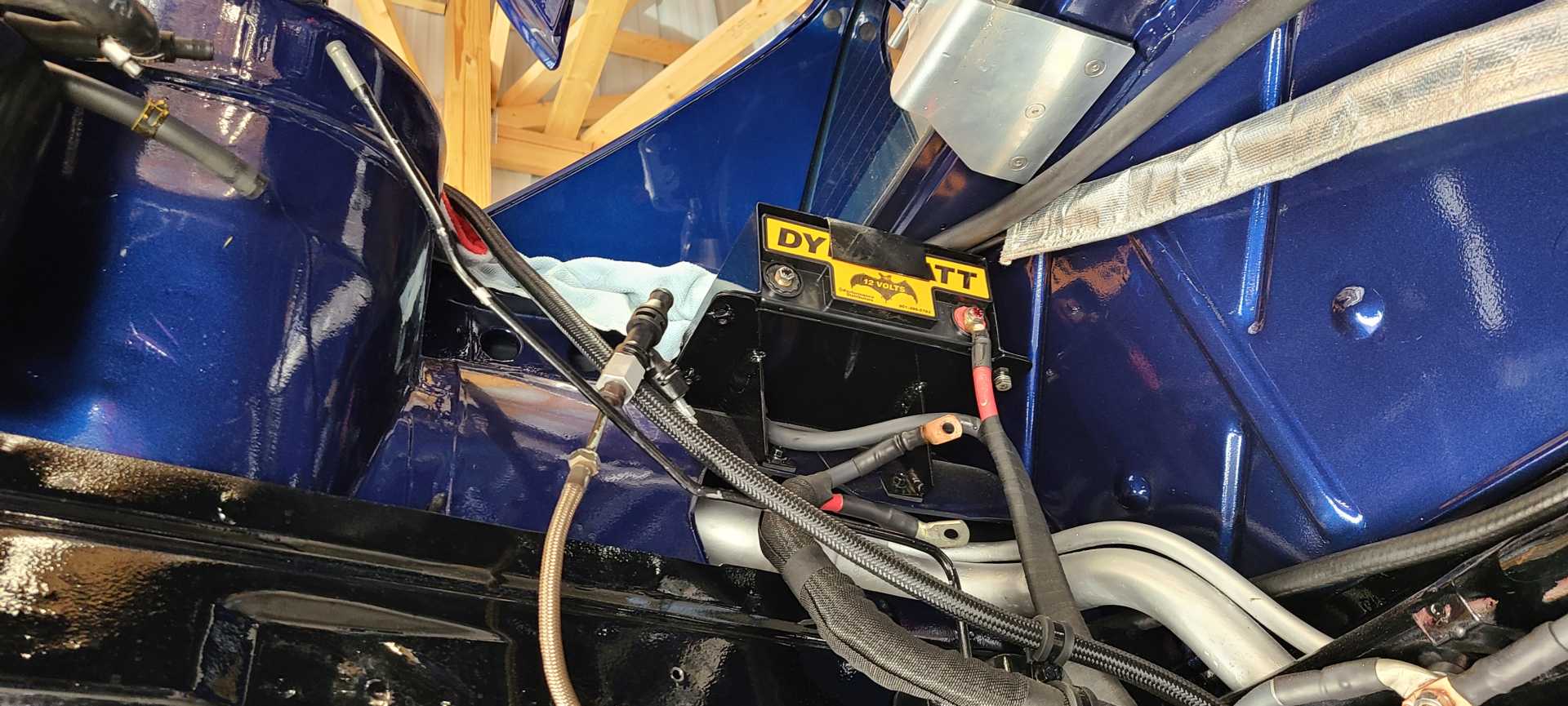

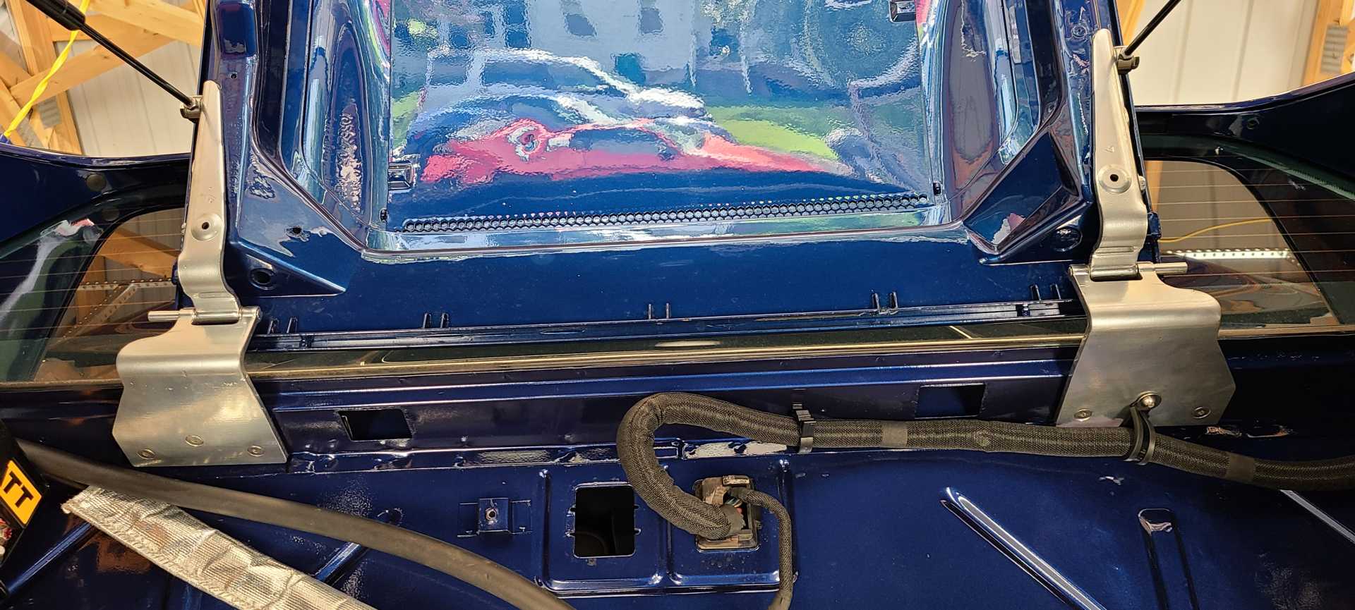

I also took the opportunity to snap some close-ups of some of the mods from the build that were missed for close-ups in the initial haste:
PPG3 Hinges
Battery Relocation:
Redone C500 harness mounted:
Oil Catch Can:

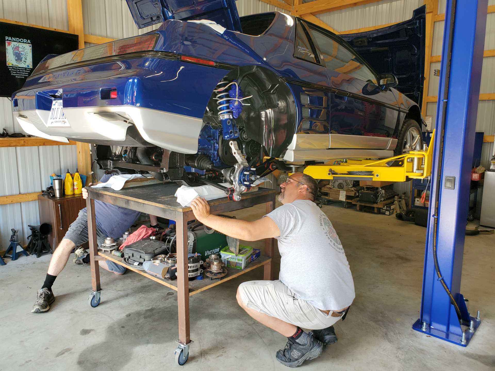

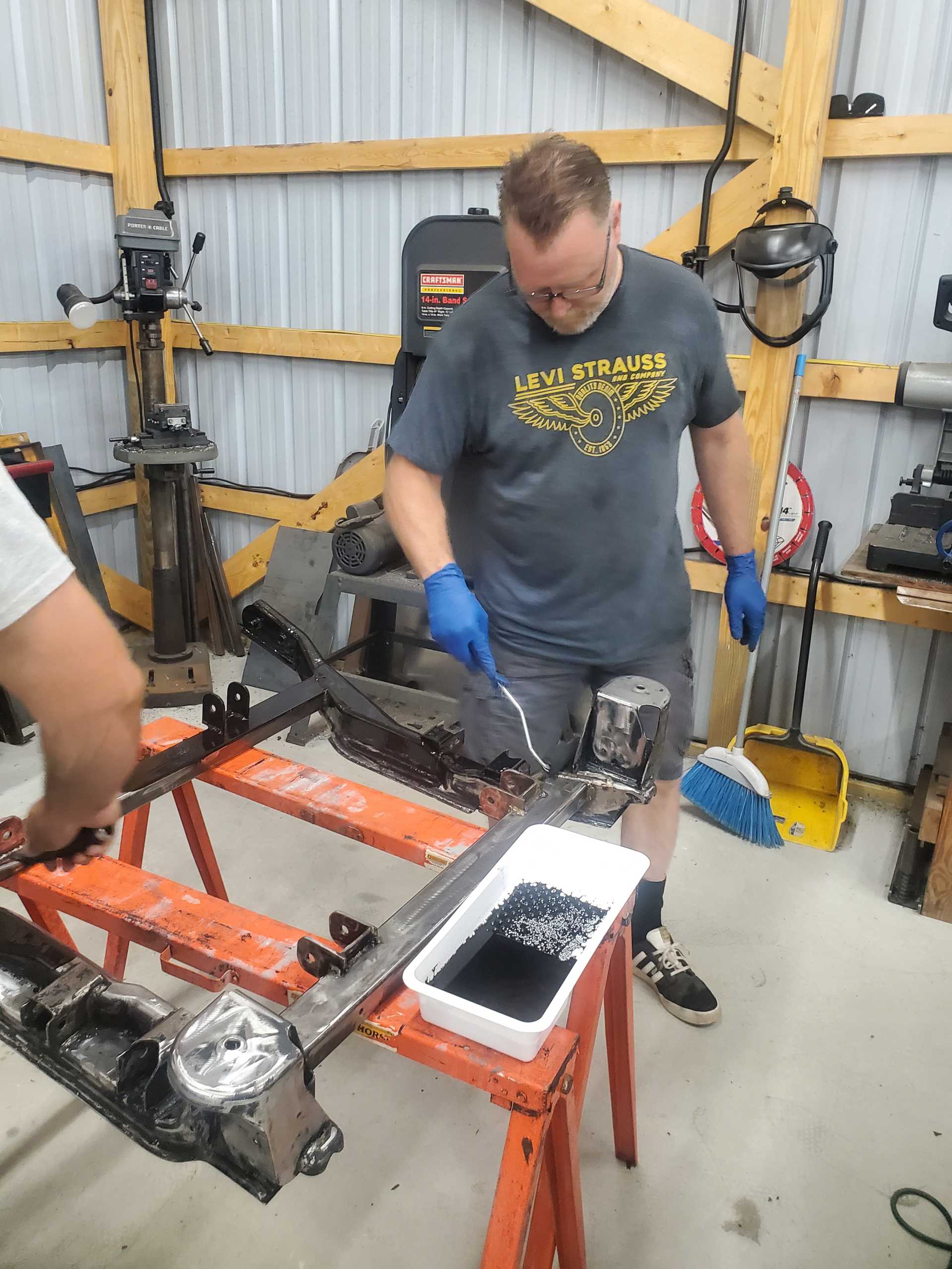

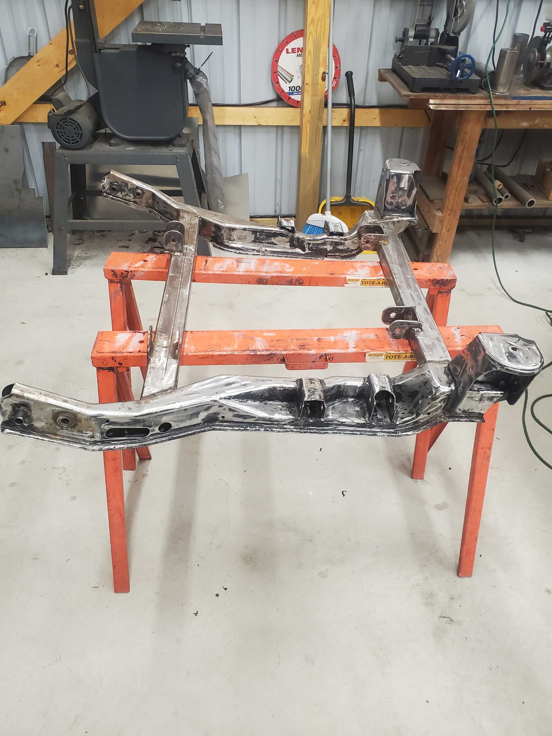

The next two days at Gary's allowed us to get the cradle redone:

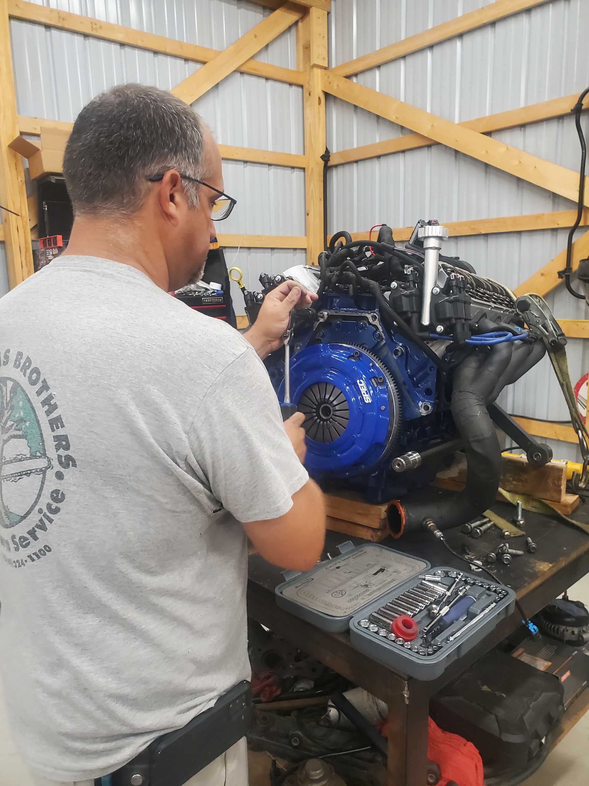

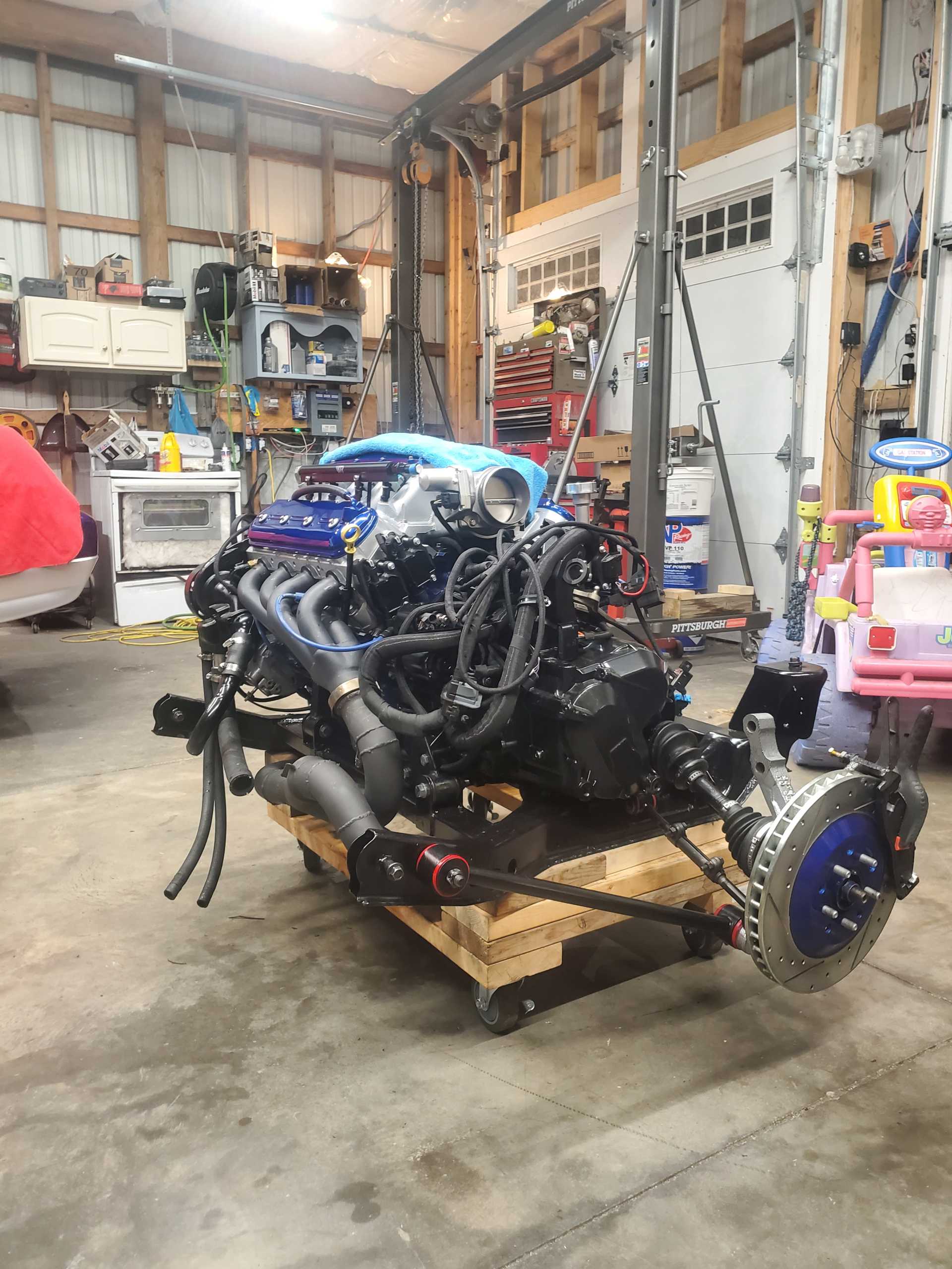

Additional adjustments were made for the trans to be remounted:
And the engine was reinstalled:
Since Matt had also made some adjustments to the tune, I desperately wanted to take it for a spin but we needed to get home and Matt wasn't convinced it was fully burped - it's definitely one of the more PITA things about the swap. Sure enough, as he was backing it up to load it, she spewed a bit and Matt got to say, "see!" LOL.

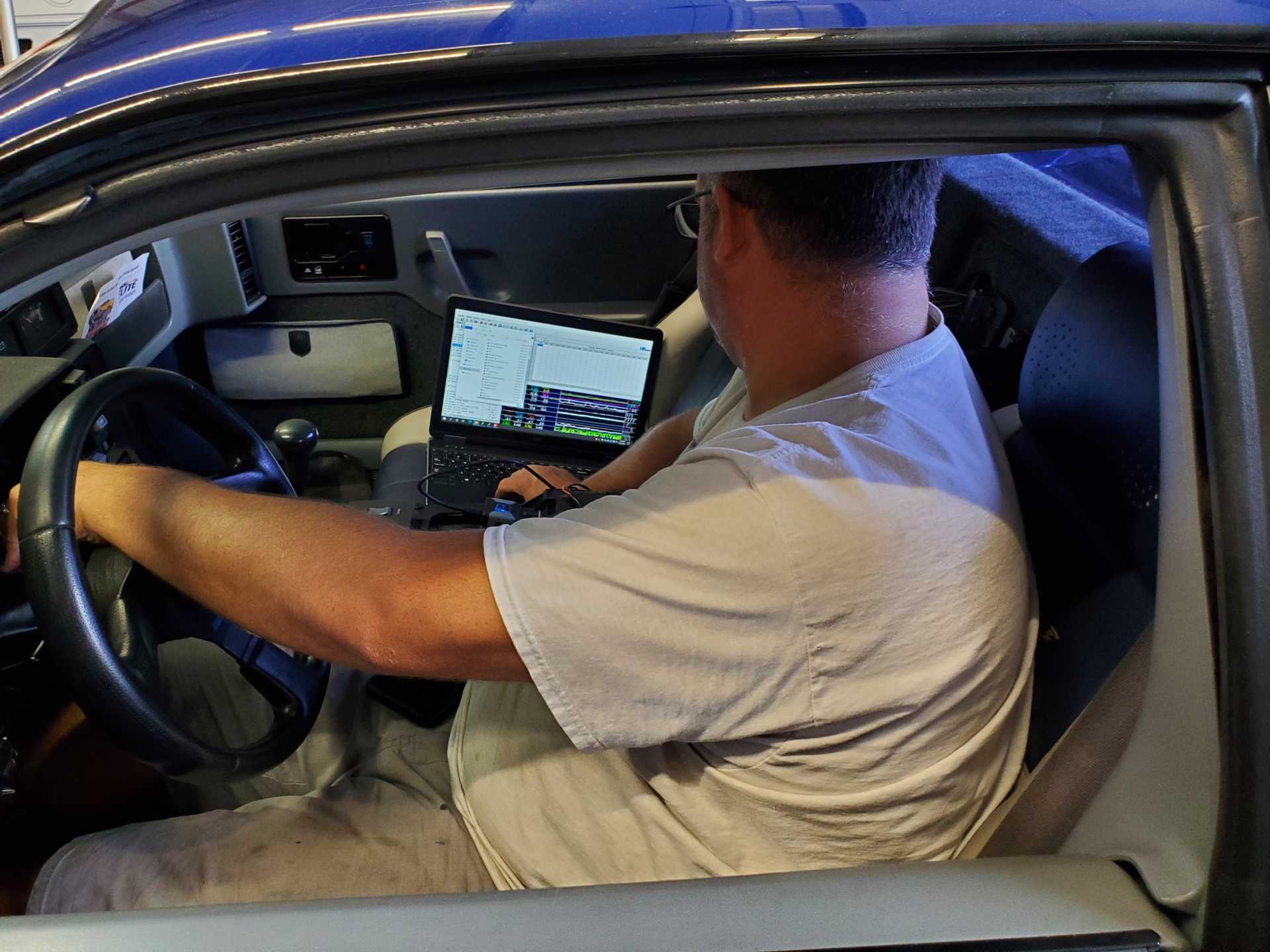

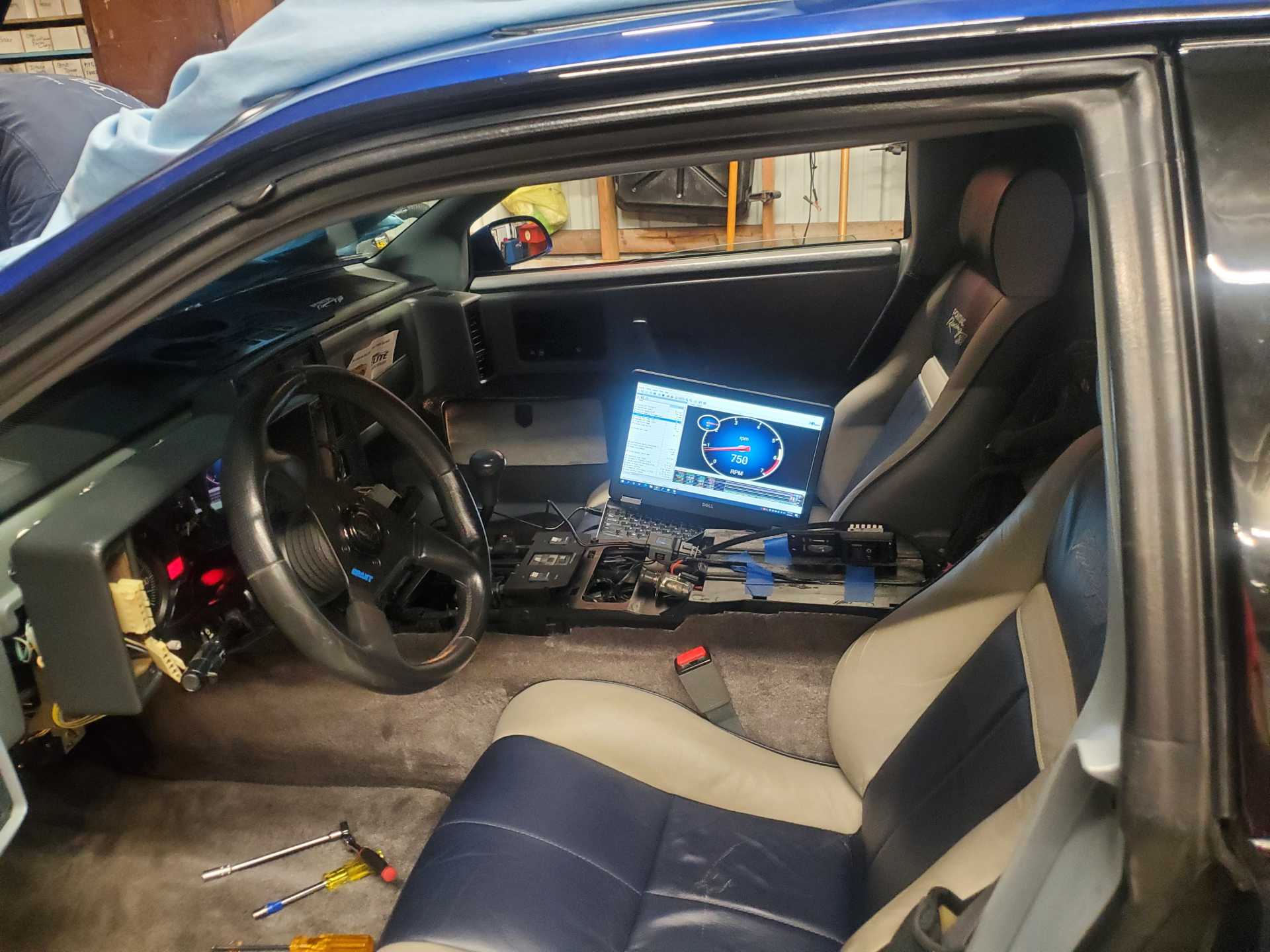

It was actually 3 weeks until the tuning appointment times matched up for Matt and James (I had first thought we had it set for the following weekend but we had a lot of other things happening during the time in-between). James charges $300 for a base tune/driveability session and while the time range can vary, it was estimated to take up to 3 hours. If you do not have your own HP tuners dongle, there might be an additional charge but we had the dongle and Matt had done some experimentation as we prepared for the actual tune.
For the tune to happen, James and Matt connected via remote software that allowed James to control the software and grab the data logs from Matt's computer. While there are likely other options, this was the fastest and most efficient way for James and Matt to work together on my car. In typical Blue Demon fashion, the weather threatened to derail the session but fortunately, things began to clear up in time for the driveability tunes. The tuning process itself involves driving the car and creating data logs that James then examined, made tweaks to and applied to the car. As is typical in our house, a million things were happening simultaneously and I didn't realize until I heard it going out the driveway that the car had left the property for the first time under its own power:
Drives 1 & 2 went well and James quickly made fuel adjustments that helped tackle the car's desire to run rich.

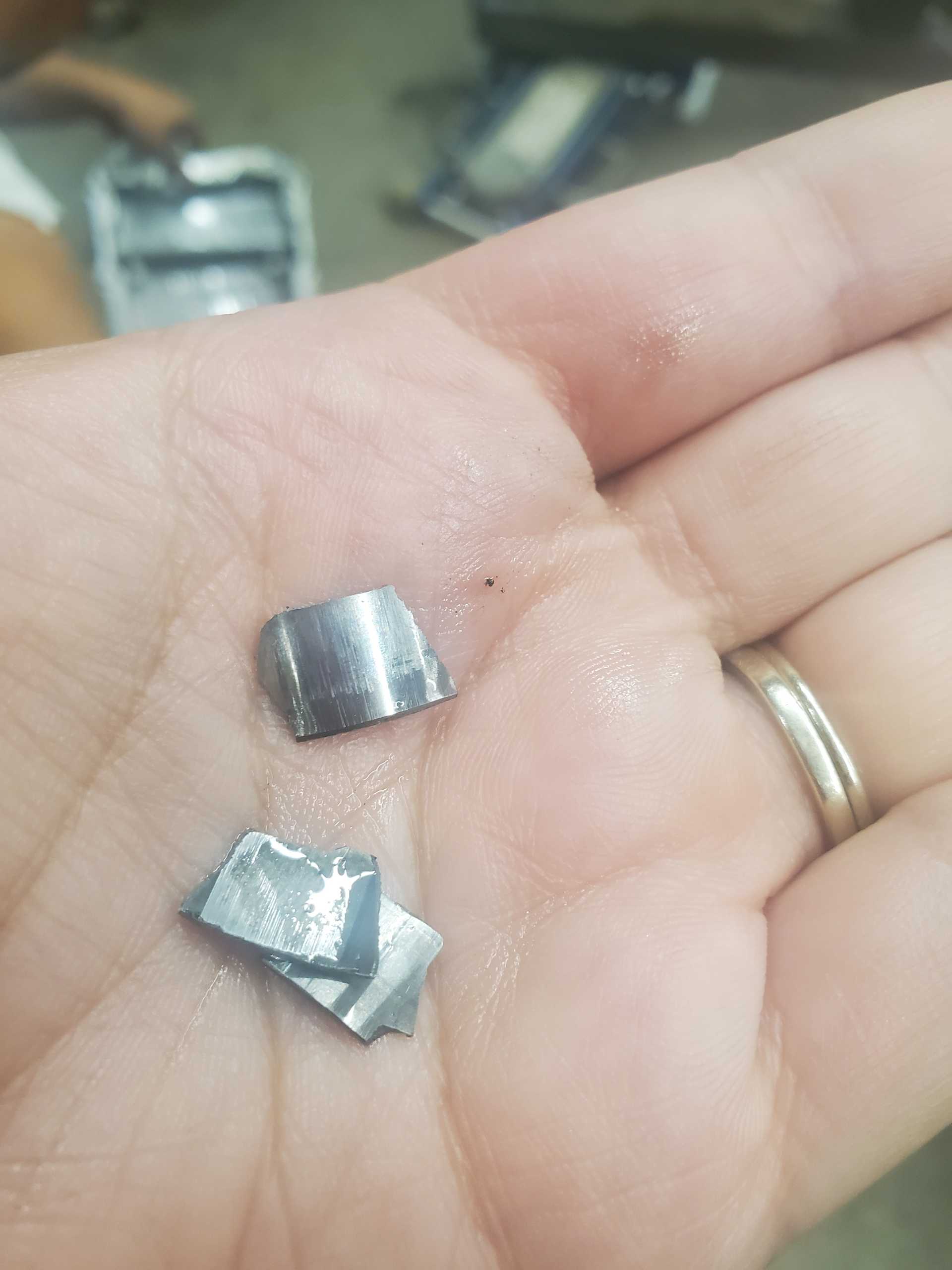

In true Blue Demon fashion, the tuning was not able to be completed that day. Prior to the WOT run, Matt's best friend came over and wanted to hear the car run. This time, on start-up, the whine appeared and it became very evident to Matt that something was going on with the lifters. He called James and asked to reschedule and then broke the news to me. I was heartbroken to hear that the engine needed to come out and the top end, at the very least would need to be torn off. With about 11 days until our departure for Fierorama, I was beginning to doubt if the car would make it.

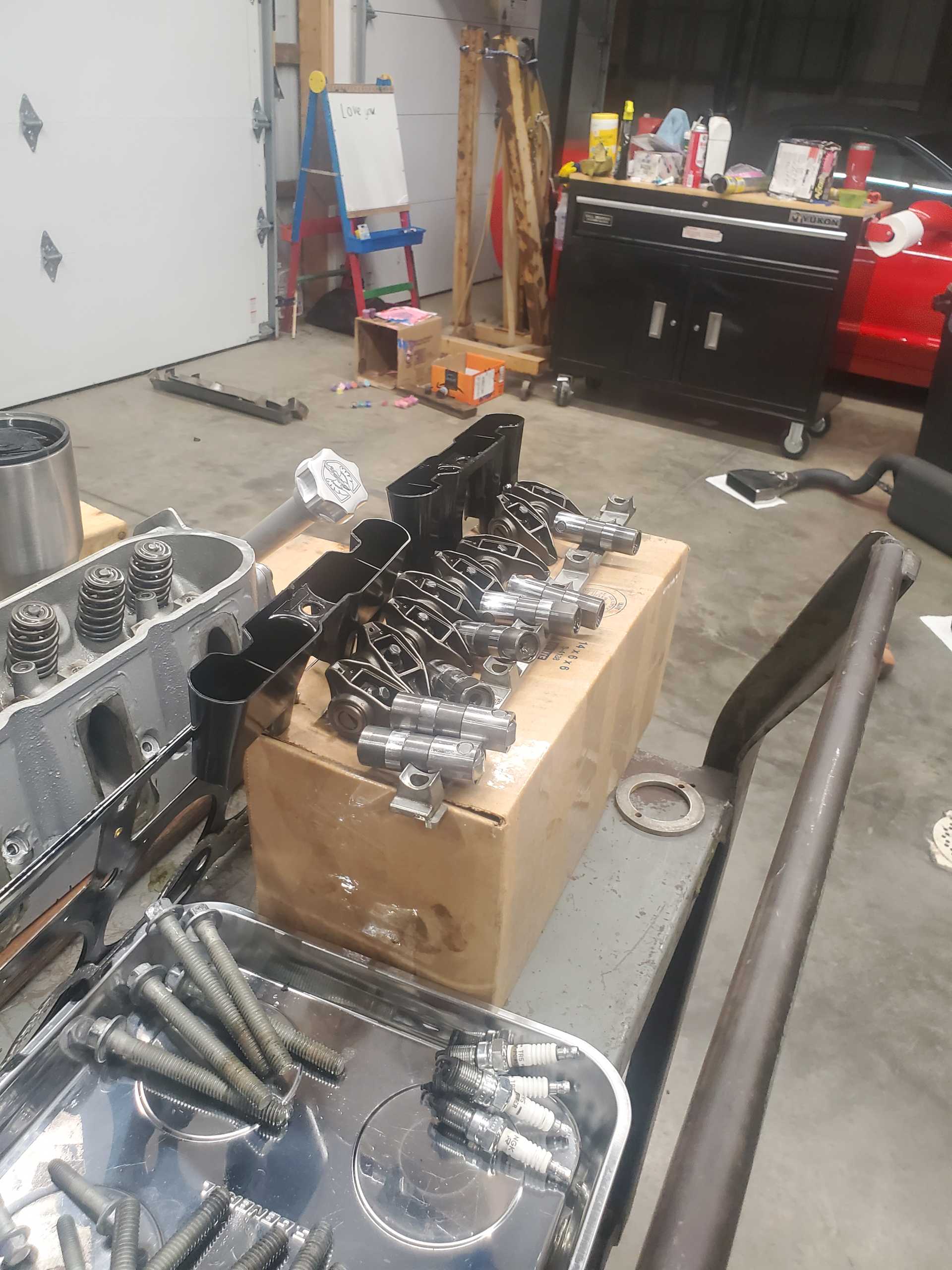

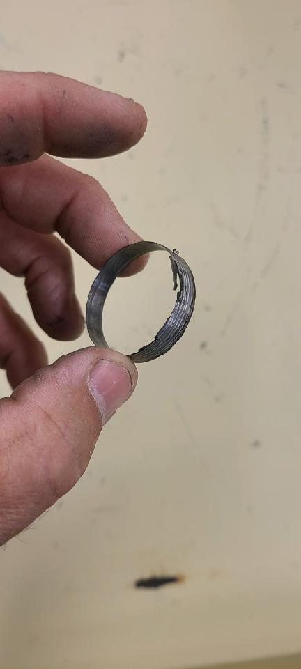

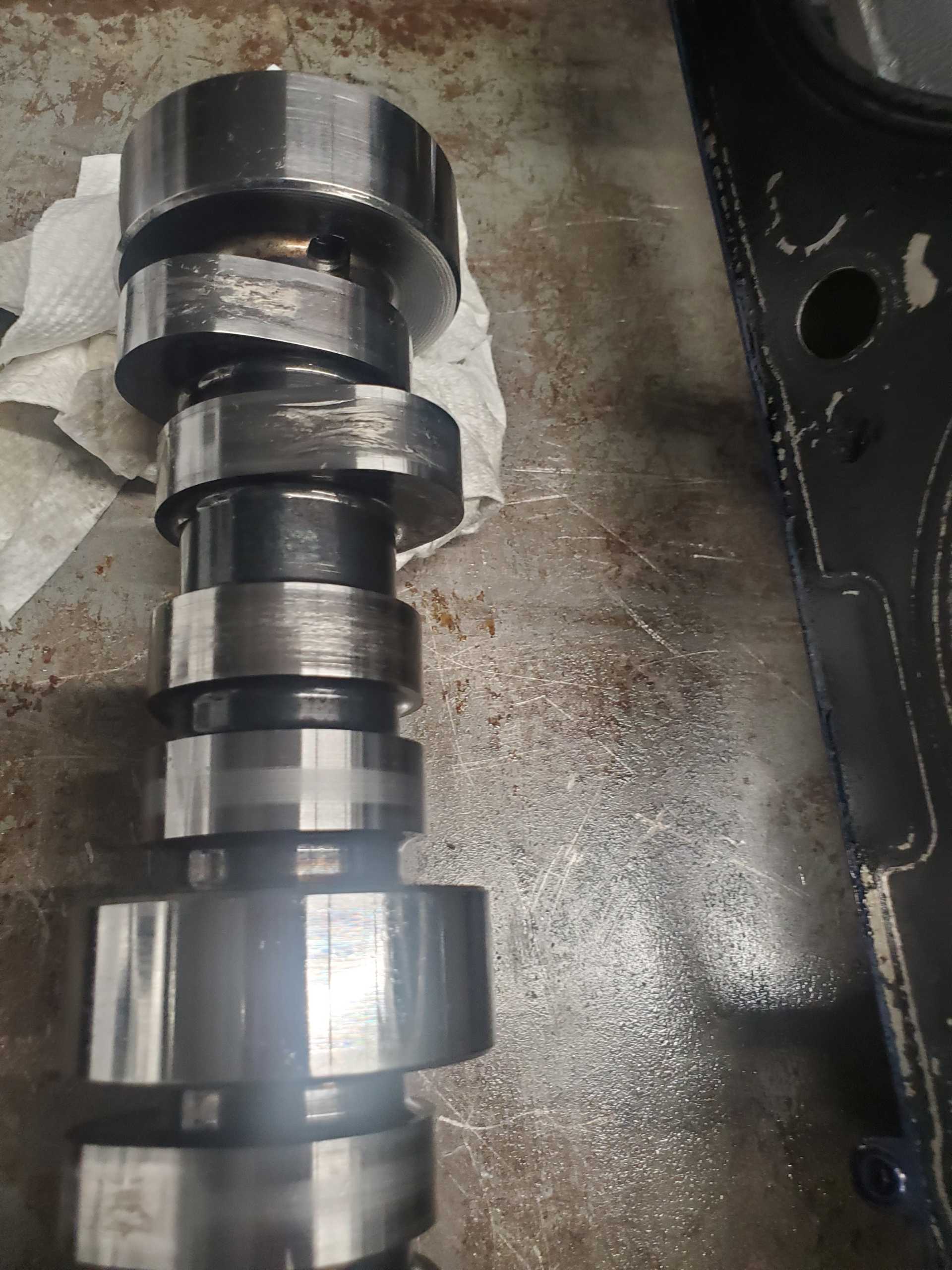

The following day, Matt was able to reinstall the SD4 in the Indy and drop the engine from the Blue Demon and begin to tear it down. It soon became evident what the problem was - the lifters had started self-destructing because they had "spun" in their lifter trays. Something like this should never happen but it quickly became evident that it had. The initial cause of this occurrence was not apparent but the damage certainly was:
As Matt examined the lifter trays, they seemed to be a bit "spongy" and had more wiggle room than they should have. We soon learned that while Delco trays had been ordered, aftermarket trays actually arrived and due to the tight time frame we were on pre-Carlisle, it was decided to just go with them - no one thinking that this was even a possibility. Fortunately, Gary had a set of Delco lifter trays, spare lifters, another cam and the other necessary pieces parts to get the car going again. In the midst of Hurricane Ida that Wednesday, I drove out to meet Gary & Jenn halfway to grab the parts, hopeful that Matt (who was on a "hurricane day" from work) would not find any further damage as he dropped the pan and began to clean out the block.

Still a new problem had emerged. The cam was larger than the initial cam. Cam #2 was a Texas Speed LS1 Cam (228/228 .600/600 110), and the accompanying valves had dual coil springs and we did not have the proper valve guide seals to pair with them. Thankfully, a Friday delivery was possible which would be the next day Matt had off work and the same day the new gaskets were set for delivery.
Matt worked his magic and soon everything was back together and able to be reinstalled in the car:

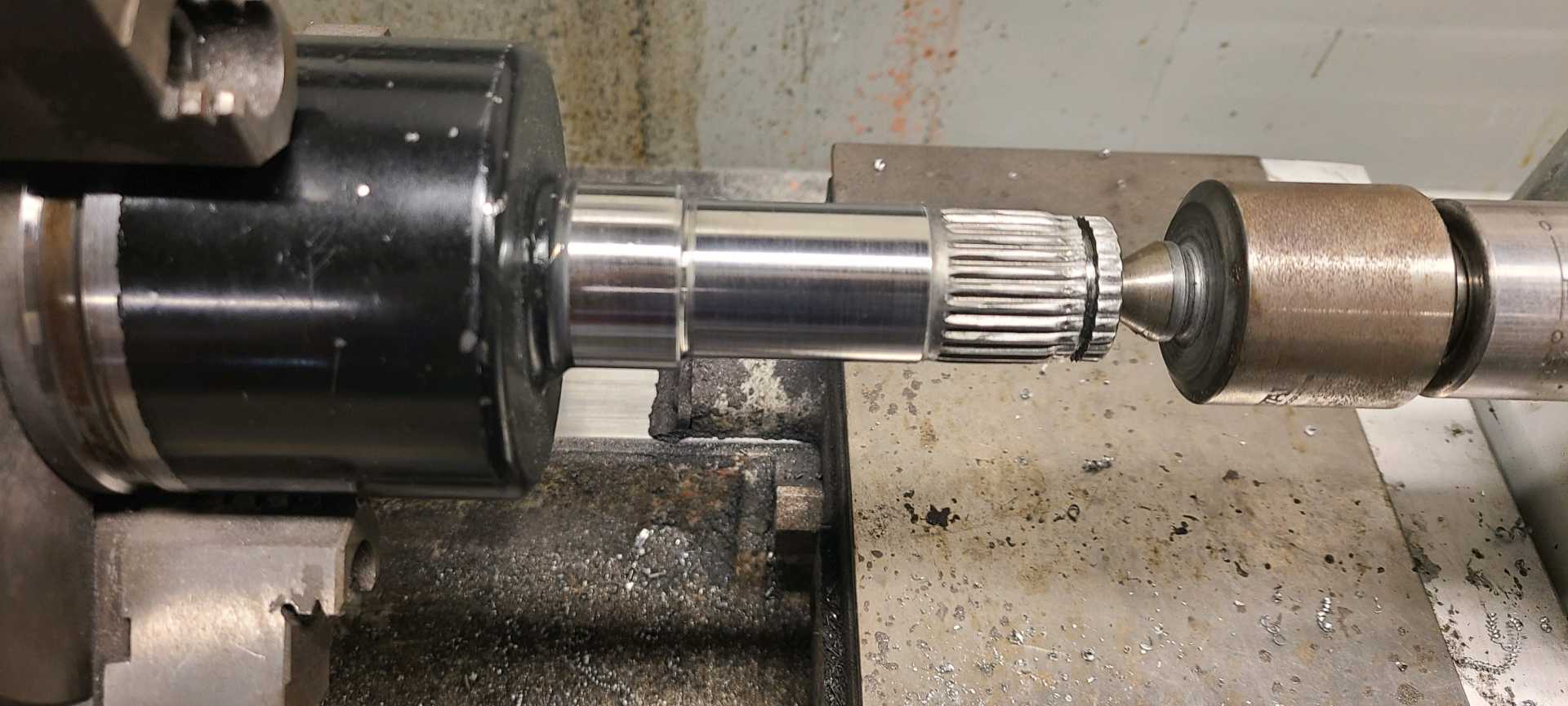

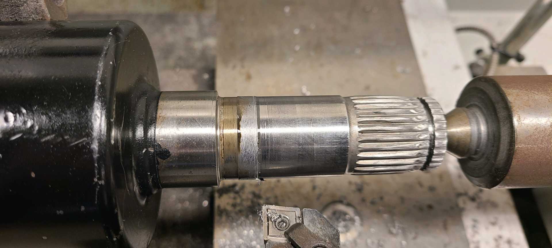

The next night as I arrived home from cheer practice, the tire and wheel well were off and the axle was separated from the transmission (which it had, of course, done by itself the night before). That was the "good" news. The bad news was that the axle had de-splined and there was no easy fix as it was custom machined to fit the tulip of the F40.
Matt had set about filing it in an attempt to ease the damage and get it back together to make it to St. Charles. He was frustrated and not entirely optimistic as he had discovered that it had popped out because it was never properly seated in the first place. Somehow, amid all the other insanity, none of us realized that the aftermarket axle had a bushing that was preventing it from seating properly. (Note: This is why you never rush when doing these projects - and honestly, avoid aftermarket parts if possible!)
Matt's "Hail Mary" was abetted by his access to a lathe at work. He managed to take the axle in, machine off enough for it to hopefully work and then swing home on his lunch break to doublecheck. I was not home that day and anxiously texted Gary to see if he had heard from Matt as I was afraid since I did not hear anything myself.
Fortunately, in the end, he was able to work his magic and that night, we loaded up for our departure for St. Charles.

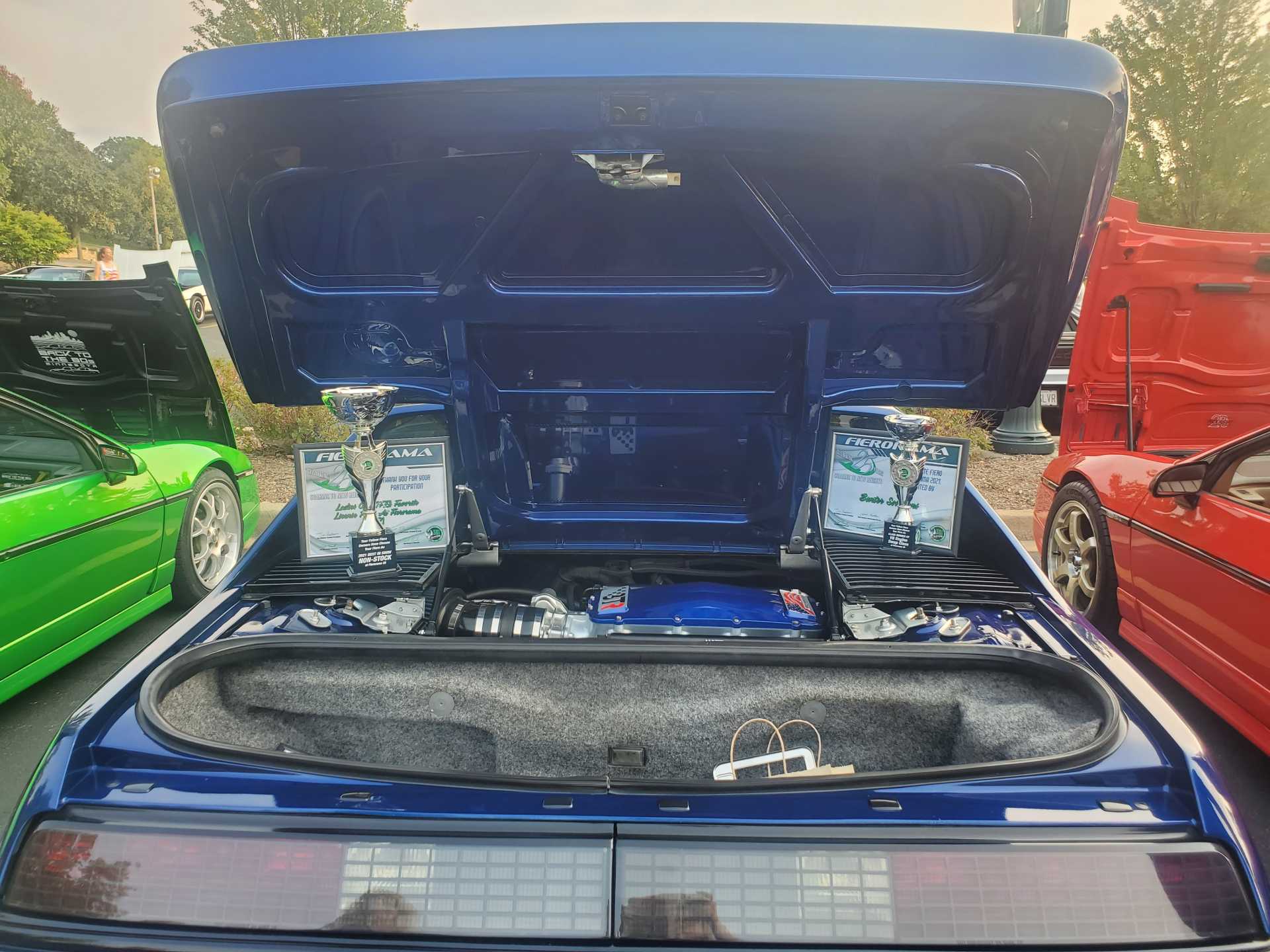

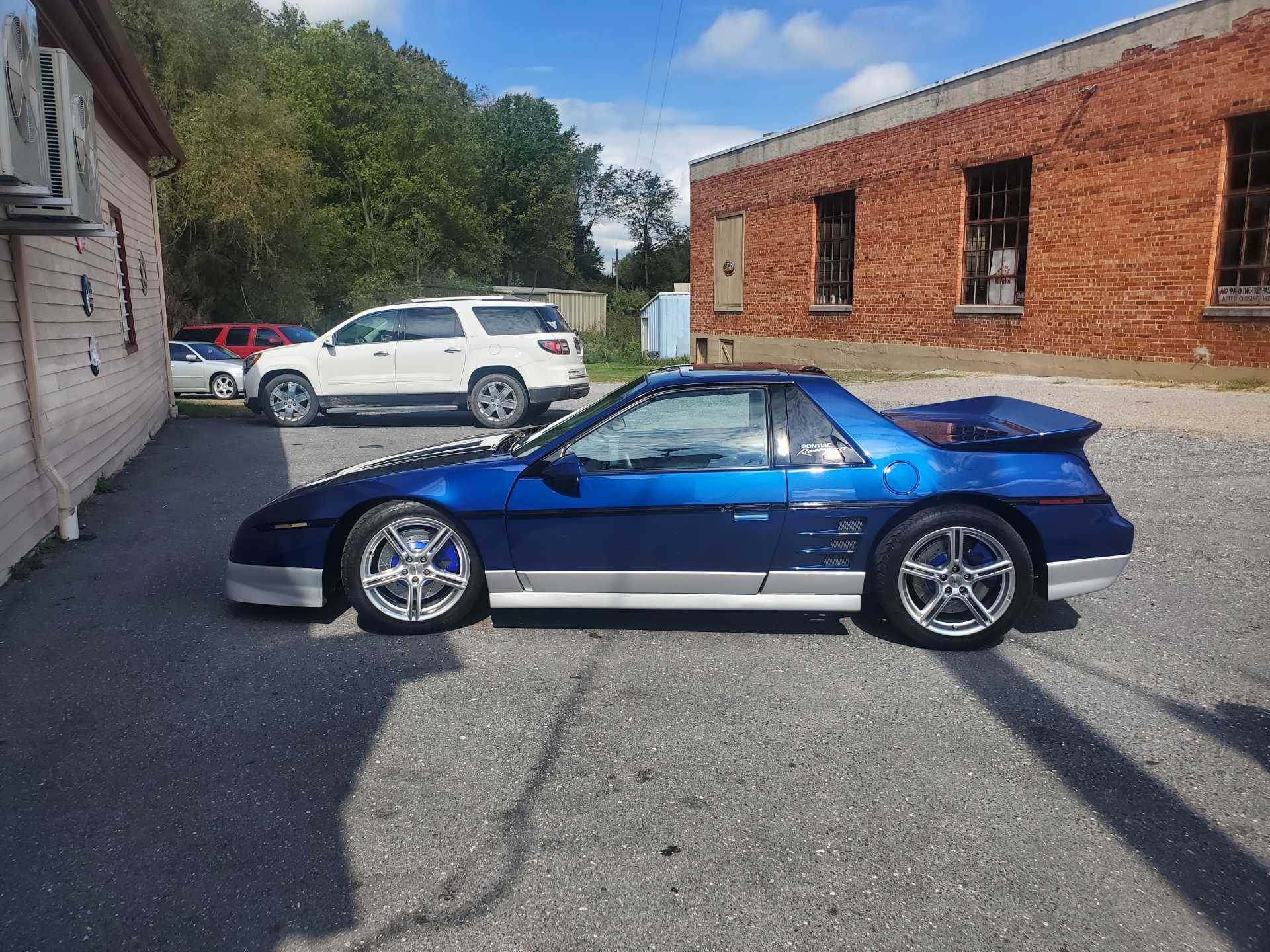

Our trip out to St. Charles was uneventful, meeting up en route with the Pickardts and picking up Wayne Geib too. We arrived Friday night and while we planned to drive the car to the cruise-in, some last minute confusion and need to arrange a tow for a fellow Fiero owner resulted in my test drive being postponed.
The following day, as Matt and the rest of the crew played "garage" on a few different issues for a few different cars, Gary and I jumped in the Blue Demon to take it for a spin around the neighborhood! It was definitely an experience!! I didn't get much above 45 mph and 3rd gear in the neighborhood we were in; however, Gary can definitely attest that I was smiling ear to ear. The clutch is taking some getting used to and we plan to install the RAM hydraulic clutch adjuster kit to change the throw (it grabs a little late for my tastes personally). We also need to fix the AC compressor squeak and have ordered the appropriate kit, but that will likely get attended to in the next few weeks.
The car was a hit at Fierorama, capturing Best in Class (V8) and Best in Show - Non Stock Fiero, as well as Bonter Solutions Favorite Fiero and Best License Plate. We had a blast and were also excited to celebrate Jestin as the co-winner of the Best in the Midwest: Fieros Owned by Kids Younger than Their Cars along with Jon Revelle and his beautiful Formula.
