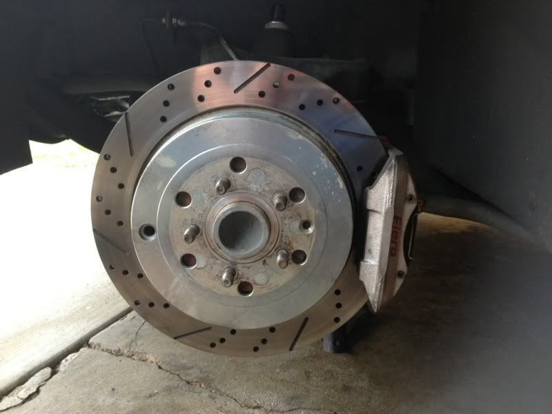

And a shot of my 13" brakes by fieroguru!
