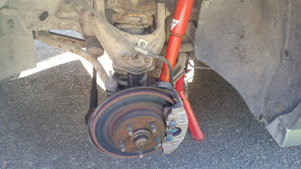

..After that I removed the front wheels.. because I got the wrong ones last time, so now I going to buy new tyres for the 9-5 aero and he going to replace thre fiero tyres at the same time..
Looked at the front brake rotors, very impressive they look so good on a car that have been standing for 15 years.. before they had rust but now after driving the car they look nice and shiny.

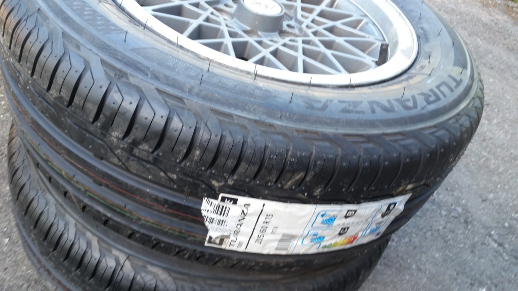

Repulsiv JUN 30, 12:22 PM
Now I have brand new bridgestone turanza tyres on the front wheels, yay!
