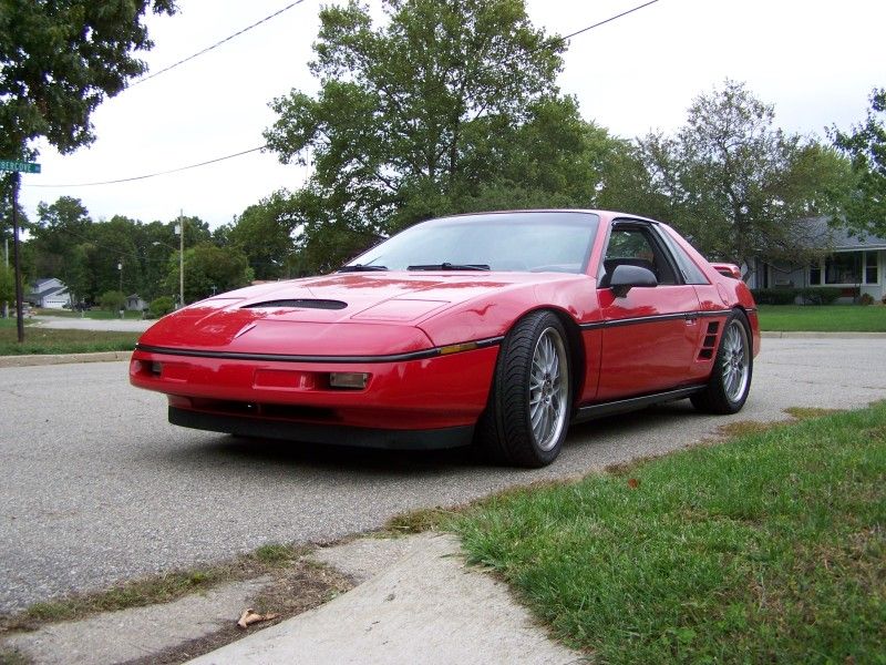

Mounts are good. Drives better and I don't get nervous on a hard launch. The charge air cooler seems to be working good too. I've been in contact with Ryan at Sinister Performance about getting it tuned. I might wait until spring to get that done. Got to save some $$. The money is going other places right now.

It was worth it. Once it's tuned it will be well worth it.

Today I replaced the leaking axle seals and repaired a ground that had come loose. I checked all the fluids while I was at it. I also installed new front LED turn signal bulbs. Won't be long and it will be parked for the winter.

Spent some time today modifying the rear engine mount. The engine does not move and does not need a dogbone now.
