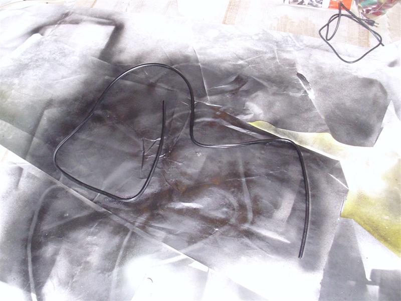

The trim strip that goes around the sunroof has been cleaned and dyed ready to reinstall

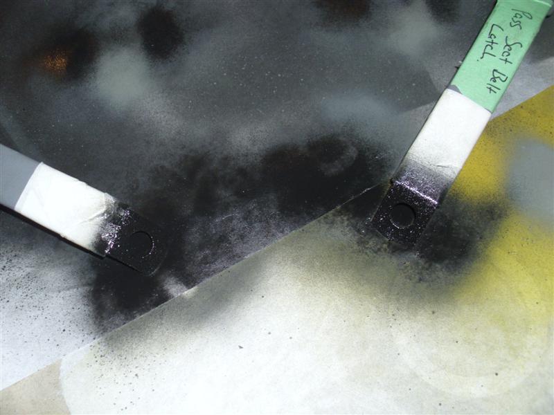

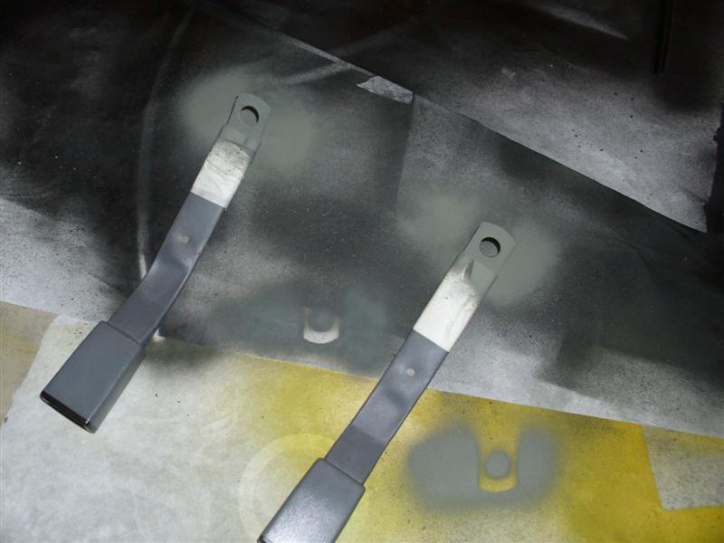

Kathryn cleaned up the anchor belts for the seatbelts, they were a bit rusted down by the attachment points. The vinyl will still need dyed etc. but at least they are on the way. Kathryn cleaned them up with the wire wheel then primed than and got the first coat of paint on the anchor points.

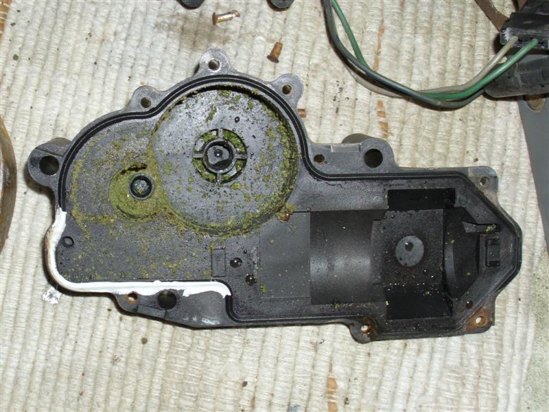

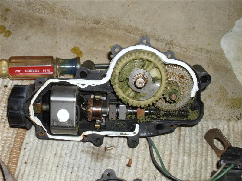

We also got the headlight motor apart, and surprise, surprise, the bumpers were all disintegrated into dust. We need finish getting it apart and cleaned up then back together. We have the rebuild kit so are all set there, but it looks like we will need new motor brushes...anyone have an idea of where we could find them?

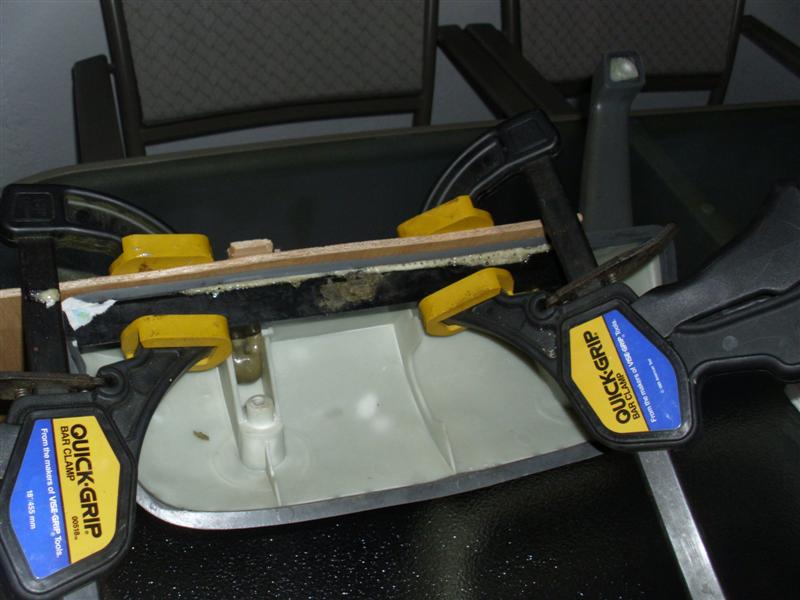

We also managed to get the new armrests cleaned up....glued and clamped. They should be ready to be dyed tomorrow.

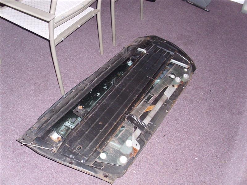

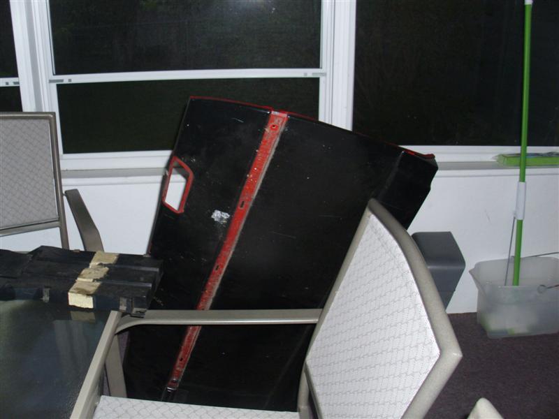

Finally, we started to get the door apart further. New switch gear, lock solenoids, and window motors to go in, as well as outside dew wipes, and a new door skin.
.JPG)
.JPG)
Now that we are getting into the more mechanical aspects the learning curve steepens for both Kathryn and Dad, but we continue to make progress and that is the main thing.

So far this project is great. As far as the learning curve, I will give you some simple advice since you have the doors torn apart. Definately change the window slider pads in the door. They stabilize the glass when it goes up and down. If the felt is worn, that is why the glass gets scratches in it. Also, here is a really obvious part that is often overlooked. On the outside of the door is an adjustable stop-screw that allows the door skin to be mounted correctly and then the skin is screwed on to the car via this part. Make sure the stop-screw is not unscrewed too much....even from the factory....or your door skin will buldge in the middle:

If you've never had a headlight motor apart, a word of advice. Note the white spot on the motor windings. Mark the side of the motor case that white spot goes into and leave the white silicone spot there for reference. If you should pull the motor completely out of both case halves and put it back, turned the other way, the motor will run backwards. I made the mistake on one and when I turned them on, one came up and the other went down. Turned them off and they reversed positions. No fun to have to go back and do them over again.
