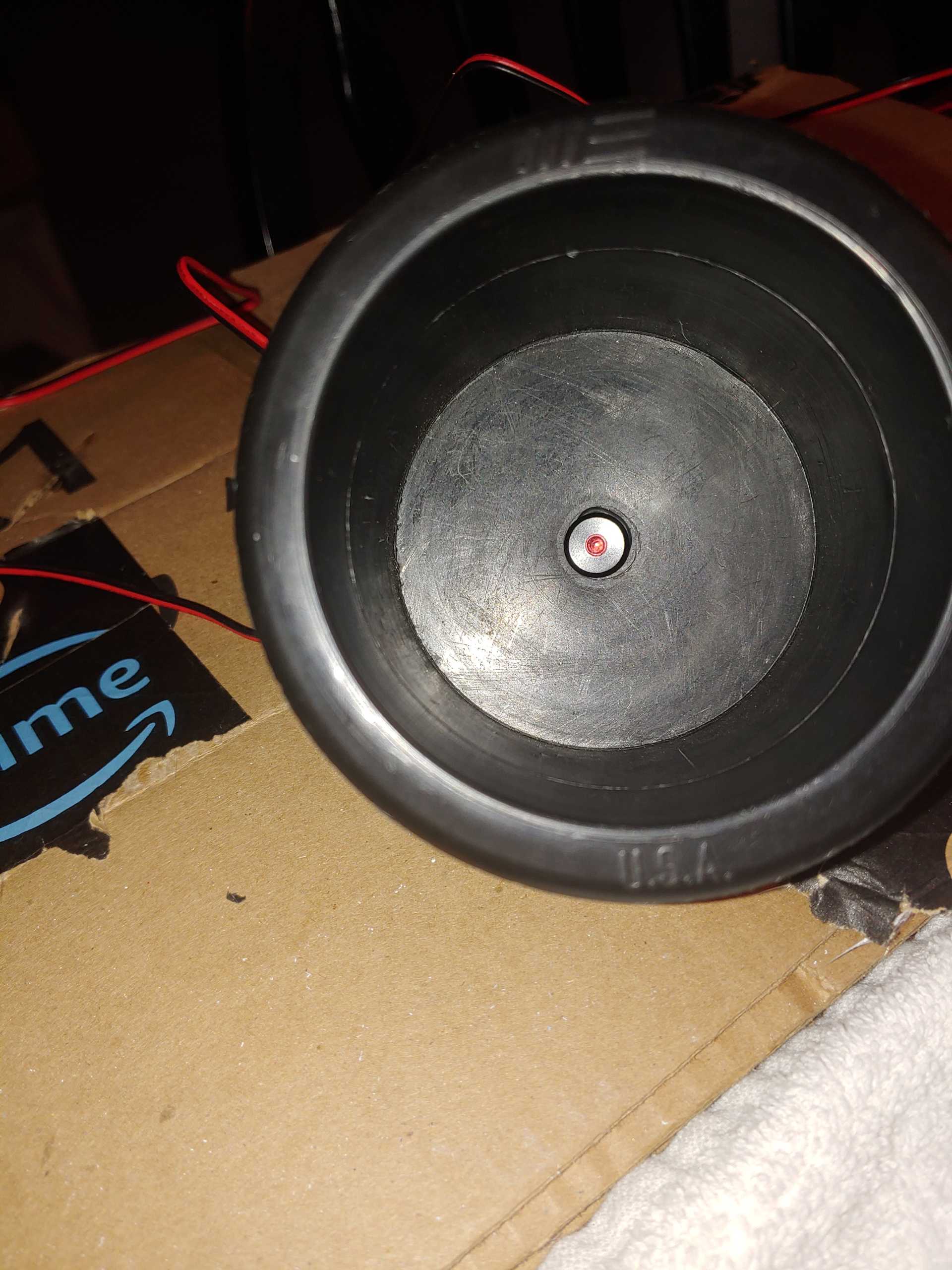

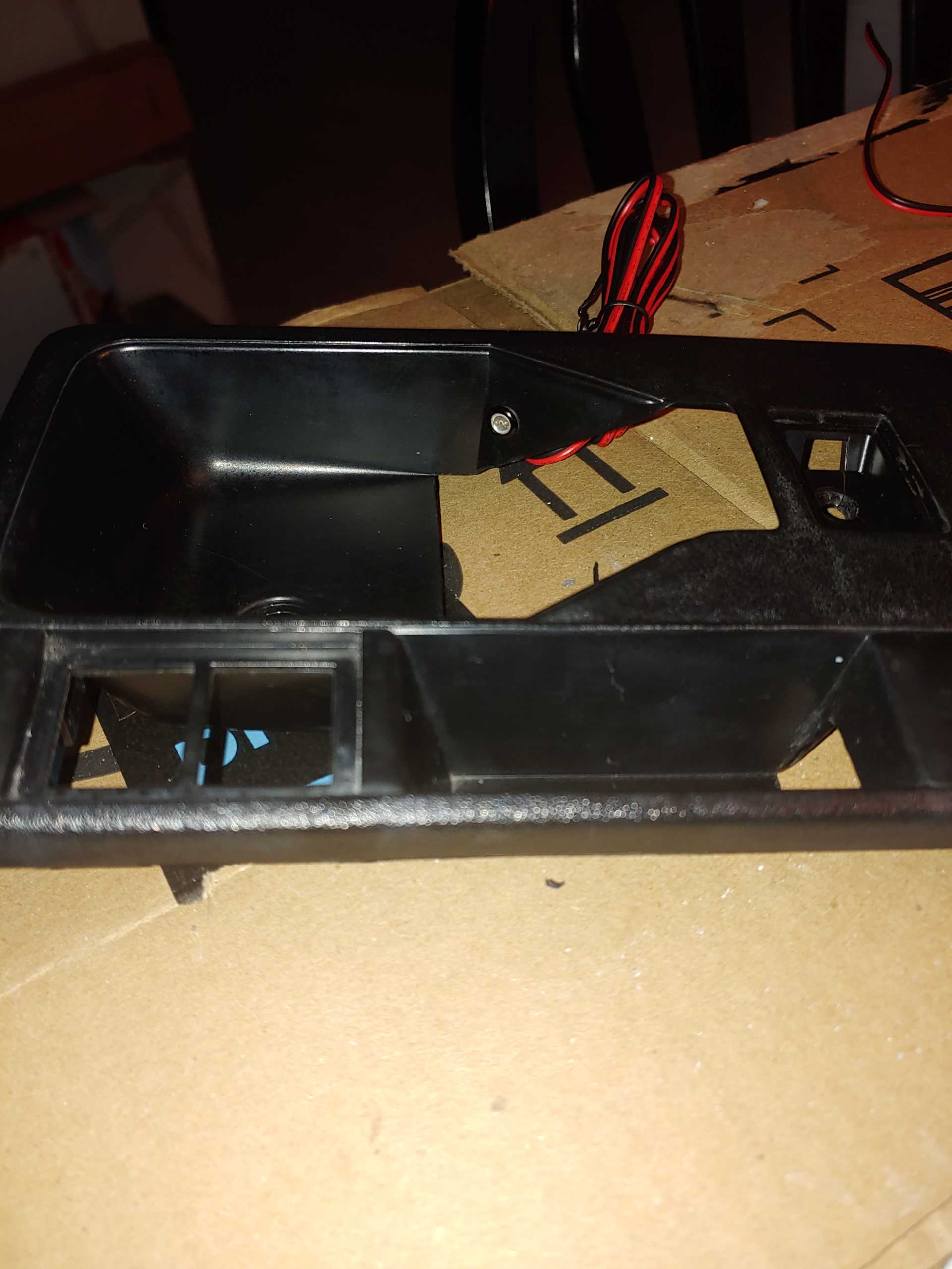

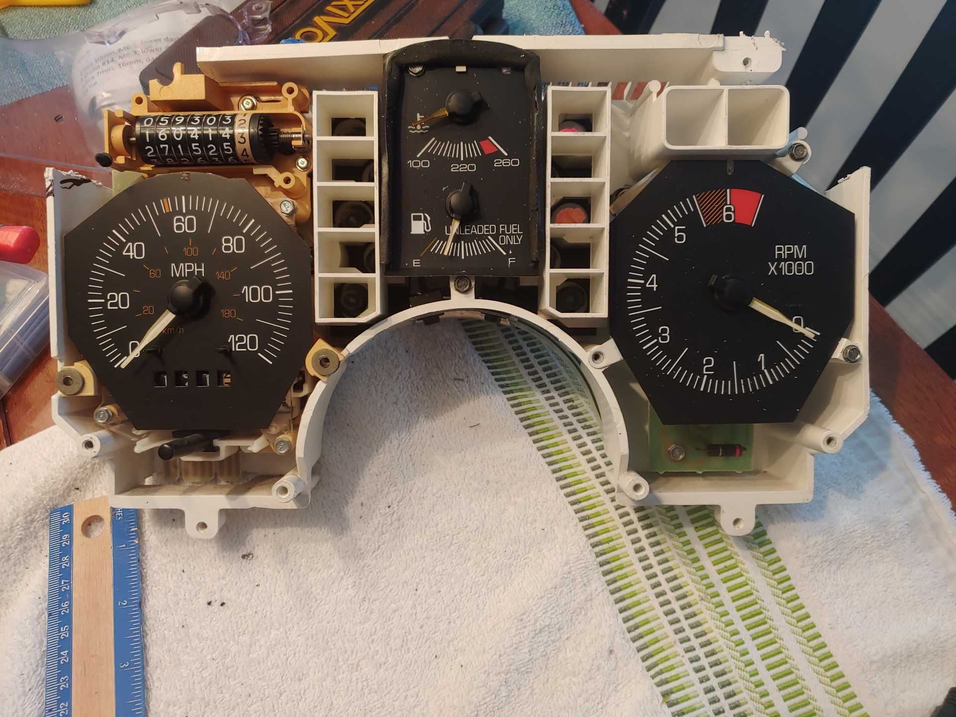

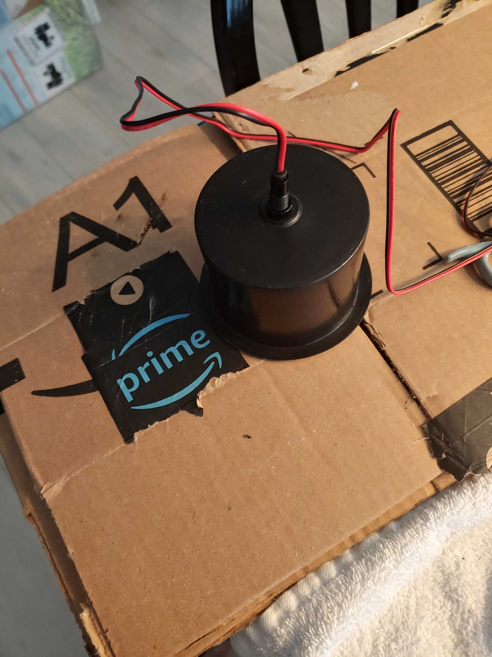

I started modifying the gauge cluster for the new dash.
I also started wiring up the ambient lighting.
