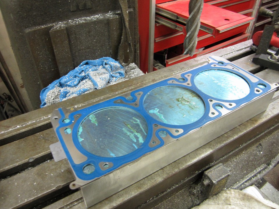

I need to bore my block to fit the LS pistons. This will require a torque plate to get the bores round. Engine machine shops around here don't have one for the 3.9, and to buy one for my self it looks like more than $500. too much for my blood.
I bought this 2 inch thick “tool plate aluminum” off ebay for under $70. Here I have milled the outside to size on my mill.
I did the drilling and boring after work, they have good machines. I only work 2 or 3 afternoon's a week. After work I get an hour or two to do my own stuff before everyone leaves and I have to clean up and leave also. I have to take my parts off the machine each time. That means the next time the machine is free after work I must set every thing up again, adding a lot of time to the job.

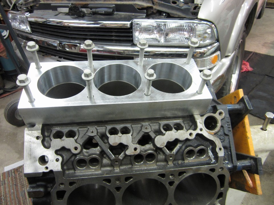

Checking it on the block. I will make aluminum spacers so I can use stock bolts at the stock torque. I ordered some tubing tonight for this.

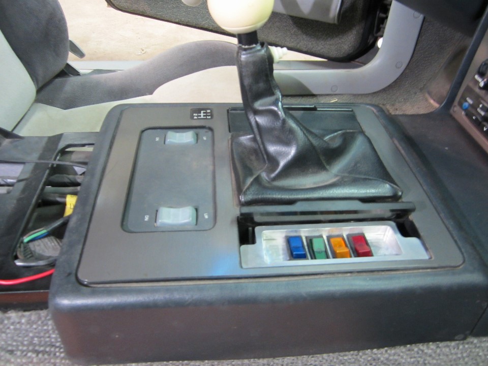

I have a box of switch trays that may be of interest to you.
“switch your ash tray for a tray with switches”
I last sold them in about 2004. I sold about 100 of them back then.
They are billet aluminum. You can put the ash tray cover down with the switches in place. That conceals them. You can add lights, or whatever, without drilling hole in your interior.
Some of the trays are blank. Some have a slot for 1 switch. Others have slots for 4 switches. I have my NOS arming switch in one.
I also have the switches. The special wire terminals that help things fit in the console. And I think I know where the print is to make more trays.
