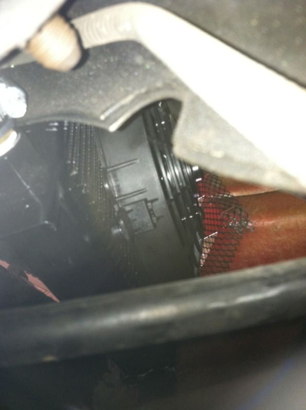

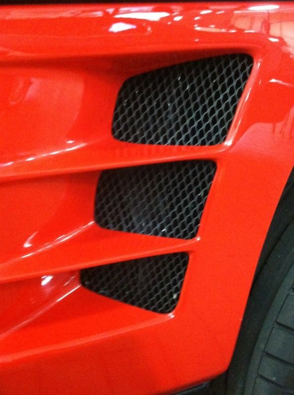

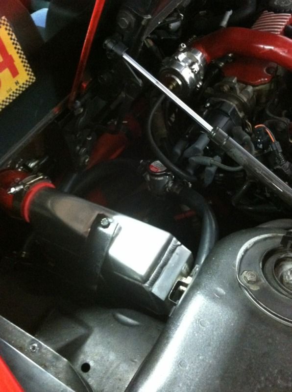

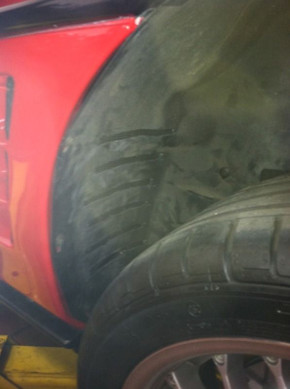

I got the W2A 99.9% complete today. I mounted the radiator behind the side scoop on the drivers side. I cut some slits in the plastic fender liner for air movement and have the fan mounted on the radiator so it can pull air in from the side scoop and out through the slits in the fender liner. If this setup doesn't seem to work good I will move the radiator up front and run lines back. I want to see how effective this is first. I mounted the pump behind the heat shield on the left side of the firewall. I ran the hoses from the pump to the radiator to the heat exchanger and installed the inline filler. I filled the system with fluid, wired up the pump and started the car. Everything is working great with no leaks. I still need to wire the small fan on the radiator for the w2a setup, I ran out of time at work. Here are some crappy Iphone pictures:
Pump Mounted:
Plumbing ran:
