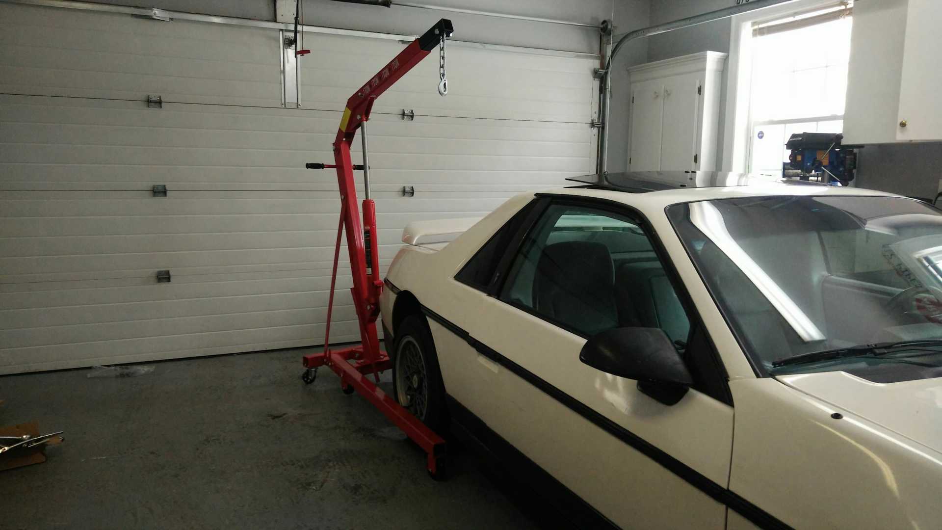

I picked this guy up on sale so that I could safely get my engine out of the car and into my truck to bring it home. This is a necessary first step of an engine swap.
