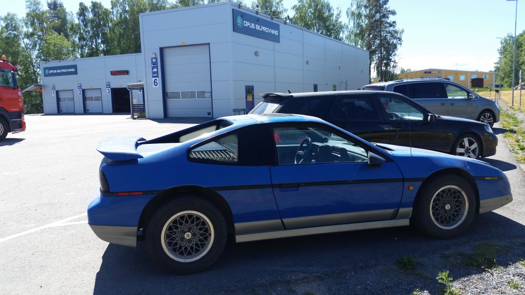

Today was Besiktning-day
.jpg)
First of all, the car worked when I drove there, this is really the first time I have driven the car except my short testdrive before winter, and the 50m drive yesterday.
On the way there I noticed the brakes where pretty bad, but after a few times hard braking it started to be ok, I also noted vibration is the steering wheel, not extremlyn much but it feels like unbalanced wheels.. however, they was baklanced when I bought the tyres.. ..I also noticed that the suspension is VERY hard, but I guess that is as it should be since the car have koni dampers and other springs.
Another thing i noteced was that the car didnt "roll out" as it should, you know when you are going to stop and push the clutch and the car stop faster than it should, usally because some brakes is on.. so when i got there I felt all wheels if they whrere hot, and they where not.
Anyway, the guy doing the inspection was a really nice guy (not all of them are) that liked the car and also had a lot of knowledge about american cars, for exemple he knew how both the belts and the parking brake worked ..Th steering wheel lock he didnt know, so I had to show him.
The first thing he did was checking the headlights.. and what happened ? the right one REFUSED to go up ?? I have troed it many times and never had any problems.. but NOW it didnt ocourse ..he measured the left one and it was ok.. but the right one got a "not in function" remark. He also checked every other light and electronics, but everything worked (I have spent so much time on that..) and then checked the frame, suspension, steering and everything under the car, no problems, he said the frame looked rusty, but was in very good condition. (he asked if the car had been in a garage)
Then it was time for the brakes.. first he lifted the car and rolled the rear wheels, no problem.. then the front.. not very good, he had a very hard time turning them by hand ..then away to the brakeforce-tester, rear was perfect, front was perfect too (even and enough brakeforce), however the fact that the brakes where on all the time made it a failure.
Then it was the exhaust test.. he laughed a little and said that this car dont have much regulations to pass, the only thing he maesured was CO, ant it was 0.8, the limit is 3.5 he said "Well, its the same limit as old american cars with V8 and carburettors have, and you have a small engine and fuel injection.."
So I got two points to fix, the front brakes, and right popup light, anyone know what it can be ? ..if I open the hood it actually lift it up, but I can stop it easy with my hand, I cannot stop the left one.. any friction clutch ?
Then I drove home, and when I was close to home I felt the smell of hot brakes.. when I stopped the car the front wheels where so hot I couldnt touch them
I know my dad had a similar problem when he bought the car, then two shops couldnt fix it, finelly he found some "expert on american cars" that found the problem, back then the problem was the brake hoses, he swapped them and then it worked.. not sure if that is the case now, I will disassemble and clean the brakes first anyway.. If that doesnt work I continue to look for problems.. maybe the hoses..
