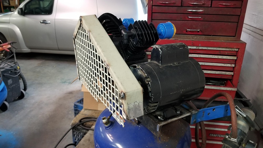

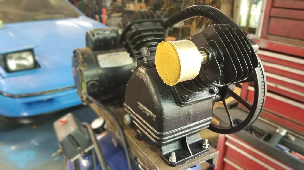

Finally rebuilt my air compressor. I bought a two-cylinder replacement pump from Home Depot and then had to fab a new mounting plate.

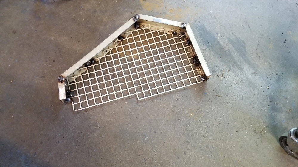

Since the replacement pump came with no air filters, I had to get creative. I welded a big washer to a short section of threaded pipe, then riveted a cat food can to the washer and used a punch to open up the center hole. The filter material is foam rubber cut from an old seat cushion.
Also had to fab a guard, since the replacement pump is belt driven instead of direct drive like the one it replaced. I don't remember where I got this 1" square steel mesh. I have three or four sheets of it, 2' x 5', and the stuff was perfect for this.
I test fit it and ran the compressor to make sure nothing rubbed.
For the feed line from the pump to the tank, I first tried bending some 3/8" steel brake line, but because the fitting on the tank has some odd-sized threads I had to use a series of adapters so the brake line wouldn't fit. That sent me on a journey to find some hydraulic hose, which finally landed me at a place in Tulsa that makes braided steel line to order while you wait. The braided steel line is great because it can take the heat from the compressor with no problem.
I've since painted the top half of the unit, including the guard, and added two handles that double as a place to coil the hose. Most importantly, it works and it's much quieter than the factory setup was.

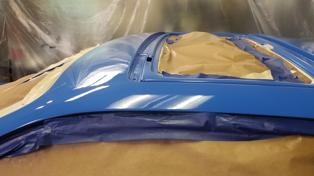

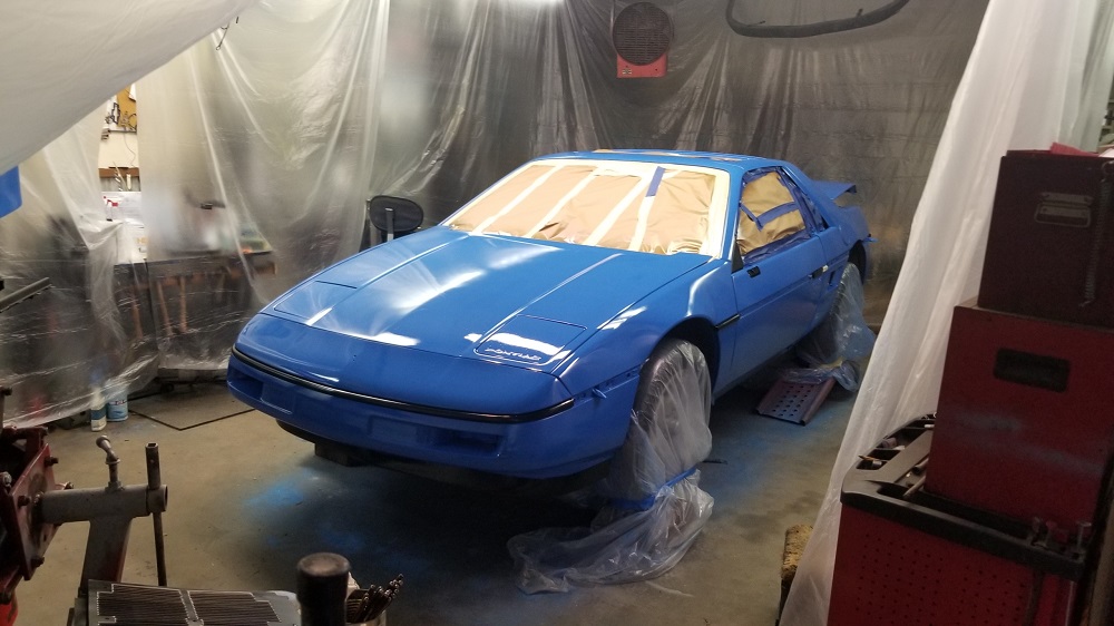

I finally got some time to prep and clear coat the car. Wish I could have done it during the winter or early spring, because summer in Oklahoma and spraying a car in an un-air conditioned shop do NOT mix.
I sprayed one coat on Sunday, then a second coat last night, because the can says to wait at least 6 hours between coats. I'm very happy with the results. I did get some orange peel on parts of the car, but it's much less noticeable than orange peel in the color coat was.
More than 50% of the car came out glassy smooth (with some minor imperfections). The instructions on the can say I can sand and buff the clear, but I have to wait 14 days. One good thing about the heat we're having now, it should help the clear cure completely.
Painting a car in a garage in the summer in Oklahoma has many drawbacks, not least of which is the uninvited guests.
I used Majic clear coat that I found at Tractor Supply. I decided to use it after reading the guidelines on the company site. I figure if it's tough enough for farm equipment it's tough enough for a Fiero. It's ready to spray right out of the gallon can, too.
https://www.tractorsupply.c...s-laquer-clear-1-gal
I read somewhere that overspray is much worse with clear than it is with color and I confirmed that. This stuff made a thick cloud that took a long time to dissipate. I was glad I went to the trouble to hang plastic again. This time around I used a box of clingy drop cloths. They're made to be ripped off one at a time, but I left them attached to make a solid wall all the way around the car.
The downside was that while applying the first coat, the plastic came in contact with parts of the car. The second coat eliminated most of those blemishes.

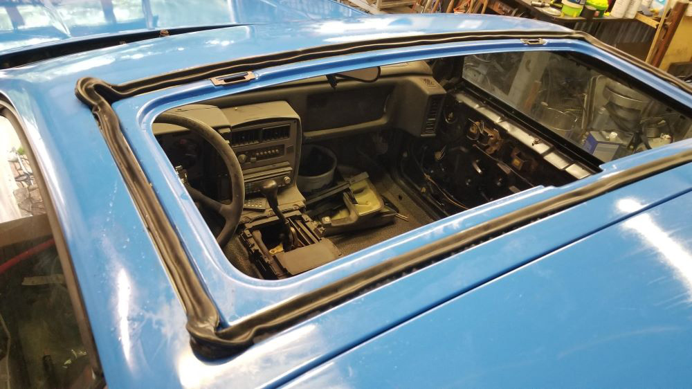

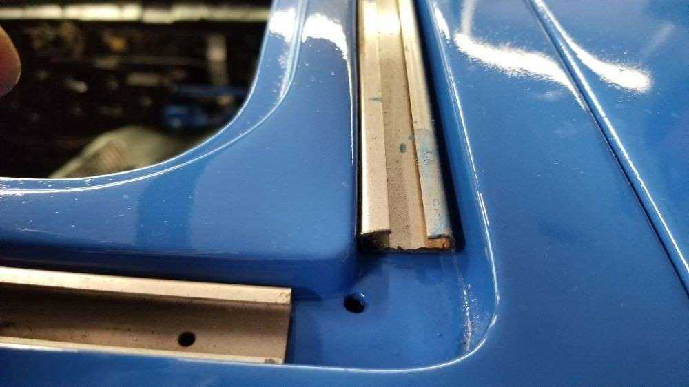

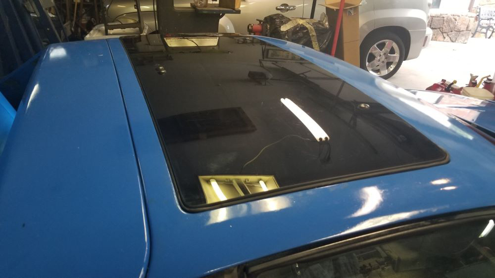

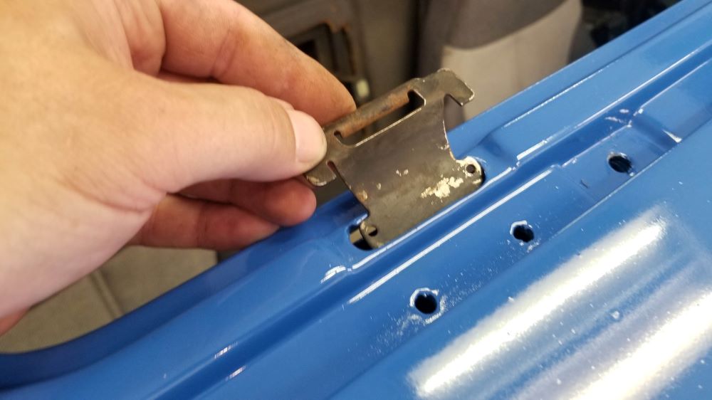

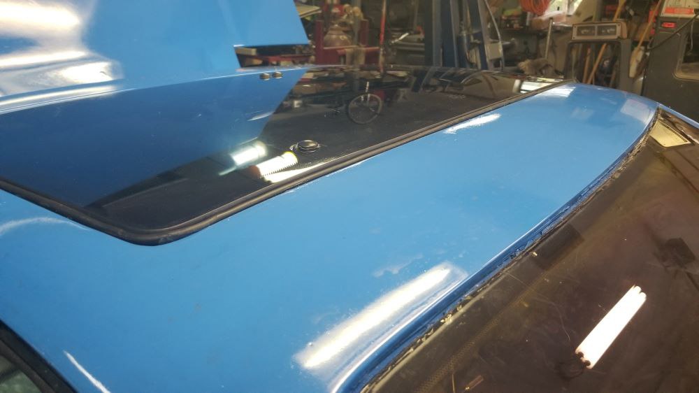

I've made significant progress over the last few months with the biggest accomplishment being the installation of the sunroof and hardware. In 2014 I ordered a set of stainless steel tracks from silver 85 sc. His kits are great because they come with all the rivets, washers and nuts required for the installation.
Tip: it's easier to install all the rivets if the roof panel isn't bolted down yet. I pried up the panel about two inches and could reach underneath it to hold the rivets while installed the track. I decided not to use all the rivets provided in the kit because I used sealant to glue the tracks to the roof panel.
The hardest part of the job was finding all the parts that I removed from the salvage yard cars, including the metal hinge clips.

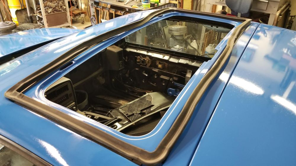

I bought a new seal from the Fiero Store. It had been in a box since 2014 and had a kink in it, so I clipped it to a wire and let it hang in the shop for a few days to try to straighten it out.
Getting the seal to fit inside the track was a challenge. Because I worked from one end to the other, I accidentally stretched the rubber so that the seal was too long for the track.
I pulled it out and started over, installing the edges first and working toward the center, being careful not to stretch the rubber. The final result looks pretty good.
