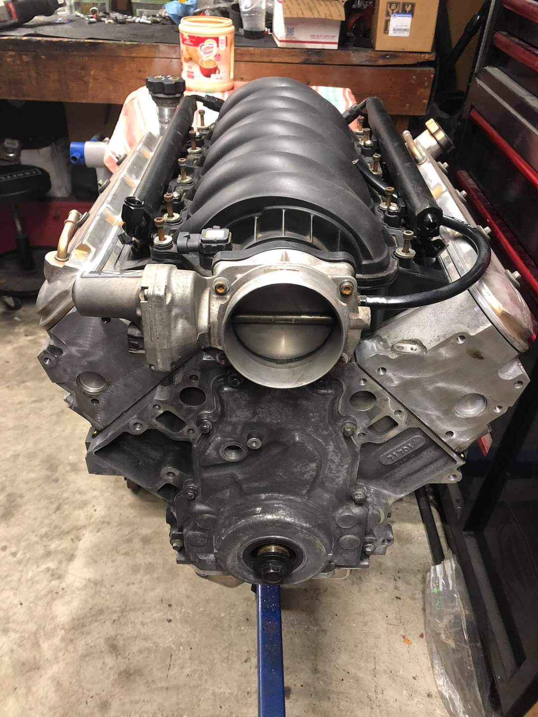

By early January, the initial engine build was coming together. There were 2 false starts on which engine we had planned to use. The castaways weren’t bad engines, but ultimately a better option for the project came along. The engine would ultimately come from a 2006 Impala whose short lifetime led to a low-mileage engine for this swap.
One of the first major decisions I had to make was what type of intake would go on this build. The initial inspiration, aka Gary’s car, had an LS2 intake with a GTO engine cover. This didn’t look bad to me; however, it didn’t quite fit the vision I had for the car. I spent quite a bit of time looking at engine covers and toyed with one that might fit the Pontiac Racing theme but still couldn’t settle on something I loved. I also had hoped we could relocate the coil packs and get blanked valve covers so covering them up did not seem necessary.
Another thought was the TSP Velocity intake but aesthetically (yes, yes, I know) this also did not really hold my attention.
While most of the world was glued to the television on January 6, I was on the phone with Gary making an important decision. He had recently come across Brian Tooley Racing’s mid-range Equalizer intake. This was an option that he had not previously paired with an LS4 and it had several appealing features including a cathedral-port style mid-rise intake for better airflow which translated to increased mid-range horsepower. While horsepower wasn’t the driving force of this build, who doesn’t like a little more umph? The intake also had some options for MAP placement that worked well for the build and aesthetically fit my vision more than the other options.
Matt and Gary kept me in the loop on other decisions, including the choice of the LSXceleration Stage 2.1 NSR Cam (218/227 .523/.523 HR112+3) which allowed for the use of the full 58x conversion paired with the E38 computer out of a 2008 Corvette. This setup is coupled with an LS2 timing chain cover. The LS2 Throttle Body was also brought in as part of the build. The galley was upgraded to include GM Performance LS7 Lifters and lifter trays with full DOD delete.

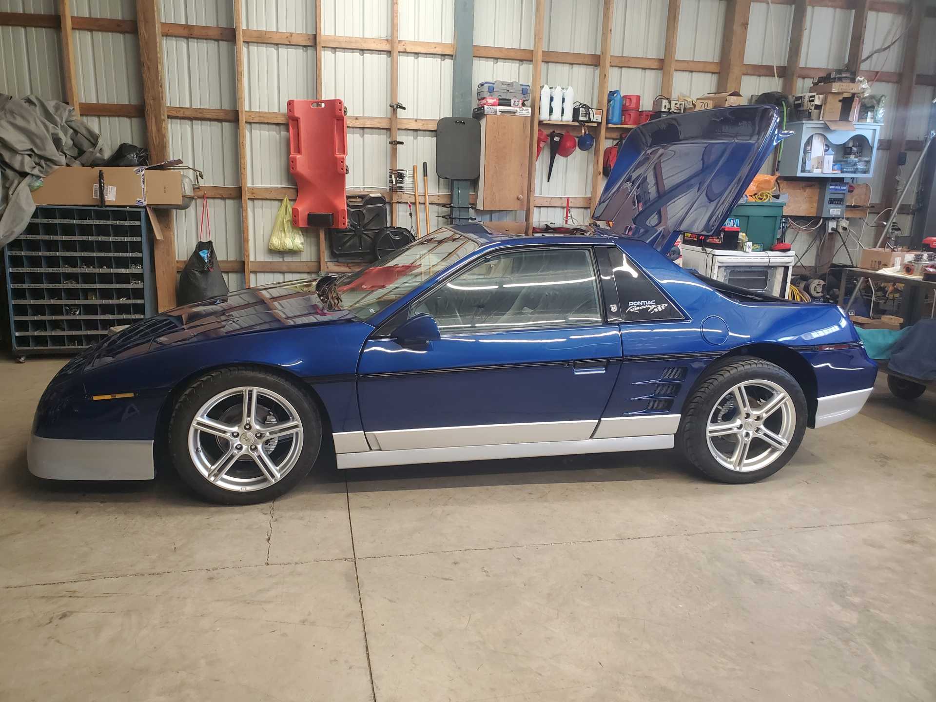

Finally, by the end of March, the insulation was in and it was time to get rolling. Matt was simultaneously doing a rebuild on his SD4 (because two engines at once is always better right?) so that was pulled first and then it was transitioned onto a roller cradle to be moved into the Blue Demon's parking spot while the Demon occupied the main work bay.
As the time to pull the engine approached, I was dealing with some conflicting emotions. By now if you'd read this whole thread, you know that this began as a father-daughter project. I was excited about the LS4 and it now being a husband-wife-friends project but I was sad about pulling the 3.4L that I did with my dad. Since he passed away last July, he would not directly be a part of this build but he was on my mind each and every day that we worked on the car.

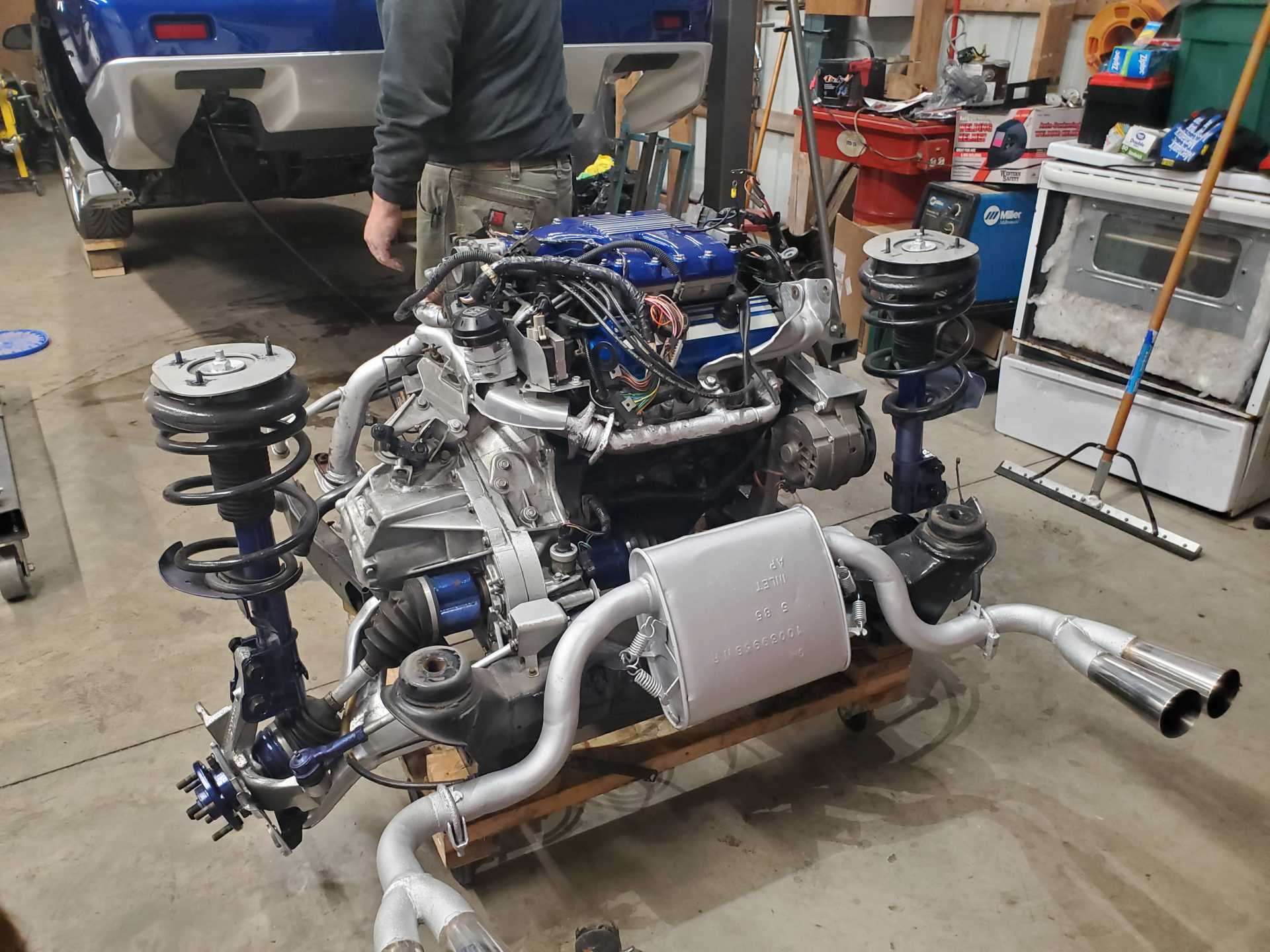

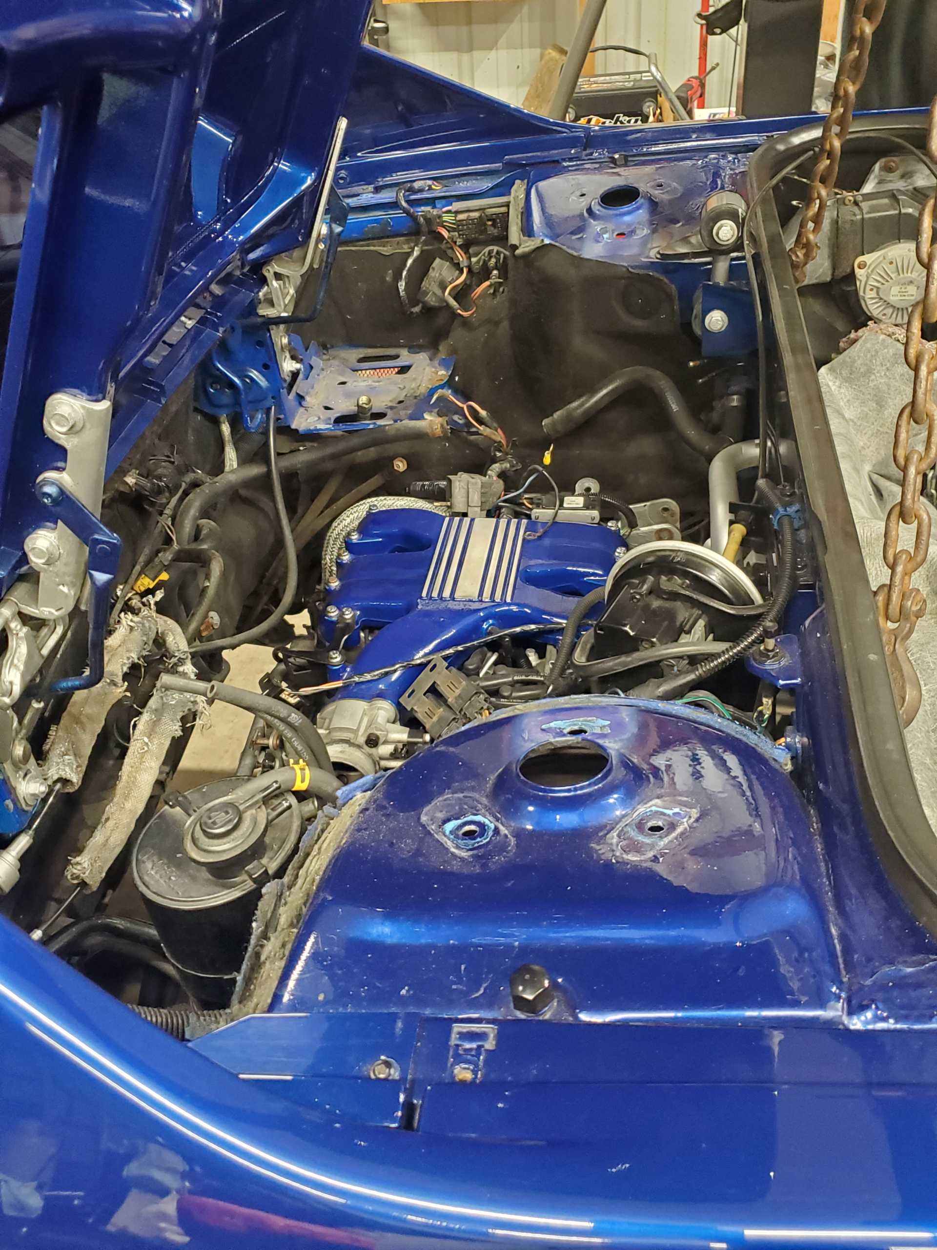

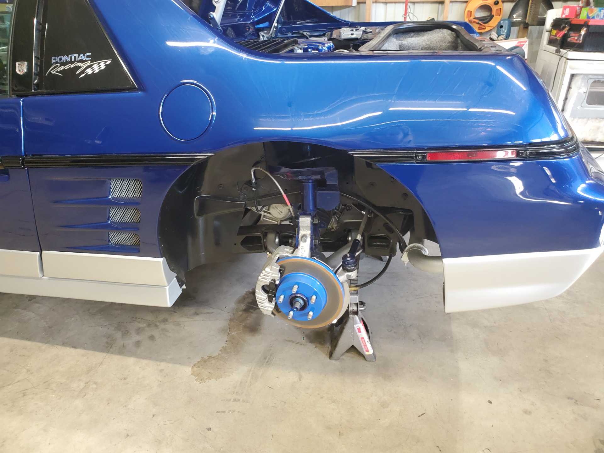

Engine removal here has become a pretty quick task...although the Gilbert-Goss record with 3 people is right around 30 minutes, we weren't in a rush to complete this task. Despite the car's reputation, it went pretty smoothly:
The next step would be to remove the decklid to begin work on prepping the compartment and hinges. Thankfully, one of Matt's friends stopped by just in time as the decklid with the whaletail was a little heavy.

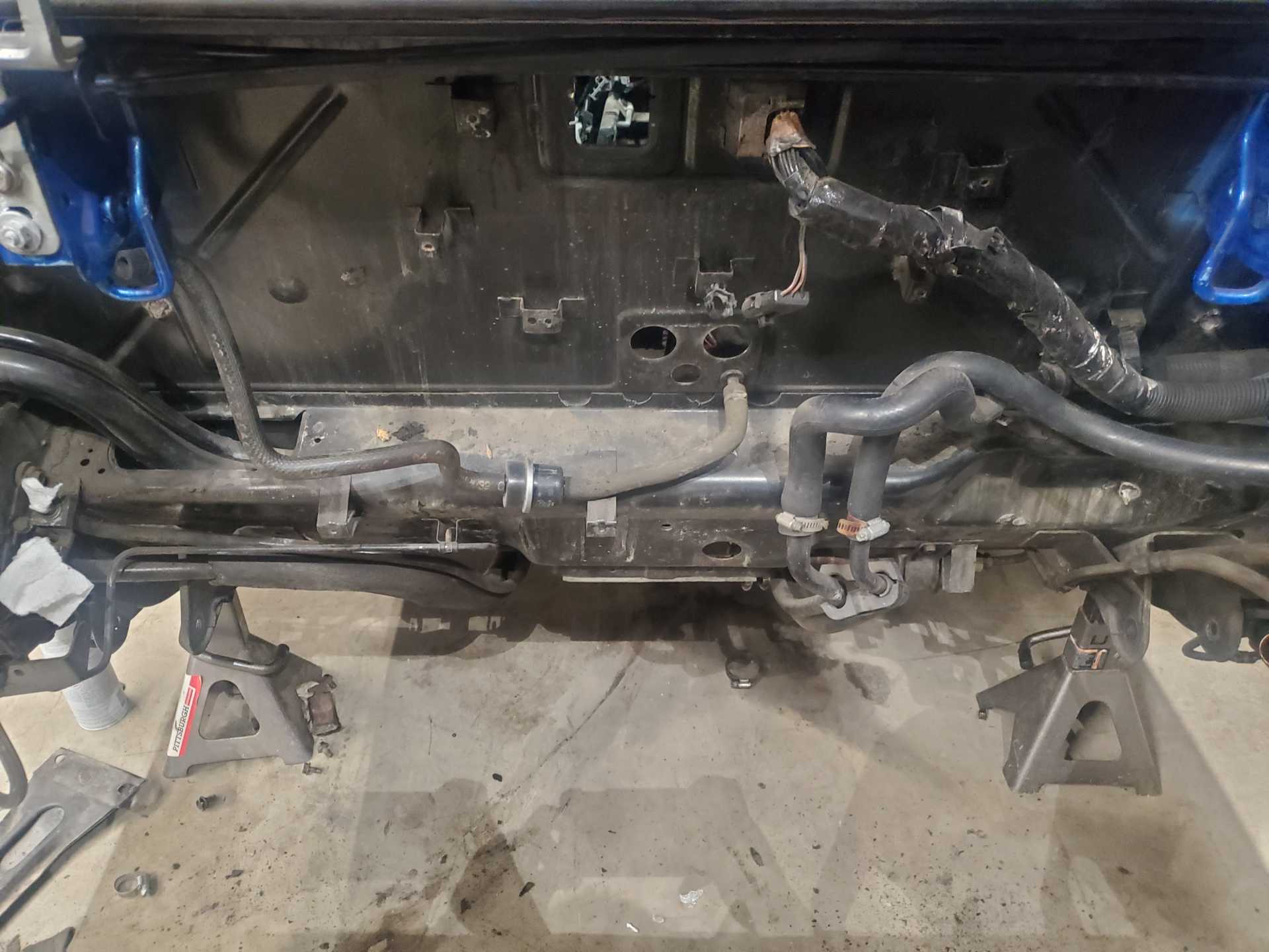

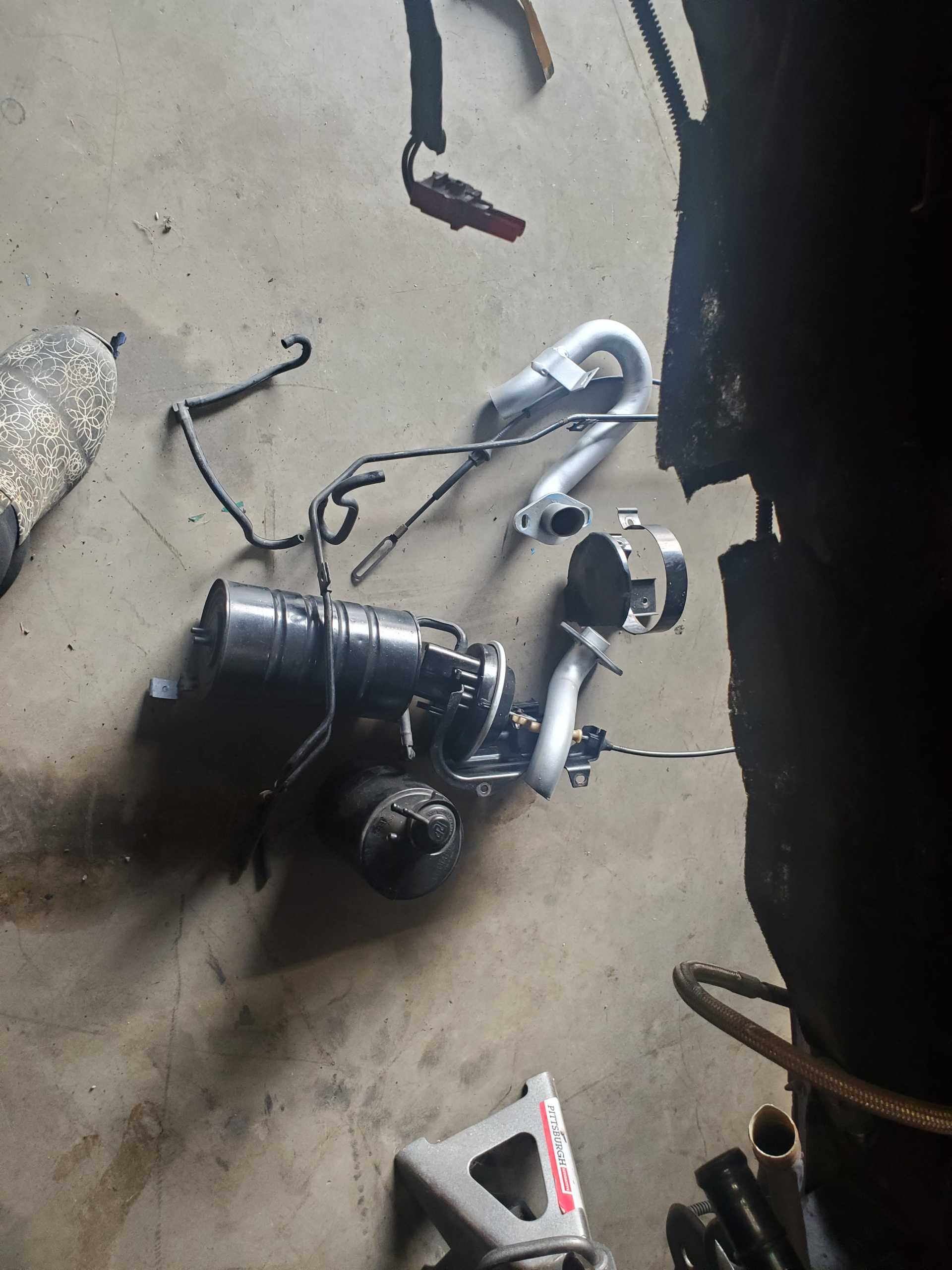

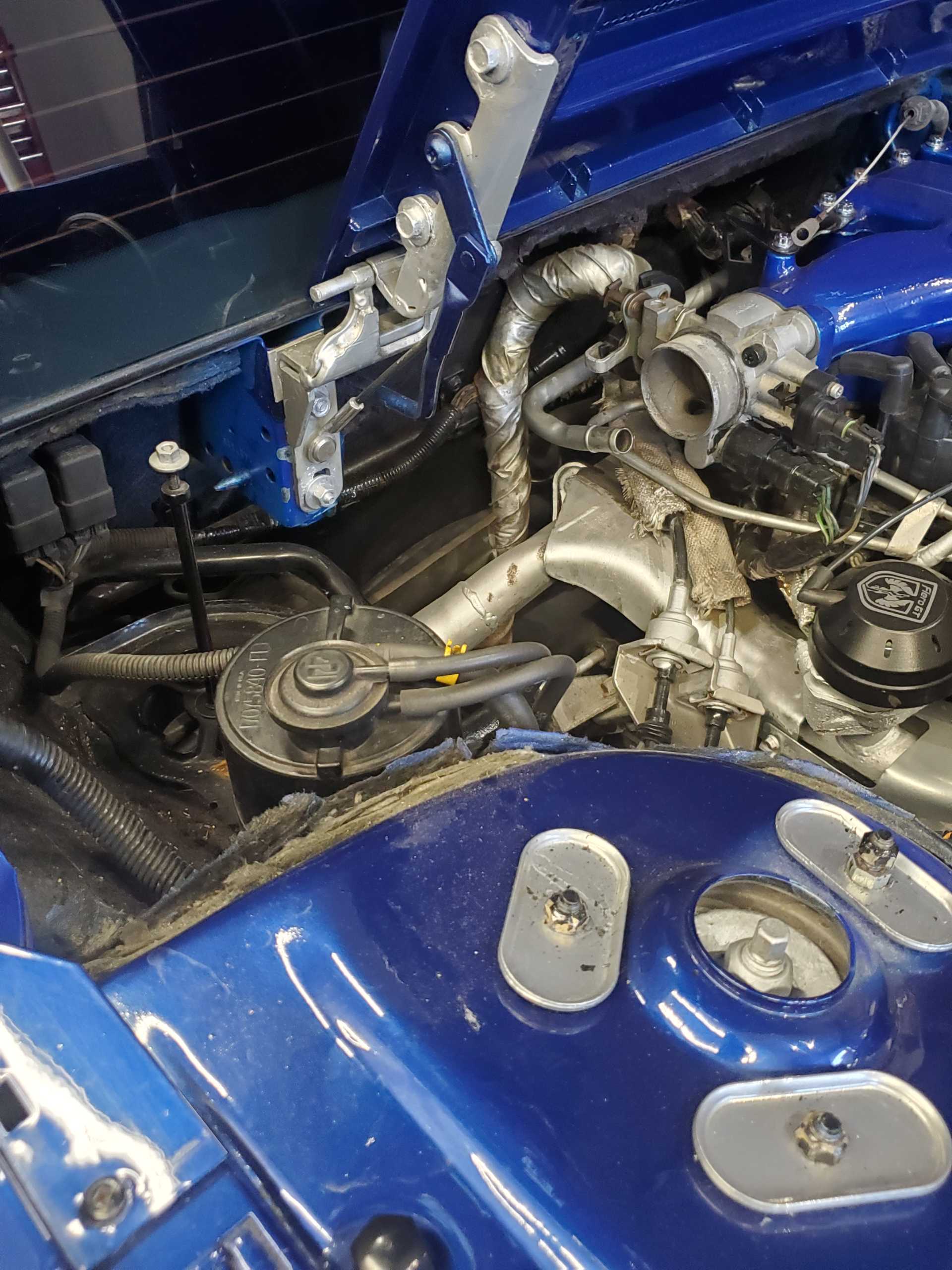

With the car draped, removal of the engine compartment's "pieces parts" began. This was mainly my task as Matt was meanwhile engineering other things...
