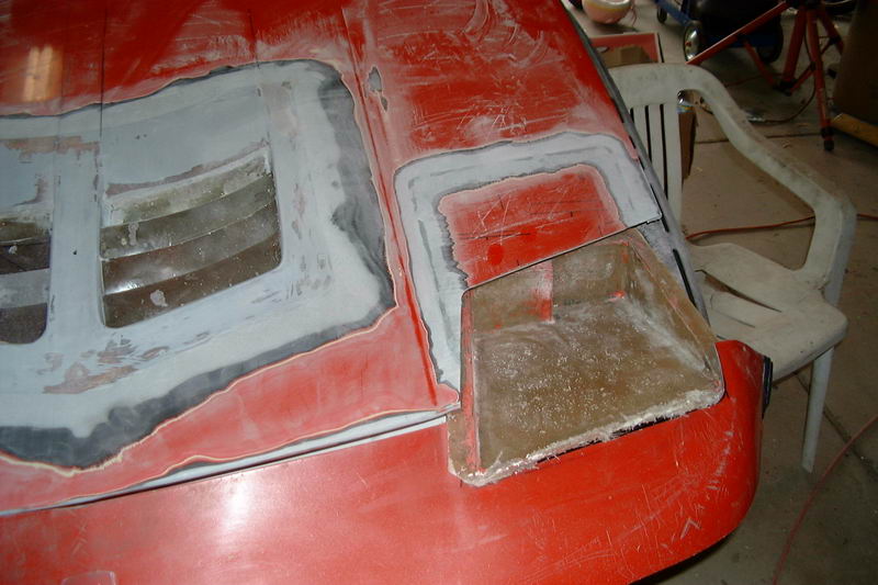

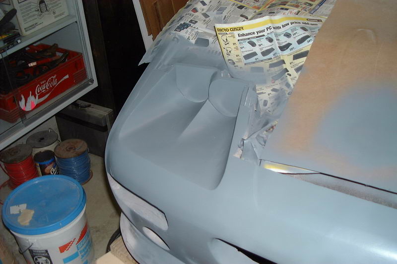

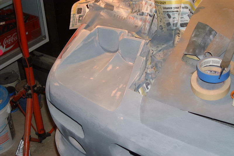

Alright...update. And I'm a little geeked about it. I finished the passenger side pod and created the mold (or at least the start of the mold).
Just before I started this project, I moved my battery under the headlight area. Well Murphy's Law kicked in just after I got the motor running and the battery died. So, it was either cut out all of the work or finish it with a mold. Sooo...
I purchased some polyester primer and shot several thick coats. I love this stuff. It should make this so much easier.
Then some spot cleanup. I used modeling clay to make the corners and fill some edges. I also waxed it and sprayed on several coats of PVA.
Then came the nervous part. I really thought I screwed it up when I layed the fiberglass, but I built it up anyway and popped it off this morning.
Not perfect, but much better than I thought it would be. I'll have to clean it up and build some flanges, but it's better than my first attempt.
