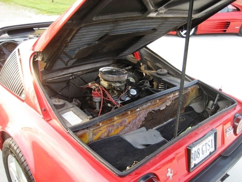

reholmes MAY 30, 09:18 PM
Great swap. Has been removed from Craigslist--either cuz it's sold, or some F-car owner shot him,
"No tire kickers or joy riders... CASH ONLY....
Lots of Pics to load.. Please wait to see all of them..
1981 FERRARI 308 GTSi RED WITH TAN. THIS SPORTS CAR IS REALLY FUN TO DRIVE. EVERYONE LOVES THIS CAR! THIS FERRARI HAS BEEN MODIFIED BY 2 OR 3 OWNERS AGO. THE MOD WAS DONE IN FLORIDA. THIS CONVERSION MAKES SENSE! THEY CONVERTED IT TO A FIERO (GM) V6 2.8 ltr. WITH THE FIERO GETRAG 5 SPEED TRANS. THIS MAKE IT REAL EASY TO FIND PARTS AND GET IT WORKED ON. NO SPECIAL FERRARI MECHANIC NEEDED. I JUST HAD THE (GM) TRANSMISSION REBUILT TO THE TUNE OF 1400.00. IT RUNS AND DRIVES JUST FINE. IT ALSO HAS 3000.00 IN NEWER KONI SHOCKS (as stated by previous owner) They are adjustable to the height you desire. THIS ALSO COMES WITH A SET OF REPLACEMENT DOORS. THE DOORS ARE VALUED AT 2000.00. THEY ARE LOADED WITH THE GLASS AND IN GREAT SHAPE. THE OVERALL CONDITION IS THAT IS LOOKS GREAT FROM 10 FEET AWAY, BUT HAS SOME RUST SPOTS THAT WILL NEED ATTENTION TO MAKE IT A SHOW CAR. IT IS AGREAT DAILY DRIVER.Upgraded 355 MOMO rims with Great Directional Z RATED tires! The Tach, Oil, Temp, and Fuel gauges work. Speedometer works (some of the time- I think it is a ground issue) It has some quarks, but wont keep you from having fun while driving it. I do not have the Org. rims. This has the Fiero rear cradle... simply 4 bolts to drop the motor and the rear end. This is a GREAT car to put a LS1 Corvette motor in. It uses the ORG. Ferrari muffler. Windows work, but run slow like all Ferraris. I have the cover that goes around the spare tire and covers the NEW master cylinder. Comes with Manual. Bring CASH and enclosed car trailer. Unless you are within 100 miles. I AM ONLY SELLING THIS COLLECTIBLE 308 (like magnum PI) BECAUSE LAST YEAR I PICKED UP A 348. ( does any one guy need 2 ferrari's??)"
Wish I could have seen the pics.

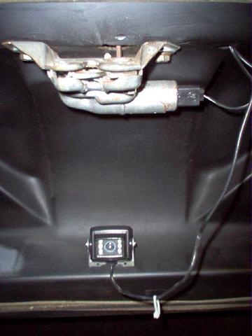

batousai666 MAY 31, 03:37 PM
crap! my idea would work if i had a light source...
i moved the existing back up camera that came on the car when i bought it..
ran thru my stereo DVD player.
thinking of rigging the trunk light with a switch and a smaller camera closer to the gauge for more focus....it was all small and hard to read...maybe a night vision camera would work.
D

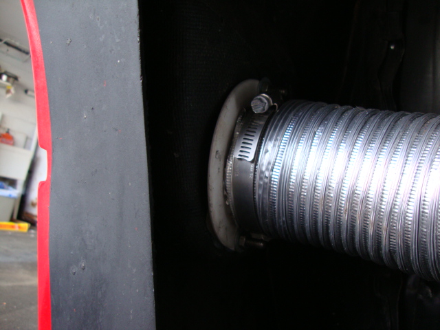

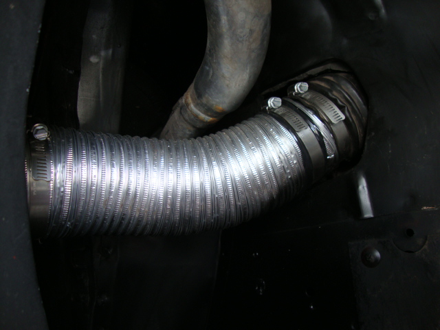

Never had a chance to post my CAI mod. I did this a while back, and never had a chance to go back underneath and take photos.
Had a heck of a time removing the "water separator box" or whatever that is. Seems like from other threads, there is some "discussion" as to its real use. Anyways, with the Mera panel, there was no way of getting that box out, so I just ended up hacksawing the thing out.
Here's a pic of where it mounts to the panel. You can't see it, but I used is the aluminum ducting they sell for dryers, the one that has a 12" length that is meant to go through walls. I used tin snips to cut it down to size, and then used some bolts/nuts to attach it to the hole in the panel. With the left over duct, I used it to create the junction between the rubber elbow from the air cleaner housing, to the dryer hose. I wrapped electrical tape to where the large hose clamps go, so they would not dig into the aluminum hose when tightened.
Pretty inexpensive mod. About $15 total for the duct that I used for the mounting, the hose, and three large hose clamps (bought them all at the local hardware store).
Does it work? Well, I made a very unscientific test. Before I did this mod, if I held a lit cigarette near the opening, I could not tell if the smoke was being sucked in. After the mod, the smoke is DEFINITELY being sucked in! Difference in power...I'd say nil. But with the increased sucking noise, the butt dyno thinks there is. I personally like it. With that said, however, I don't think I would recommend this mod if your Mera is going to be driven in the rain. Unlike a Fiero, the opening in the Mera is where rain can accumulate and get sucked in.

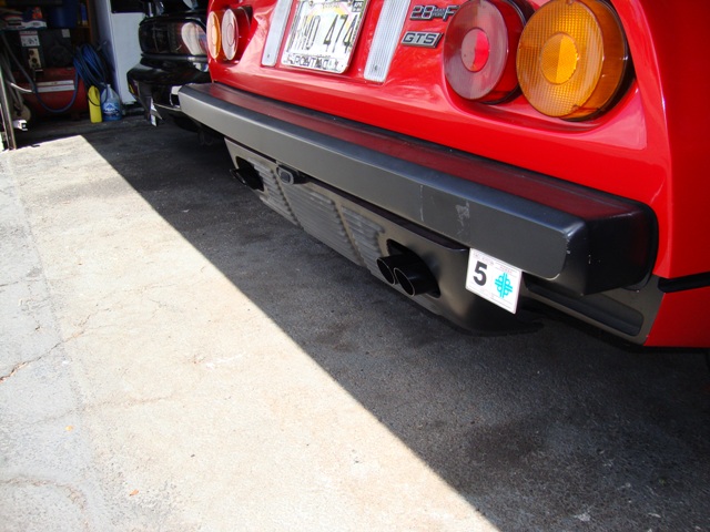

And one more CM (Cheap Mod). Early on (LOL, I think on page 1 or 2), Rodney noted that I had the wrong exhaust tips (mine came out quite a ways, and was just a verticle cut). So what I did was hacksaw them at an angle, and closer to the body. Filed it down, sanded it, and painted with high-temp black paint. I know, not OEM (Original Equipment Mera), but it looks better.
