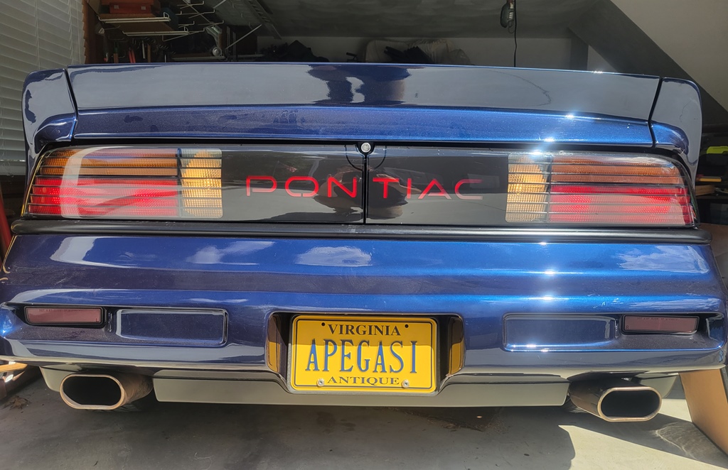

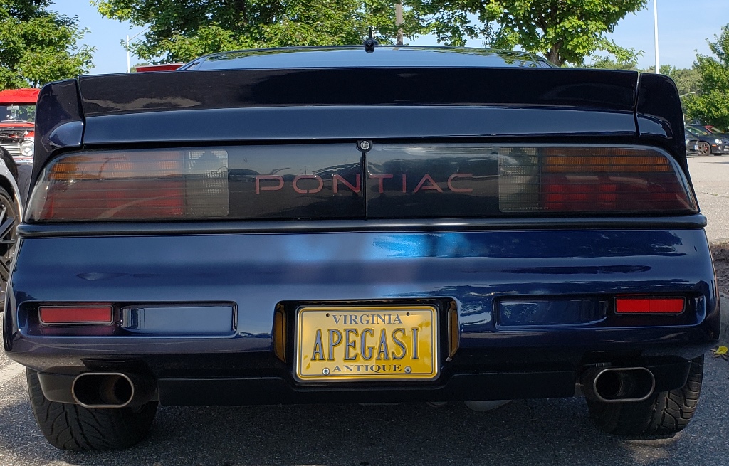

I've had these replacement lenses for a while and just getting the time to install. I'm not the first to post these, but wanted to share Before and After PIX.
Before:
.jpg)
After:
.jpg)
While I had the taillight assemblies apart I recoated the reflective back panel. Between that and the new lenses...What a difference!!!
I want to thank Keith Goodyear and "Belly Acre Studios" for getting these much needed taillight lenses to the Fiero Community.
