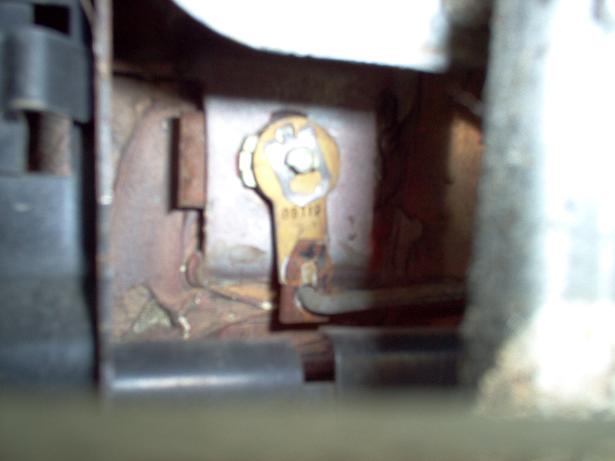

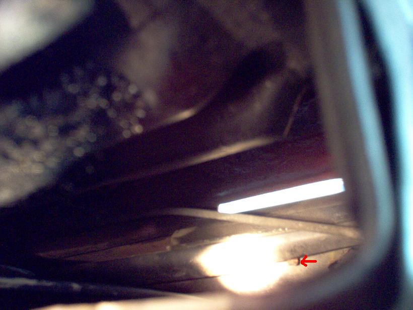

batousai666 MAY 15, 10:06 AM
considering taking MeraX to breakfast for our Anniversary.... i was giving him a good going over, wait did i refer to X as him......
uhhhh, anyway found this rubber piece needed to be taken apart for a little peepin'
notice the red arrow points to the bolt end on the inside, pointed in not out. mine 'tis not like in the FieroNews dl's.
COOL! also seem like the videos reflected a mad butcher behind the grinders.
i witness some "massaging" of the metal in my door handle, but not an outright slaughter.
i DO have mounting plates, like they do. cept they look different. gotta watch that again
later
D
ohh.....yeah as far as adjusting the handle?? i think maybe....if i bend that plate down/in i think it will help me. in my case i also need the passenger side handle to move 1/2 inch to the left if looking at the door. if i stay to the far left with like 2 fingers its way easier to open than if i try to "center" my fingers. all 4 in the hole on the handle..sa'right??s'allright!
