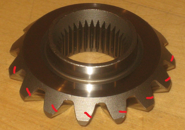

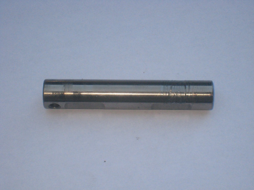

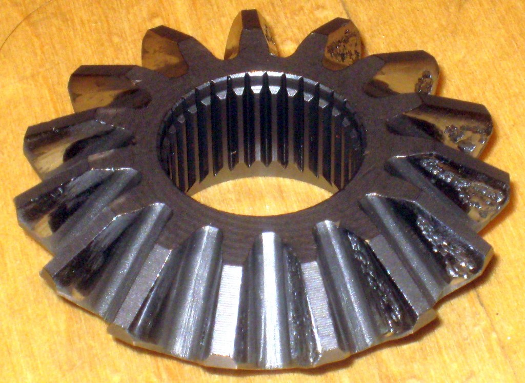

Originally posted by longjonsilver:
Found an M17 tranny for $100C with about 200K clicks on it. Gonna spring for it.
Be sure to disassemble and inspect the differential. Among the three Muncies I took apart, none of them had a differential in good health. Even the one that came from a low-mile Iron Duke car.
A chewed up cross pin:
Damaged planetary gear teeth:
Cracks (highlighted in red) on a planetary gear:

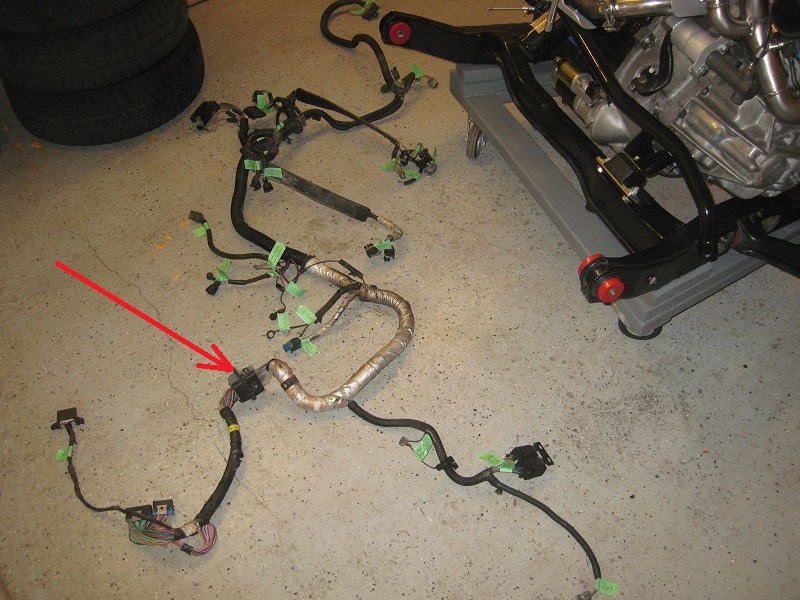

i get how the C500 is in the Fiero engine compartment
Be aware that the C500 location is different between 84 Fieros like Freya and 85-88... so watch what you're reading.
but how does one route wires to the C203 which is in the Fiero center console?
Here is the stock wiring harness from my 85 Fiero L'enfant de la bibite:
The red arrow is pointing at the firewall pass-through. It's more or less of a "grommet" to keep the wires from chafing in the firewall cutout. The pass-through is made of plastic, and it is filled with hot glue. To soften the hot glue enough to pull out or feed through a wire, I submerge the pass-through in a pot of boiling water.
