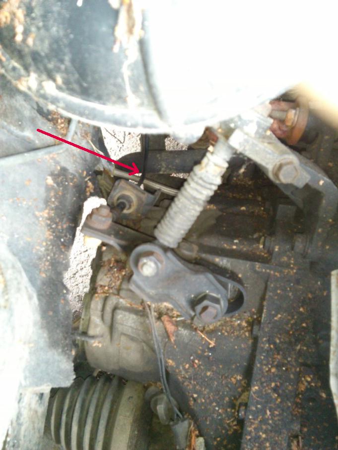

I had some time today and started to fix things, first of all I disconnected the selector wire, to my surprise it now was easy to move the shifter right/left ? ..then I thought that it was a problem with the gearbox, but it also was easy to move the lever with my hand..
Then I cleaned everything in the engine compartment from dust (made a big difference) and connected the wire again, hard to move it AGAIN.. not as har das before I think, but hard, I wonder if its the routing of the wire that is the problem ?

It may be the picture but your cable looks kinked like a tight 90 degree bend rather than a sweeping bend:
Repulsiv
MAY 05, 12:27 PM
Well, it make a pretty sharp bend, that can be the problem, but afaik its aleways been like that, and my dad says it was no problem to shift before.
where should it be routed ?
