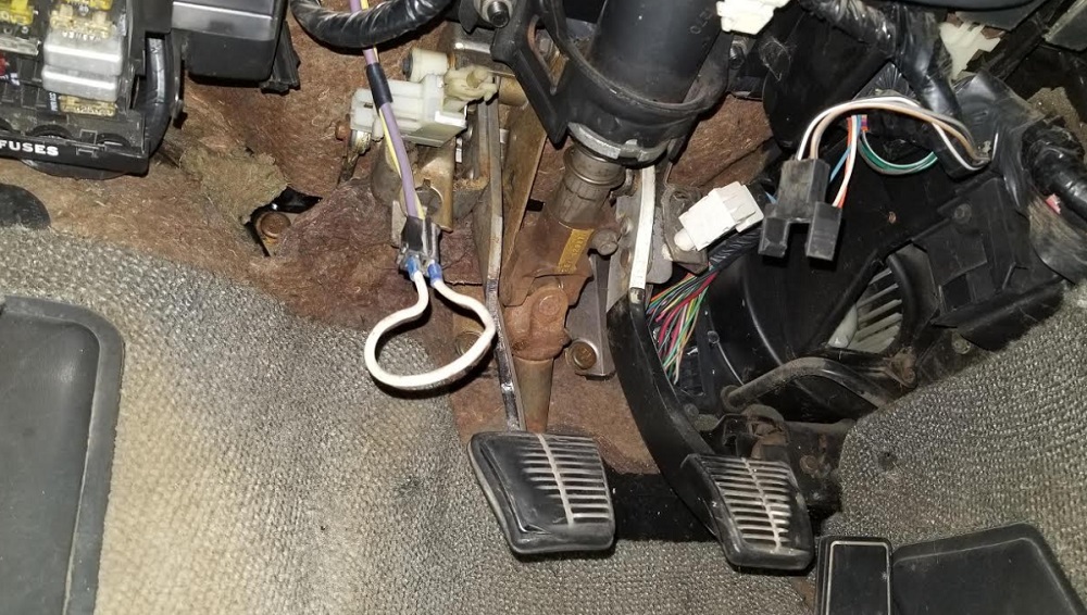

While contorting myself to get under the dash to reattach the brake push rod, I discovered this:
Looks like the clutch safety switch quit working and the previous owner had someone wire this jumper. I've seen a few threads about leaving it this way, but using the same circuit to install a cutoff switch as a theft prevention device. I may do that eventually.

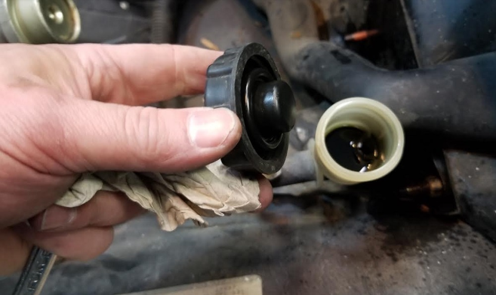

I also made another discovery. Somehow in the 8+ years I've been working on the car, I'd never checked the fluid level in the clutch reservoir.
As you can see, it's just about empty. This caused a light bulb to go off. Years ago when I pulled up the driver's side carpet I was surprised to see a huge patch of surface rust. I'd assumed the previous owner spilled a soda down the console. But recently I came across a thread about the clutch master cylinder leaking and the fluid running down the firewall and under the carpet.

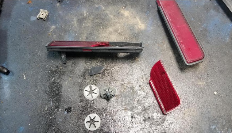

I learned some hard lessons this week. Before reinstalling the rear fascia, make sure you've attached the reflectors first. Also, be very gentle with the 30-year-old plastic. Also, don't pound the steel clips flat before installing, they're supposed to be bent slightly to fit over the pins on the reflectors.
I was irritated that I had to remove the fascia to install the relfectors, but I was disgusted when I broke one trying to install the clips. That led to a 30-minute detour which involved getting one of my spare rear fascias out of the attic to remove the reflectors from it. In the process I saw that I'd removed the reflectors from the OE fascia I stored up there, which means they’re sitting somewhere in the shop.

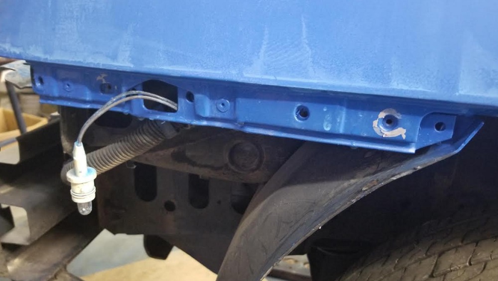

I also learned that you have to install speed nuts on the front fenders and the rear clip in order to reinstall the side marker lights.

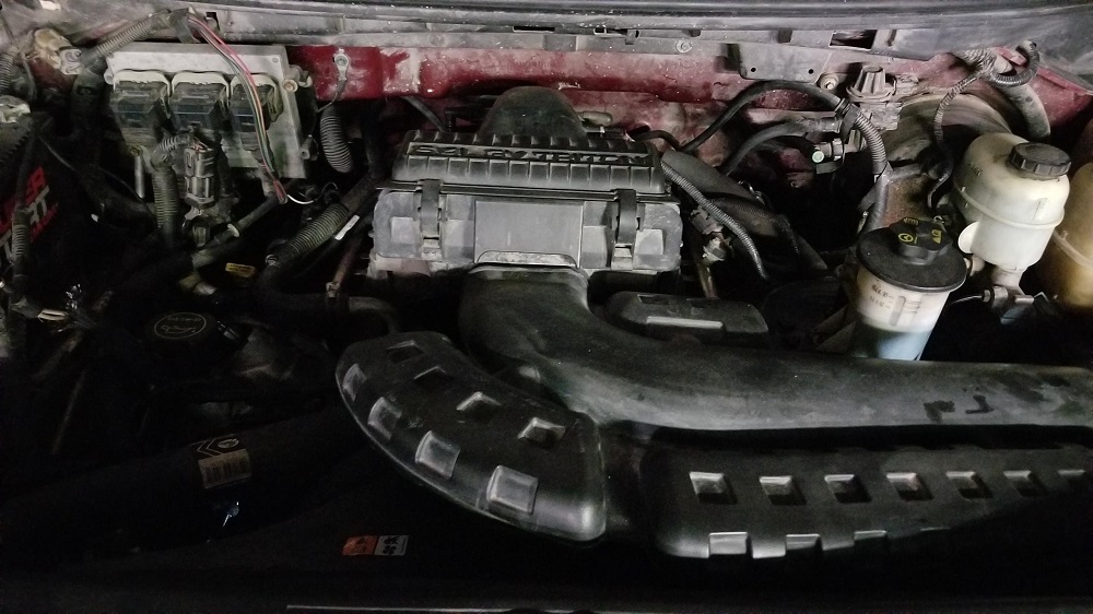

Two, I'm working to finish my best friend's 2005 Ford F150. I changed out the cam phasers, timing chains, guides and tensioners and got it all back together only to find that it runs like crap. I don't know Fords very well, but I will never own one after working on this thing. Bad cam phasers are a common problem, but so is a vacuum leak either at the doodad that controls the 4WD for the front wheels or the brake booster, or both. The fitting for the stupid brake booster vacuum line is on the back of the intake manifold buried under the firewall.

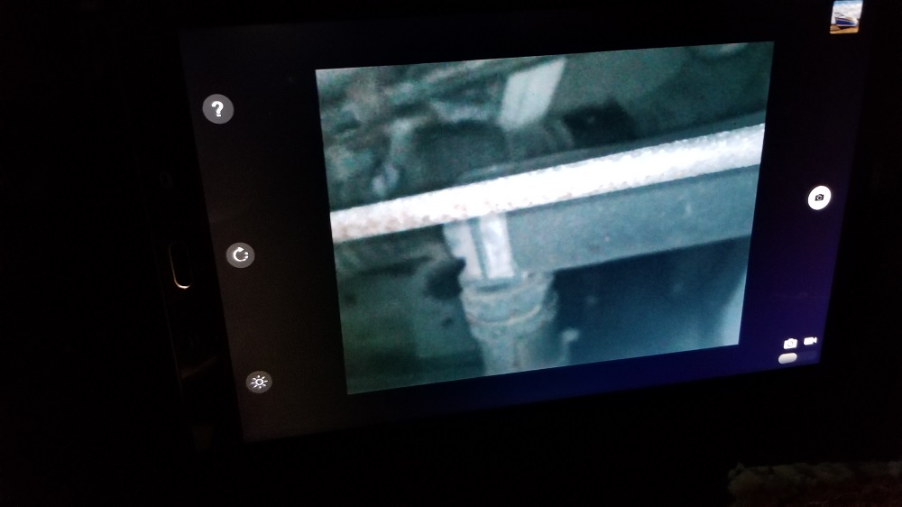

You can't see it, you can't even get your hand back there to feel it. Checking the F150 forums I found that many people buy Harbor Freight borescopes to see back there, so I bought a Chinese one for $11 on Amazon.

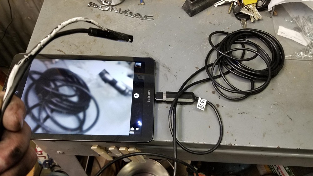

I had to download an app for it, but it actually works. It will not work on Apple devices, but luckily I have an Android phone and tablet. The cable is 15 feet long but it's not very stiff so I taped the camera to a piece of wire. The camera has six very bright and very small LEDs around it with an adjustment knob on the plug. It's designed to be plugged into a PC laptop but came with a couple of adapters for smartphones and tablets.
That is the fitting.
I figured I'll find all kinds of uses for this when I'm working on the Fiero and for 11 bucks it has a surprisingly good picture. It will also record video.
