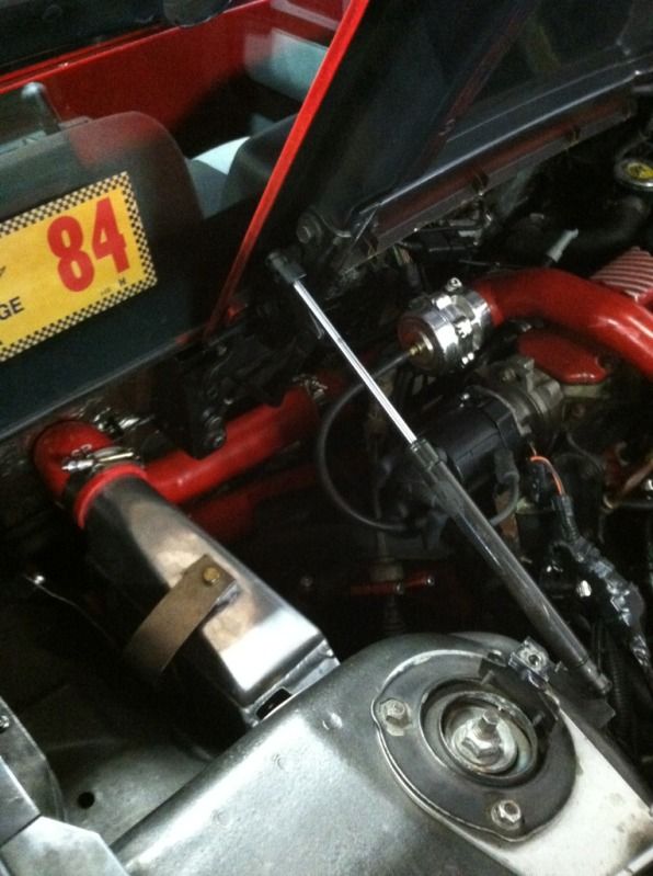

I'm working on an intercooler setup right now. I have a wide band o2 and plan on getting some tuning done after I'm finished with the intercooler to avoid a major failure. It is a fun swap that's for sure.

Got the charge pipes all installed. Next will be installing everything on the wet side.

FieroMaster88
JUL 02, 09:41 PM
I installed a charge pipe coupler to replace one that was split. I'll be driving it again tomorrow. I should have time next week to finish the intercooler install. I have to get the radiator and pump mounted, run the water hoses then wire up the pump and fan. It's been too damn hot at work to even care. 100+ degrees in the shop is getting a little old.
