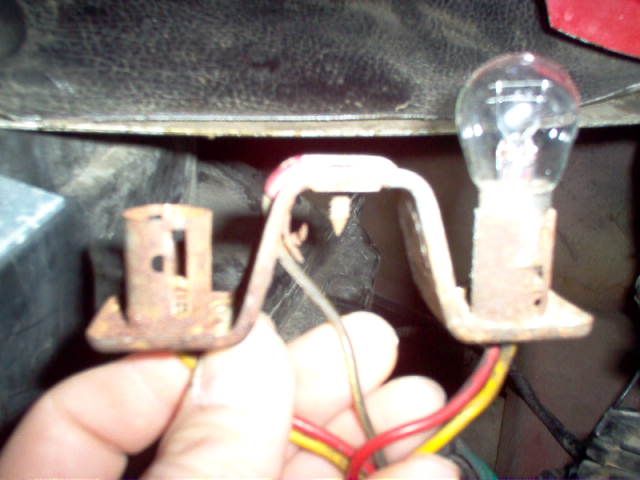

i did notice however that my HazFlashers are wired to the blinkers. both ambers and reds come on.....also noticed that its not just the screws that are rusty. My whole (lookin in, right side) brake light assembly is toast...the top socket is fuse rusted half way up. this concerns me for the fact that.....no wait, this a good thing. should mean that its been there awhile, NO?????

sooo....let me guess, you guys dont have these do ya??
these fit the Carellos to a T. i looked up OEM "Fiero" replacement assemblies but thay are a one socket type like my Turns.
soo this may be a early Mera thing...Maybe??????ohhhh...i hope. in the Meantime anybody know where i can find a replacement???
i feel DOOM! internet is a wash so far....i looked up Carello, Nothing helpful. i am back in the Net for more info.
any info you guys my have will help save Me Rage for something more challenging.

hey dan just fabricate a new taillamp bracket. not that hard to do. later, mike in oklahoma
batousai666 MAY 01, 06:45 PM
(in my best whine)...."But what about the light sockets." they are all one. if they sell loose sockets, i guess....but that is messin with electronics. i sence a short or worse a fire. kidding...the socket itself is all rusted will not make connection. thats why the light bulbs are out. no metal, no short. the brackets are save-able. i will look for replacement sockets in the morning.

dan, go to walmart and buy some inexpensive trailer light kit and take them apart and take the bulb sockets out of them and transplant them into your brackets. mike

really??? that simple??
i do not trust electricity. the stuff is way more radical/unpredictable l than i am. no control. soo i am very apprehencious....some may say "scared" and too a point, yes.

anyway i trust you and will DO this. thanks Mike!
