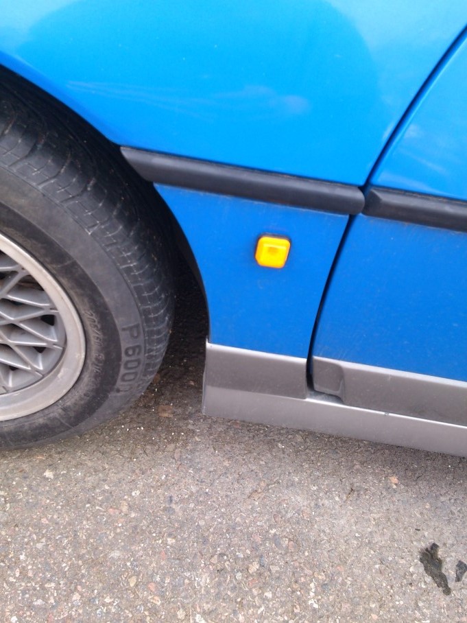

Then I AGAIN tried to remove the aftermarket ones..
.JPG)
I think those have to be functional to pass a swedish inspection.. but I cannot remove them, I tried to peek behind and it looks like I have to remove the whole panel, but how do I do that ? ..I dont really want to break anything trying the wrong way..

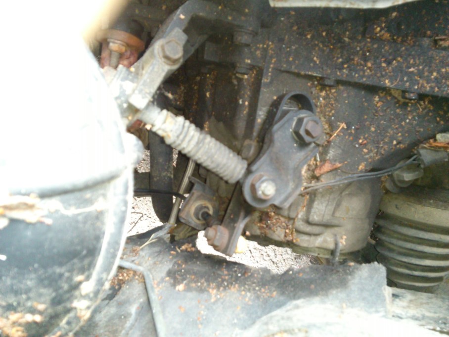

I also took a look at the selector wire..
.JPG)
Can I remove it here without having to adjust anything ? is it just a hole, or a slot ?
