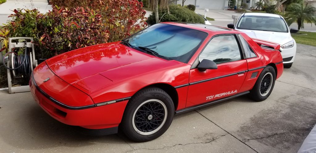

Added some decals.
Found some TDI badges on line, got three sets for 5 bucks.
[This message has been edited by CoolBlue87GT (edited 01-26-2019).]

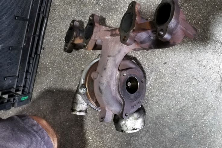

Well, here we go again, had another turbo failure. The shaft that connects the hot side to the intake side broke. Was on the hwy when the car started smoking really bad. Was told later this was due the raw diesel going into the exhaust. When I pulled over on a side street, I shut the engine down, the smoke kept coming out the exhaust pipes for about 5 minute's. Had to have the car towed to the repair shop. The manufacturer had a one year 10,000 mile warranty, so it was not covered.

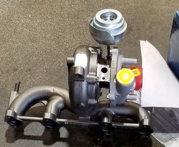

Here's the new one, the manufacturer came down a bit on the replacement cost.

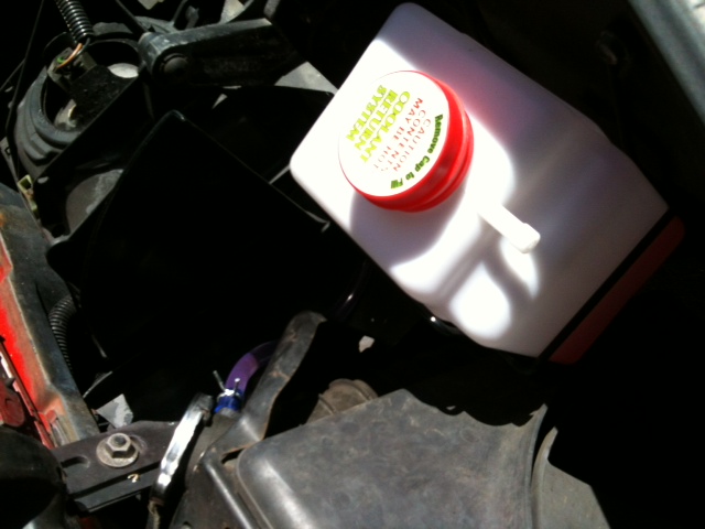

Needed to replace another coolant overflow bottle again, it developed a small pinhole leak. I think sun exposure - UV light, might be the cause, making the plastic brittle. You almost never see this happen to one that is hidden under a hood.
Trying to think of a way to protect the new one, maybe painting it, or covering it somehow. Anyone have any good idea's ?

modemeagle FEB 13, 05:04 PM
You can give this a try.
303 (30306) Marine Aerospace Protectant
https://www.amazon.com/303-...niture/dp/B000XBCURW
Let me know if you want to try it. I am probably moving to Port Charlotte or North Port in a few weeks and can let you try it before buying it. I now use it on all of my exposed plastic and rubber on my cars.

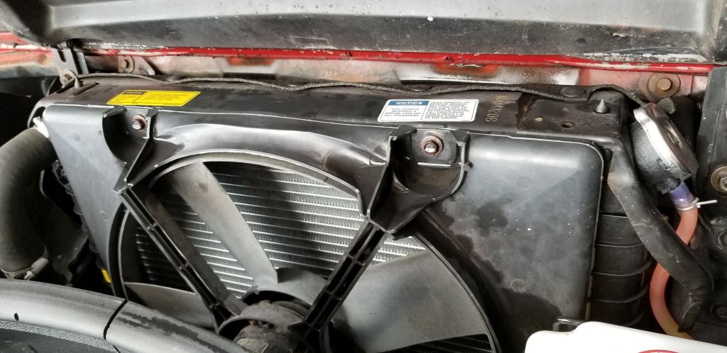

Radiator, the old one devolped a small leak near the bottom. Bought new one from The Fiero Store.
Went in like a breeze.
Both repairs were done at the same time, and have the car running great again.
