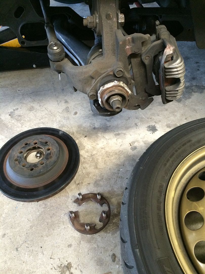

As for wheel bearings, we have stock fronts that get checked often but have never needed anything in the last couple seasons. The rears are the issue. We run stock used units since I believe they are better than any of the aftermarket options on the market. They are also cheap and we have not had any bearing failures but we have broken 2 of the wheel flanges. This is a bit of a problem and we don't have any good strategy in mind for dealing with it yet...
Luckily they are easy to change and we have several spares but at this point all we can do is inspect them often and hopefully see a failure early enough it does not effect our race.

This is the first race we have had wheel bearing issues. We attribute it to a completely dry weekend coupled with faster times than we have ever ran as well as maybe too much rear camber. We did have a couple of off track incidents that put some pretty huge stresses on things. At this point were just going to pay really close attention and hopefully this doesn't become a trend!
