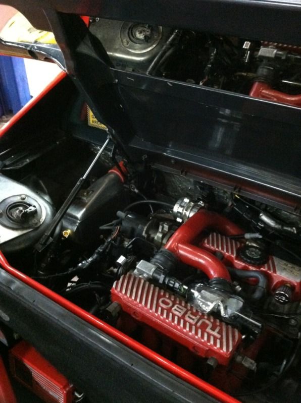

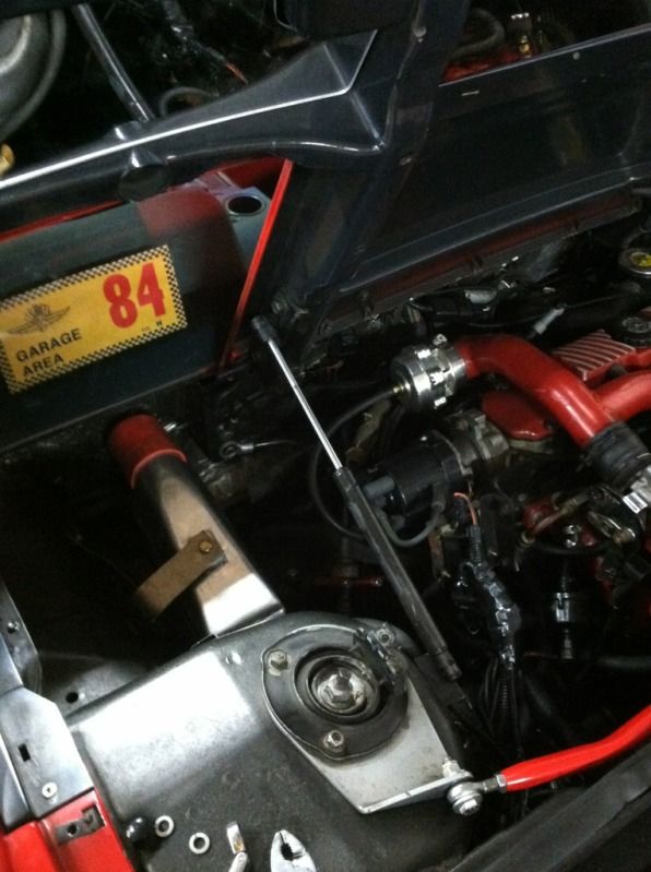

I had to order a couple parts for the charge pipes so not much progress. I got the w2a intercooler in its location:

I must be missing something, how are you going to route the charge pipes into the heat exchanger if the inlet and outlet are against the firewall?

The inlet and outlet are not aginst the firewall. There is about 7 inches there. I ordered 2 silicone 90 degree couplers for them. It gives me a more direct routing to the turbo. Now that I look at the pictures on my laptop and not my phone I see that it does look like the inlet and outlet are against the firewall. It's deceiving because they are not. I ordered these for the inlet and outlet[This message has been edited by FieroMaster88 (edited 06-21-2012).]
