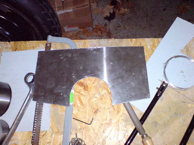

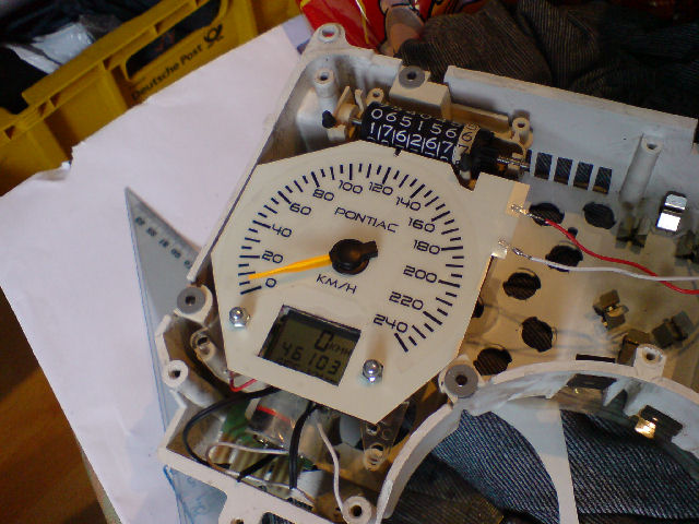

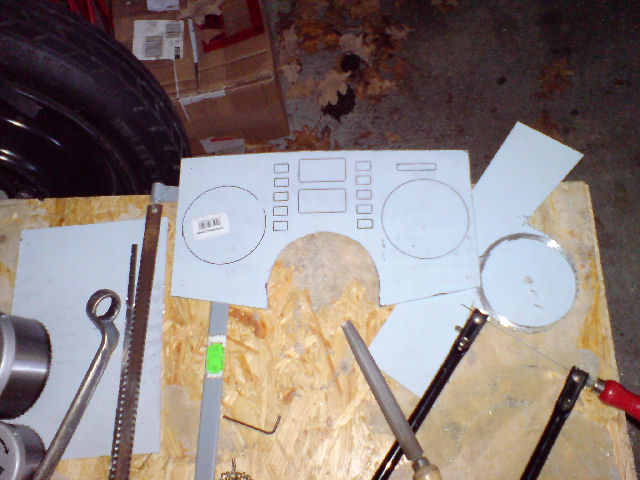

Hi,
half year ago i had a plan......
creating this by using a bicyclecomputer
features :
Total KM or MLS
Trip KM or MLS
Speed KM or MLS
average speed
topspeed
time driven
Processor of this BC can calculate up to 270km/h correct . Somebody told me , or maybe i read it here , that a "Duke" never goes that fast
So that should be ok.
so i bought a Sigma BC800 from E-Bay and took my dremel
after some worke it looks now that way
iam getting to it
just to test if it still fit
Plasmafolia is next step
then ill connect it to the BC sensor which i fixed on 1 axle .
updates follow

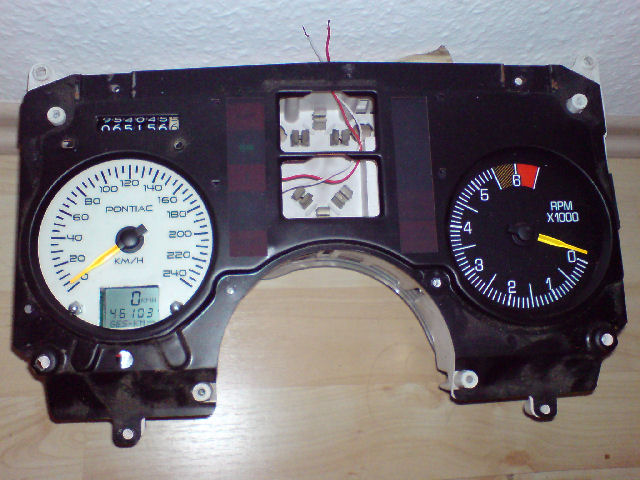

ok iam done with the Speedo
took me a sheet plasmafilm , my Inkjetprinter , and inkjetfilm
Plasmafilm is white and when activated deep blue
Speedo in Dash
now i try the plasmafilm backlight then ill be done for today
[This message has been edited by Fieromaniac (edited 04-11-2007).]

hmmm couldnt sleep so i finished the RPM / Oilpressure gauge too ....
..... i think iam obsessed .... i should join anonym fieroholics .....
further pics follow

Had some time today and my old instrument cover looked at me so i bought me a 2 mm Aluminum plate and had some fun

installed the cluster today
need to relocate the sensor i almost lost the magnet
funny thing is that u can read the display better in the night than on day

yes , EL-Foil on the Temp fuel gauge was damaged so i fitted this here
i also changed the odometer to match the miles of my car ( 103k)

mounted the Sensor with Epoxid powergum
and made several Testdrives to calibrate both Speedos to match with my GPS
if Speedo shows 200Kmh real Speed is 196 and thats very good i think
but i need to install some LED to improve the readability of the Display
