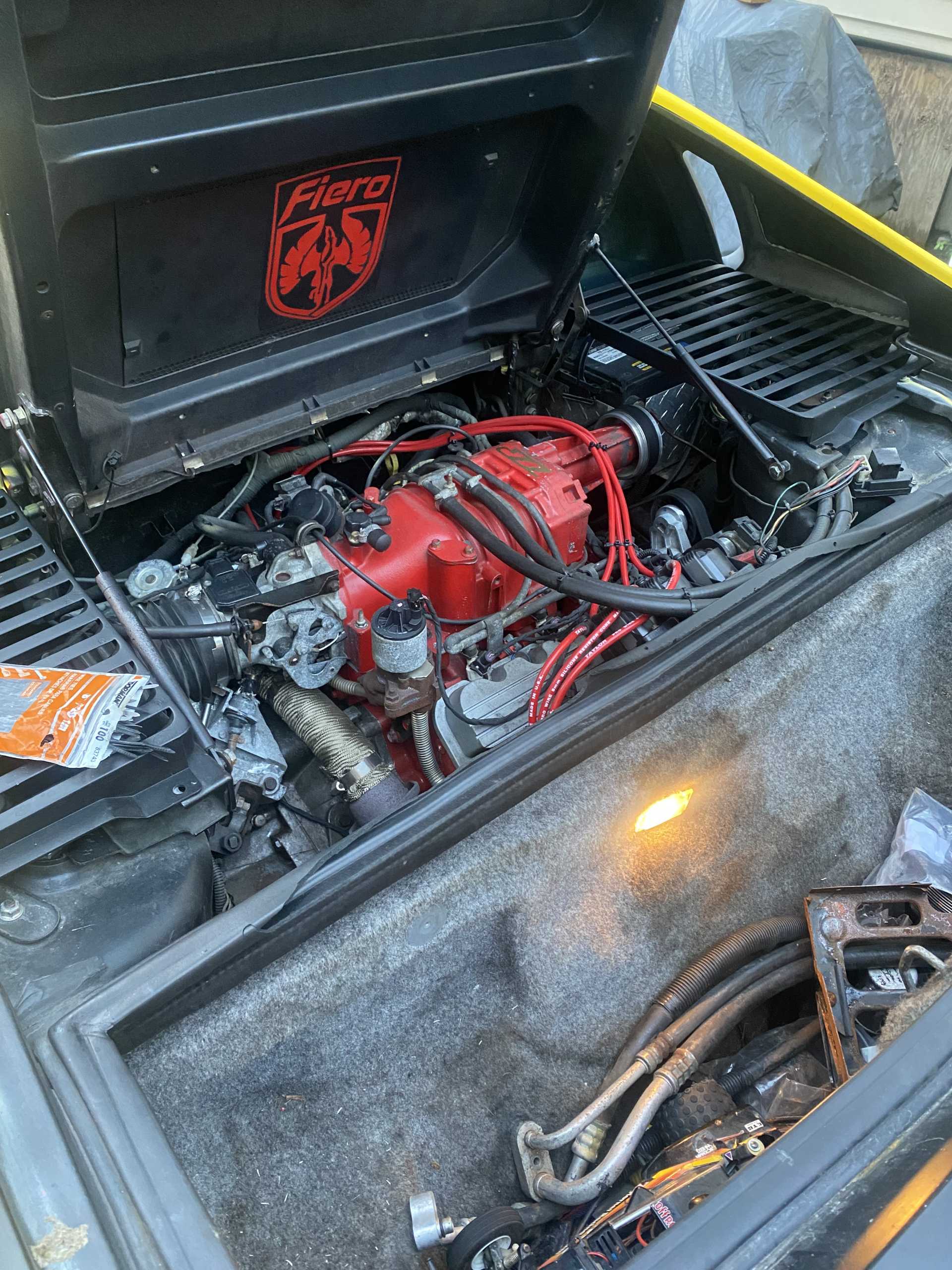

Now I know i shouldn’t be complaining with this just wanted to get opinions. I have a 3800sc fiero with a 4 speed Muncie trans. How is everyone getting with a full tank from their car. I have a fiero sending unit and it is actually really accurate. Before I did the autolite 104, and Taylor 8.5mm wires I was running ac delco iridium plugs with stock ac delco wires I was seeing 200-210 miles a full tank at 65-70 miles an hour. This was on 205/60R15 stock cross lace tires. I installed 17 inch Scion tC wheels 205/50R17 my Miles to full tank have dropped now seeing 170-180 a full tank. Now would this be because of the taller tires or going with copper plugs I’m seeing less of burn from fuel? The car runs like a bat out of hell and pulls hard to 80 like nothings so what could it be? 🧐
