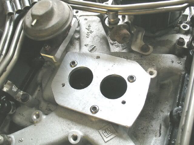

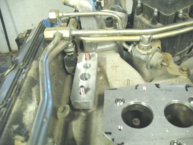

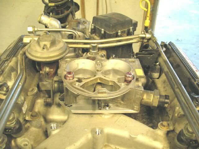

I setup a 4.9 running the 7730 using a 305 TPI 5 speed memcal/prom with a truck TBI throttle body (and normal IAC) and some appropriate knock sensors back in 2008.
Normally, the EGR valve placement doesn't allow the truck TBI as the IAC and EGR need the same space.
The trick is:
  • Flipping the throttle body 180 so the IAC points to the front of the car (simple 1/4" aluminum spacer).
  • Raising the EGR valve 1/2" with a simple spacer as well.
  • Modify the cable pull cam on the throttle body (I used the cam from a 2.8 and welded it to the truck TB).
  • Installing some compatible knock sensors - have to do some digging, long since forgot which ones
Once you do these items, then it tunes (and runs) just like a 305 TPI car with the 7730 ecm with none of the caddy ecm/idle control issues.

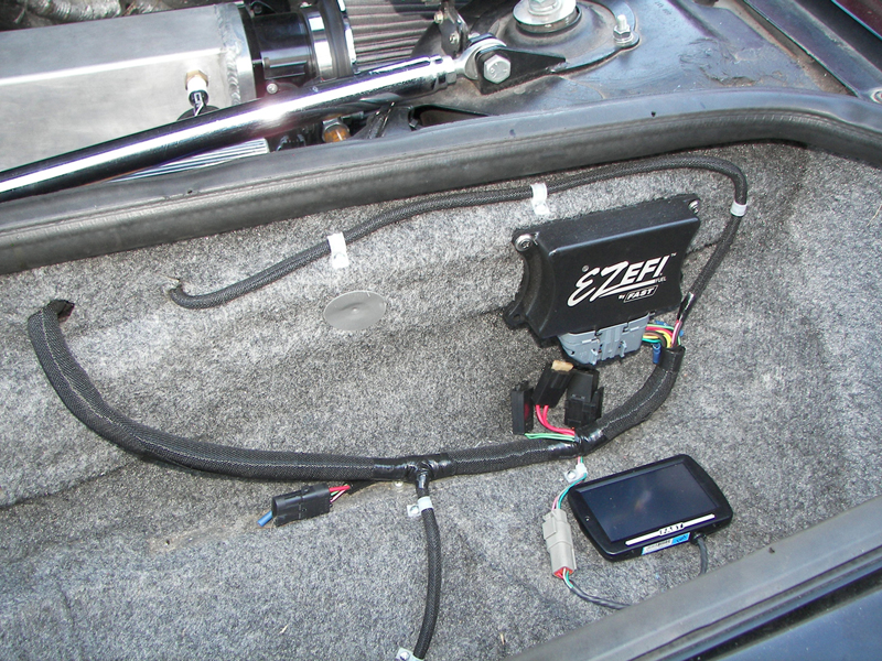

I have a FAST TPI retro fit kit on my 4.9 engine. It uses a custom plenum, an LS throttle body and sensors mounted on an Allante lower intake manifold. Fuel injectors are EV6, 12 hole 24 lb injectors. Uses a wide band o2 sensor mounted to one side of an 180 degree headers and dual exhaust system. The ecm is self learning after a few basic inputs. Quick throttle response, good idle and easy start up. Runs great!
Cheers
