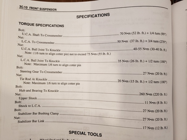

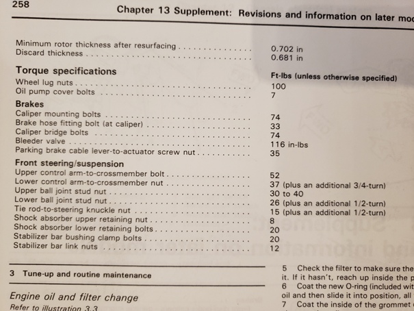

I'm replacing the PS rack and need the tie rod torque specs. I ordered a manual but it won't be in until end of the month.

See pictures from Haynes Chapter 13 Supplement for 1988 models years and the 1988 Service Manual for front suspension torques. Both state 15 ft-lb. plus 1/2 turn.
