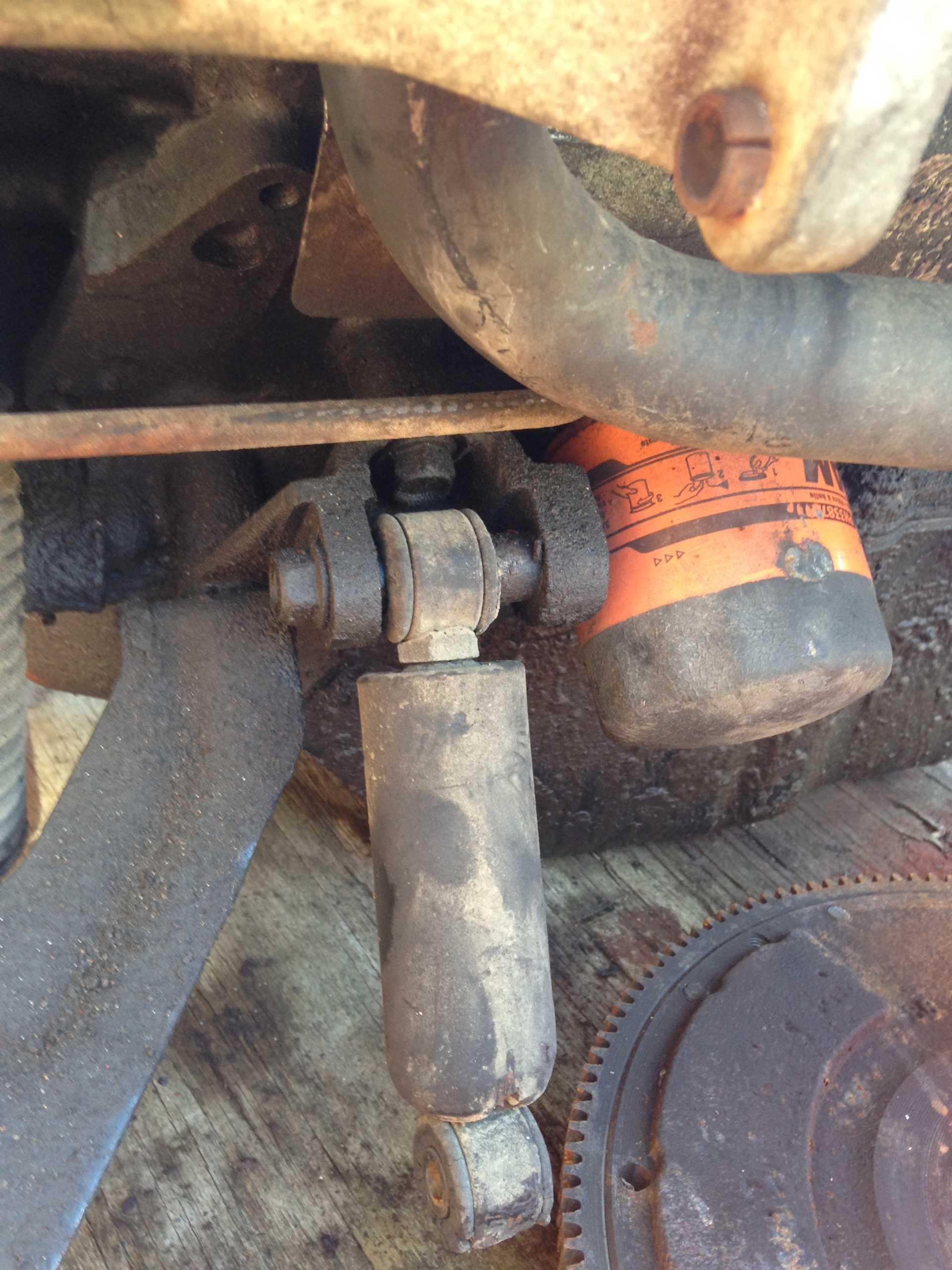

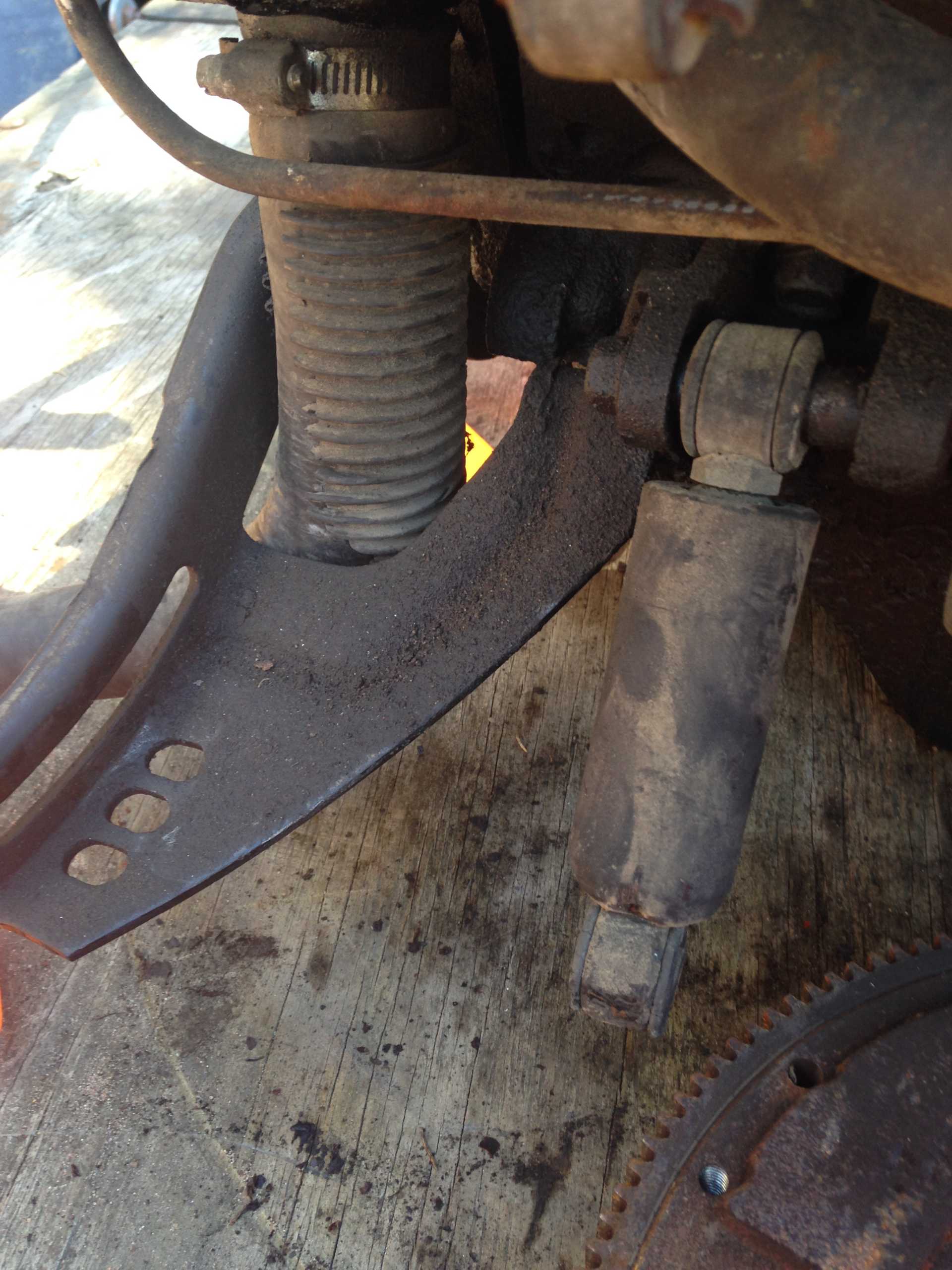

Hi to all,
There is a shock absorber like device on the front side of my 2.8L engine. It isn't in the car yet.
fierofool
Posts: 13014
From: Auburn, Georgia USA
Total ratings: 153
Report this Post08-01-2020 10:16 PM Click Here to See the Profile for fierofoolClick Here to visit fierofool's HomePageSend a Private Message to fierofoolEdit/Delete MessageReply w/QuoteDirect Link to This Post
It is a torque shock that was on the 85-87 V6's. It has a bracket that bolts to the cradle. It was eliminated on the 88 for some reason. It supplements the dogbone to reduce front to rear engine movement when accelerating and decelerating.
If yours doesn't have much resistance or is frozen, you can get a new replacement from RodneyDickman.Com
