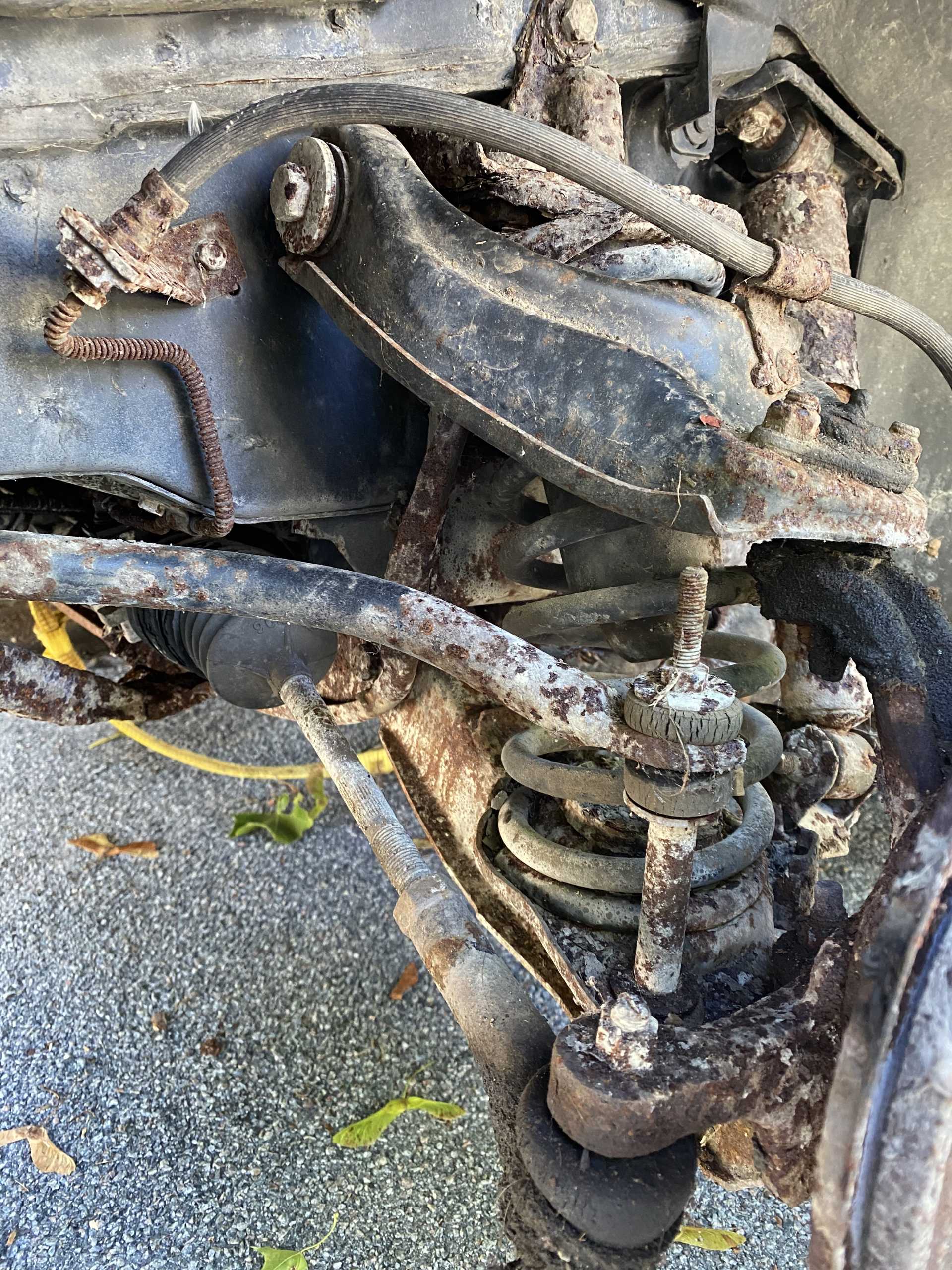

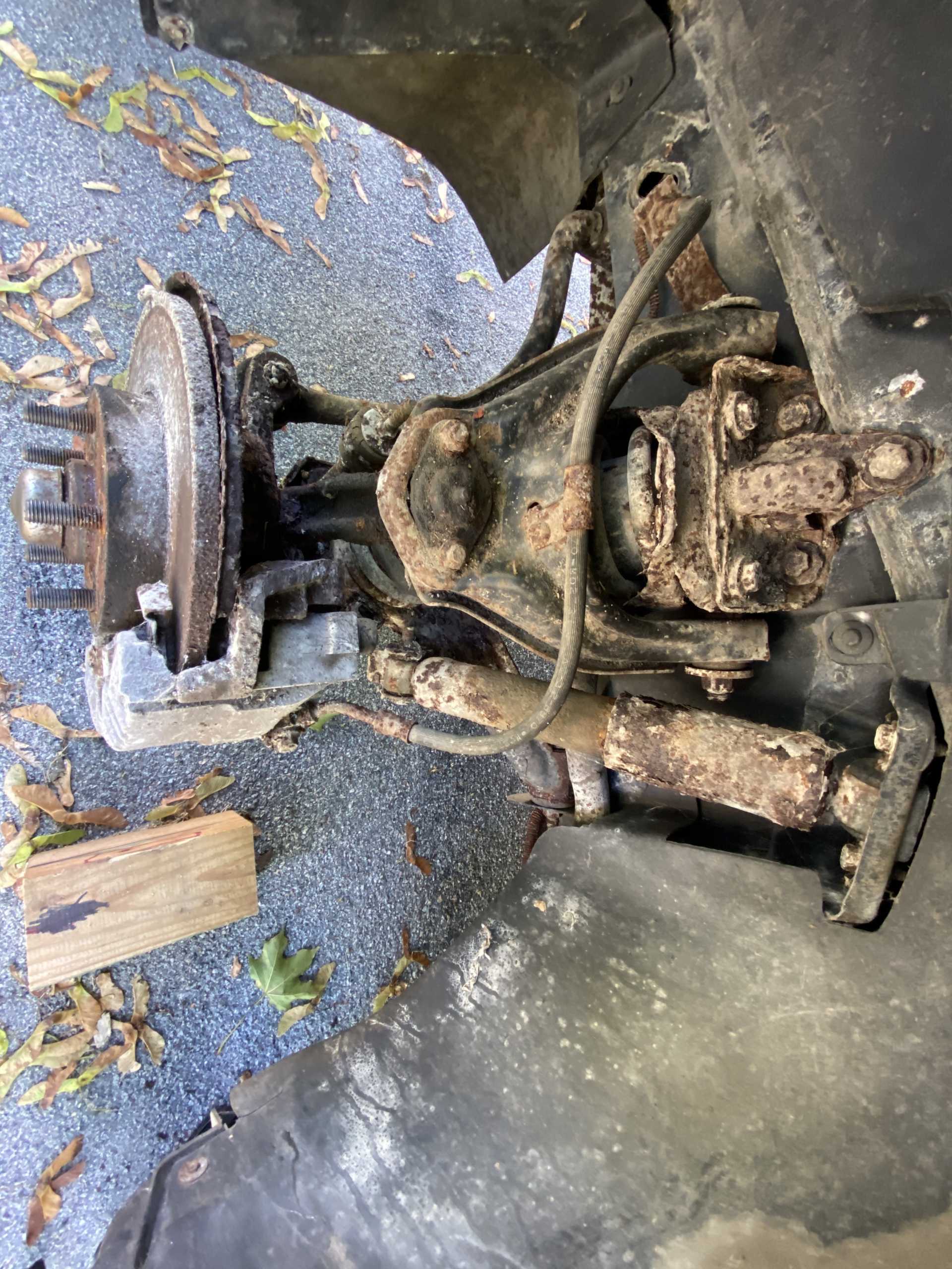

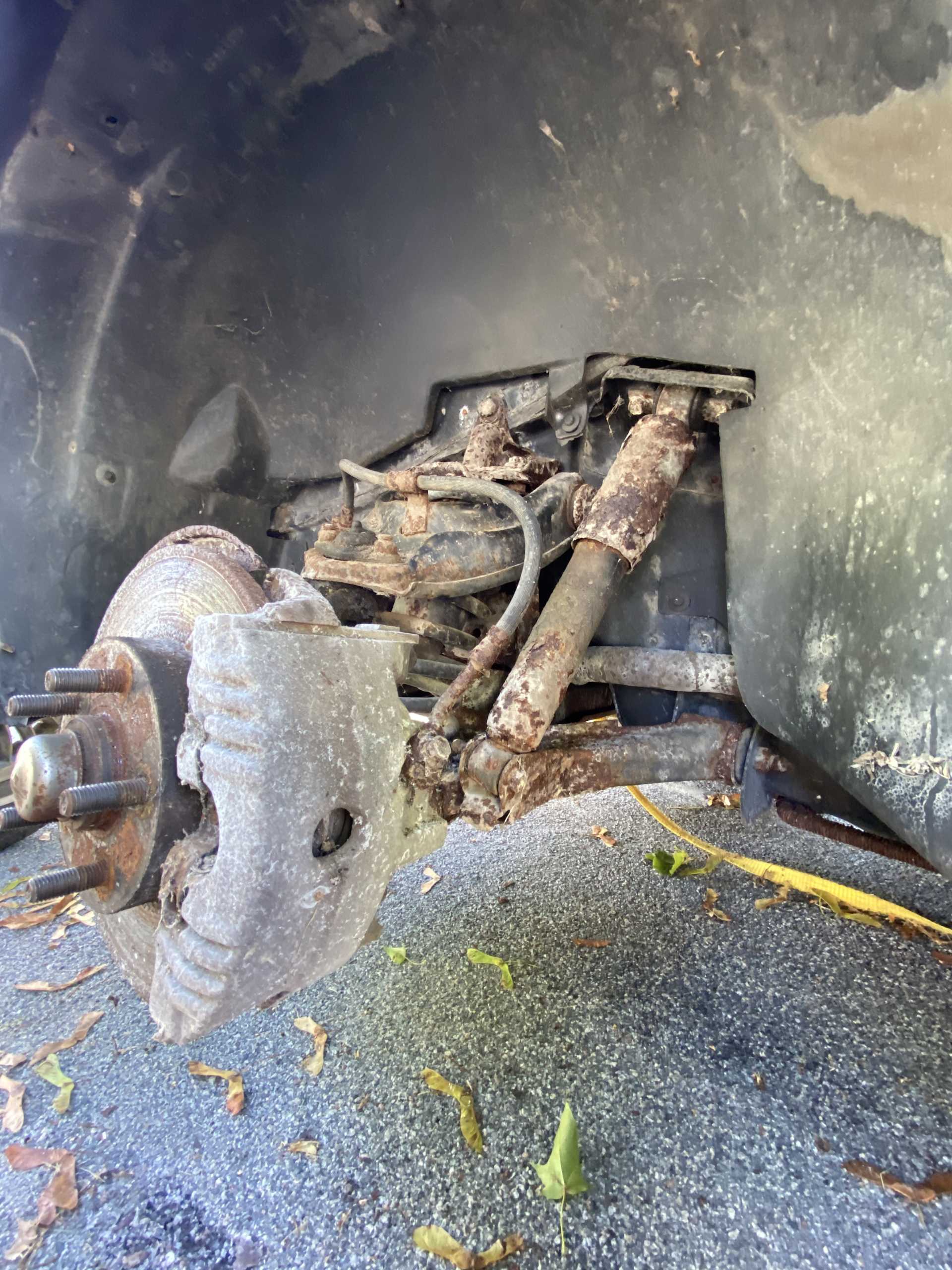

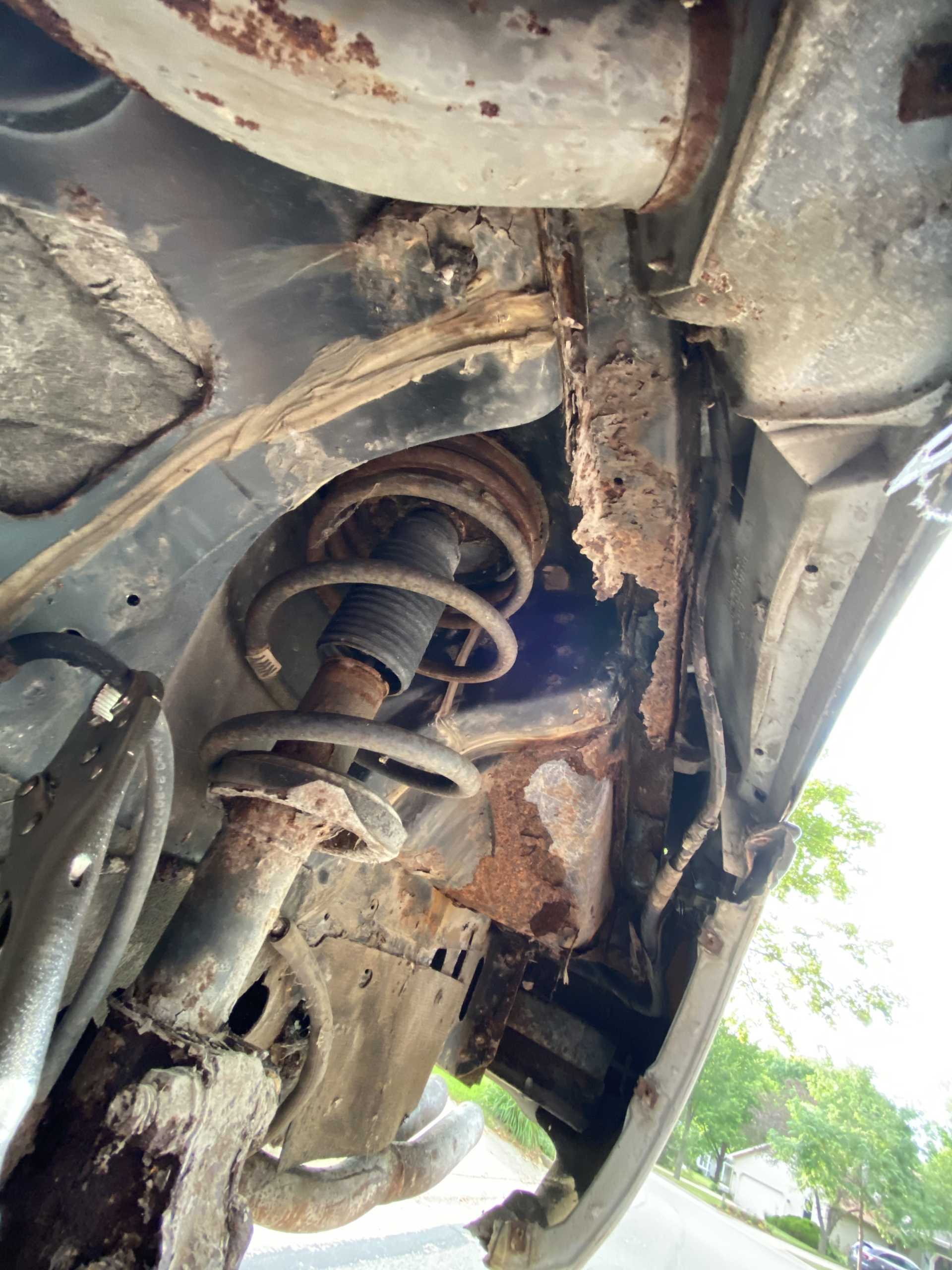

Ok...barn find...and its already mine. I got the time to pull the front driver wheel off today to take a look.
I just want to know how long the road is that I am in for. I am hoping this isn't completely hopeless. Anyone out there have any experience in heavy-rust restores? Any sage words of advice?

NEW BRAKE LINES all around..
New bushings on upper and lower, inner and outer tie rods, ball joints, shocks, calipers, hubs, bearings.
Use your torch a lot.
You could powder coat the parts as they are stripped and polished.
Not so bad.

look behind the trunk carpet, look under the car completly: at the floor, and look above where the engine cradle meets the frame.

Yeah, this may be where there is a glimmer of hope. Everything above about 1ft. doesn't seem too bad. The engine and where the engine cradle and frame meet look, dare I say, decent. I'm definitely going to have to weld new lugs into the floor for the seats and get new seat frames...they are completely gone in places...which makes me think there is going to be some floor pan work. Ooof. I'm guessing the gas tank is going to be a goner too.

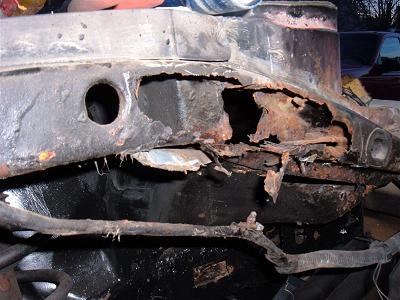

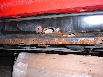

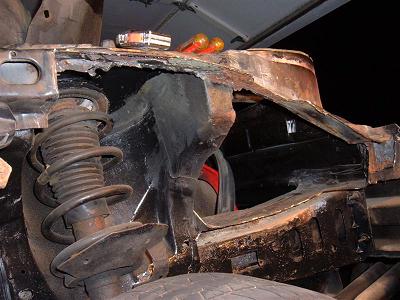

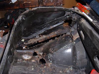

That front is repairable, but it's the back you need to worry about.
https://www.fiero.nl/forum/A...160323-2-121544.html
My front end looked about like yours, too
https://www.fiero.nl/forum/A...160323-2-124766.html

Yup, Don't do anything until look at bottom of car and rear frame hidden by rear inner fender.
Major rust rot on car frame areas often = junk car but you get fools claiming can "rebuild" them.
Rotten parts that bolt to the car can replace but above pic's is going to Eat time and a lot of money.
Example: You may/likely need a whole front end. Not replacing rubber bushings etc. Top bracket over spring etc rusted bad is a big problem. S-rack can hind "rust" in the rubber mounting.
Many Suspension parts like many bushings have Class 10.9 or better hardware and will need same if cut or heated.
If the bolt etc isn't rusted can split the seem in inner tube and use spray oil and wait for oil to work.
See my Cave, Bushings

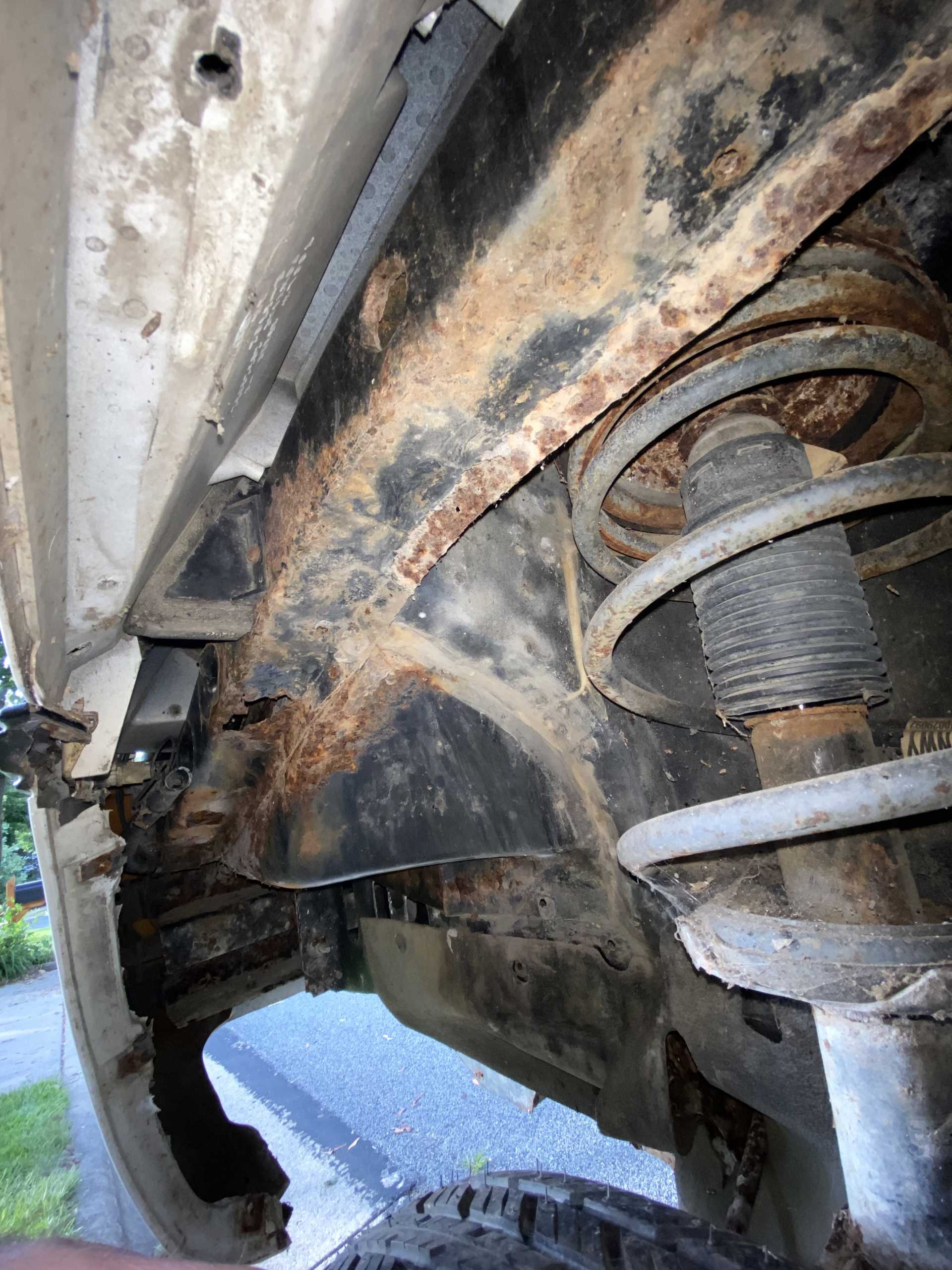

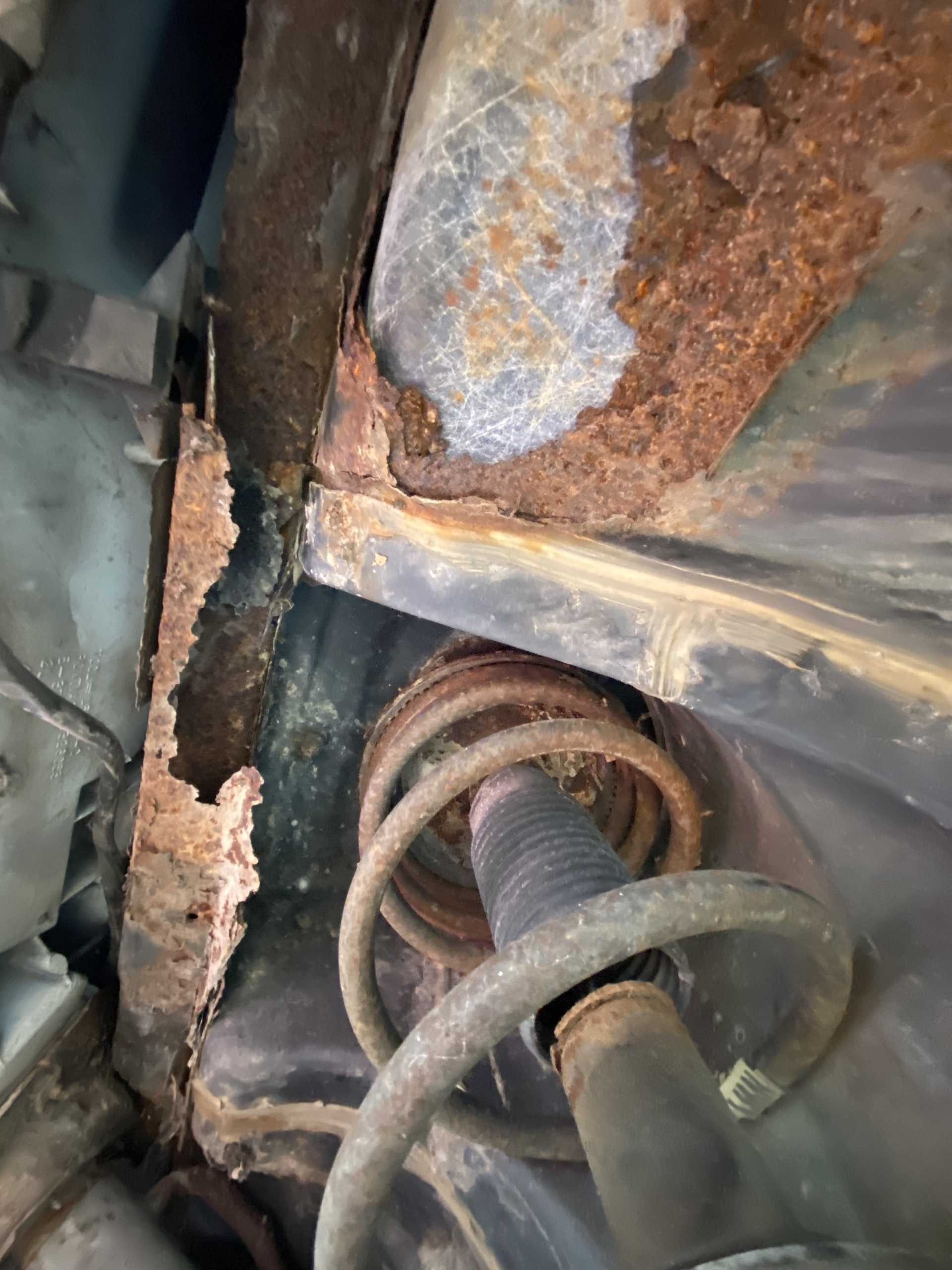

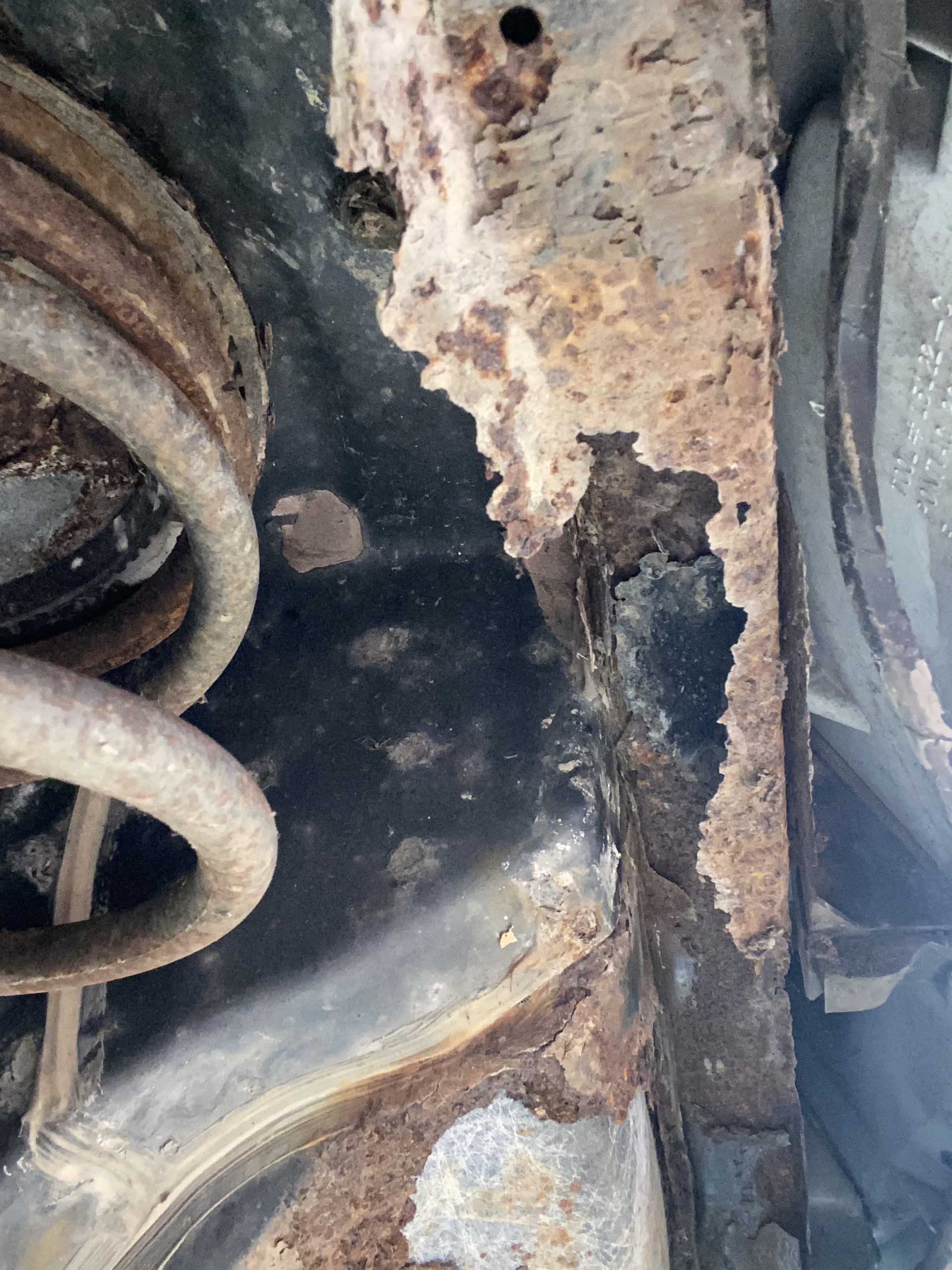

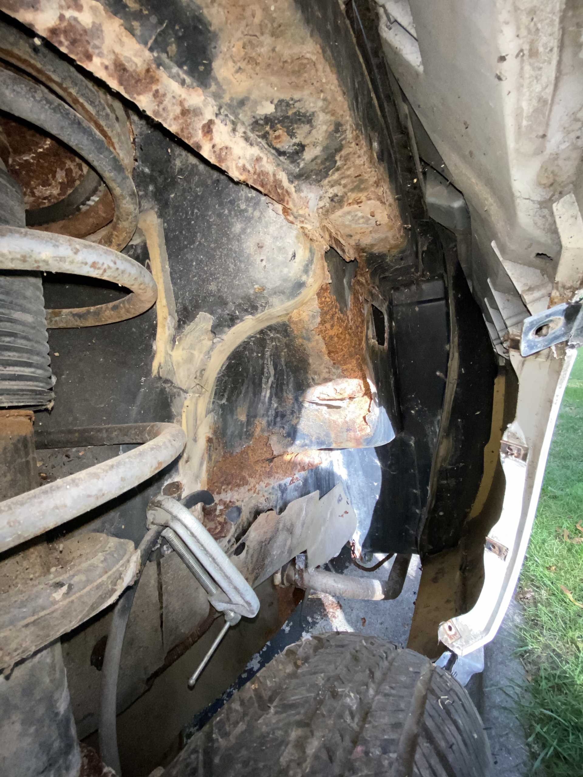

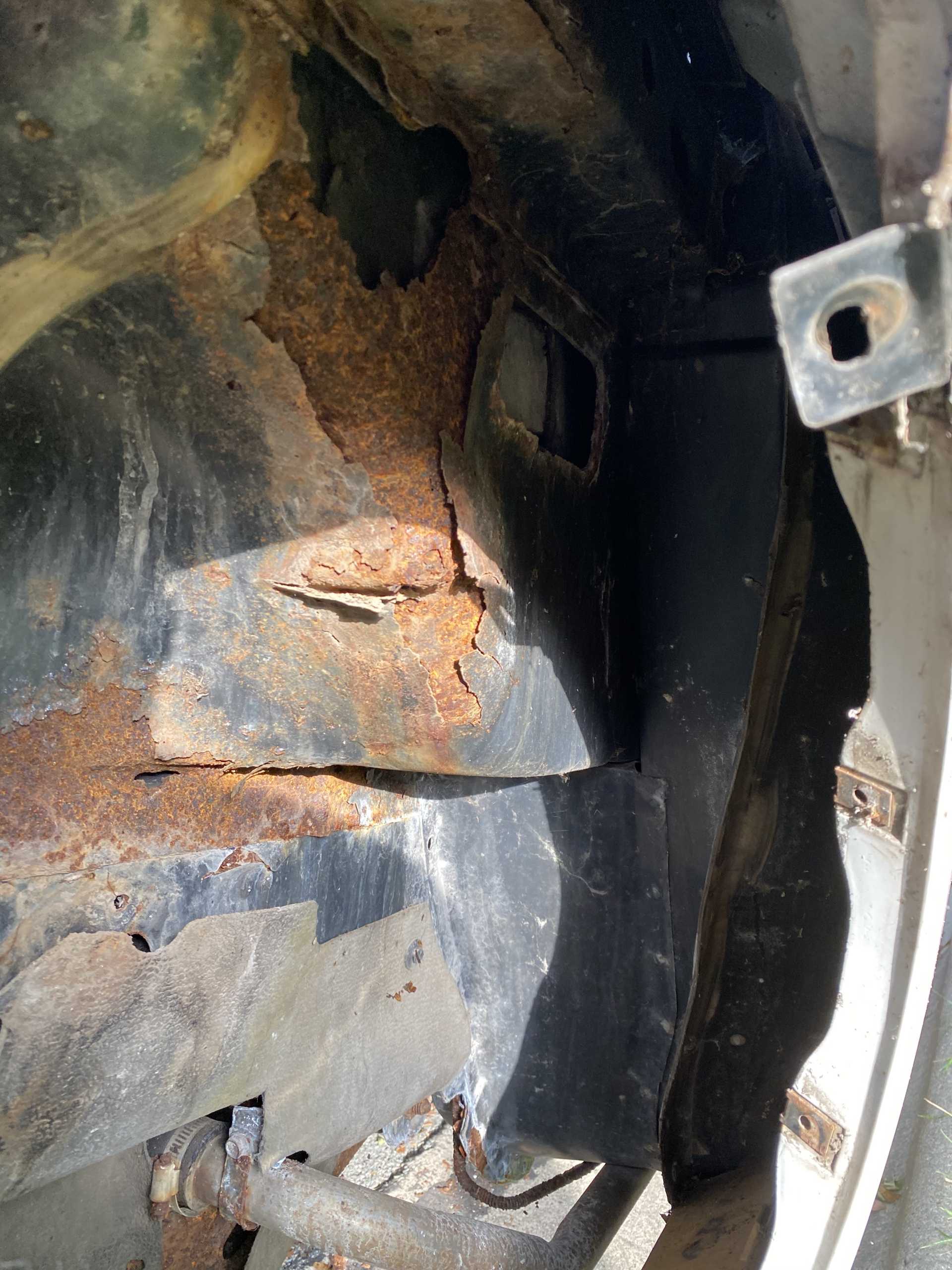

Who was I kidding, "...this weekend". I had to rush out after some delicious Culvers and pull those well covers off. The suspense was killing me. Here's the verdict.
Passenger side has the "normal" battery damage and a few spots in the frame, but doesn't look completely out of the question for some weld patching.
Driver's side is a different story. I am hoping you all can tell me that all hope is not lost and I can repair this. This is a marathon for me, not a sprint, so I am willing to put in time and patience. But, if it really is too far gone then....I guess I'll have to cry uncle. There is a big hole in the trunk bay—no biggie. But, it is these horizontal members next to the suspension that have me a bit worried. Someone give me some hope here.
PASSENGER:
DRIVER:

Your new acquisition looks to be in about the same shape as RDWPLZ's Fiero, so you're looking at a similar repair job as what he did.

It is no longer a logical task, but if you love the challenge and have the time, you could save it. I am amazed by the restore that RWDPLZ did on his car, and if you can read and understand his thread and feel you want to do it....good for you. The sensible thing is to part out this car, save your money, and find something requiring less work. (it won't get any better sitting in a barn for more years.... )

I hope you come to your senses and abandon this particular project. I'm not trying to be mean, but Fieros in much better condition can be had for next to nothing.
Look on the bright side... you've got a parts car now to draw from while restoring a different Fiero.

😆😆😆 touché! Yeah, I am 99% at it being a lost cause although I am looking at frame prices at scrappers....

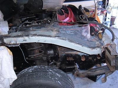

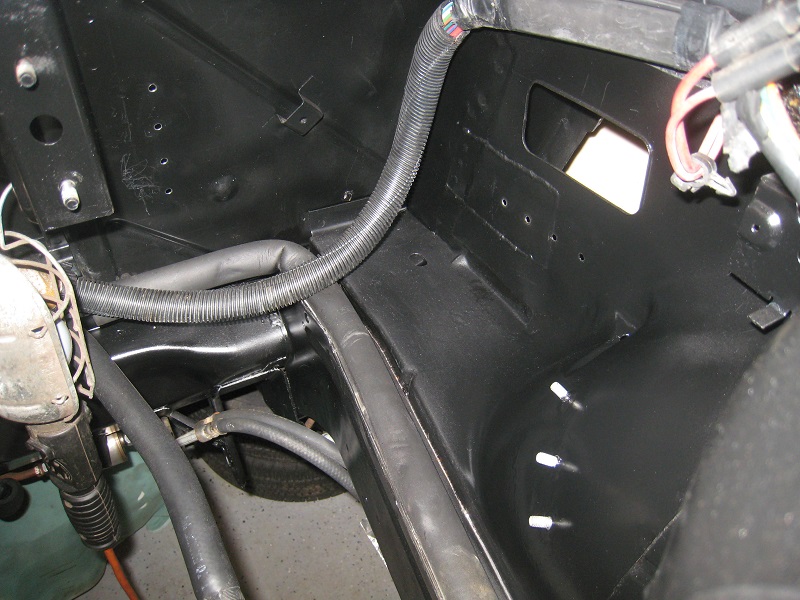

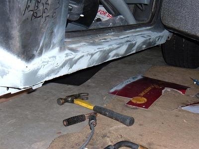

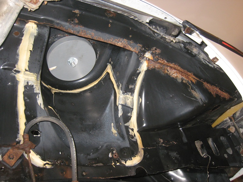

Mine was similar but maybe not tat far gone
Upper frame rail on driver's side
Trunk corner
Rockers
Cut out the rot
Make new rail from box section and weld in
Ditto on rockers, this is the pass side which was much worse then the driver's side above. I sem to recall I just patched the driver's side but this side was gone.
I used what was left of the old trunk corner and some sheet metal to replace the driver's side trunk
Overall it saved the car, or at least kept it going for a few more years. Sold it a year or so later as it had lots of other rust issues and really wasn't long for this world.
I enjoyed doing it as I'd never done that much frame/metal work before but honestly, I wouldn't do it again unless the car was really special to me.
Yours looks to be in much worse shape overall so personally I think you'd be better off finding a better starting point and parting out what you can from this one.

It isn't as bad as mine if the strut tower hasn't separated from the lower rail yet.
If you can weld, or want to invest in the equipment and learn, go for it. I don't know where people live that they can just go spend a few dollars and 'get another one' but it really isn't practical where this kind of frame rot occurs with the modern cost of shipping and the way Fiero values are right now. You could spend $2000 on another car and $800 in shipping it, and very well end up being in the same predicament.

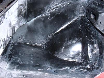

Here is my $2200 CAD Fiero (this one happened to be 1/2 hour away from my home in Grand-Mère):
Not bad, I got away with three small patches in the trunk, one patch near the battery, and a battery tray replacement. It really didn't need much.
Here we can see the small battery tray area patch I did:
You can get decent for cheap, but I can't say I fully agree with the "scrap it it's rusty" mantra we have here. If we always apply this mantra, well we're encouraging our favorite cars to be scrapped. At some point, to prevent Fieros from going extinct, they must be repaired.

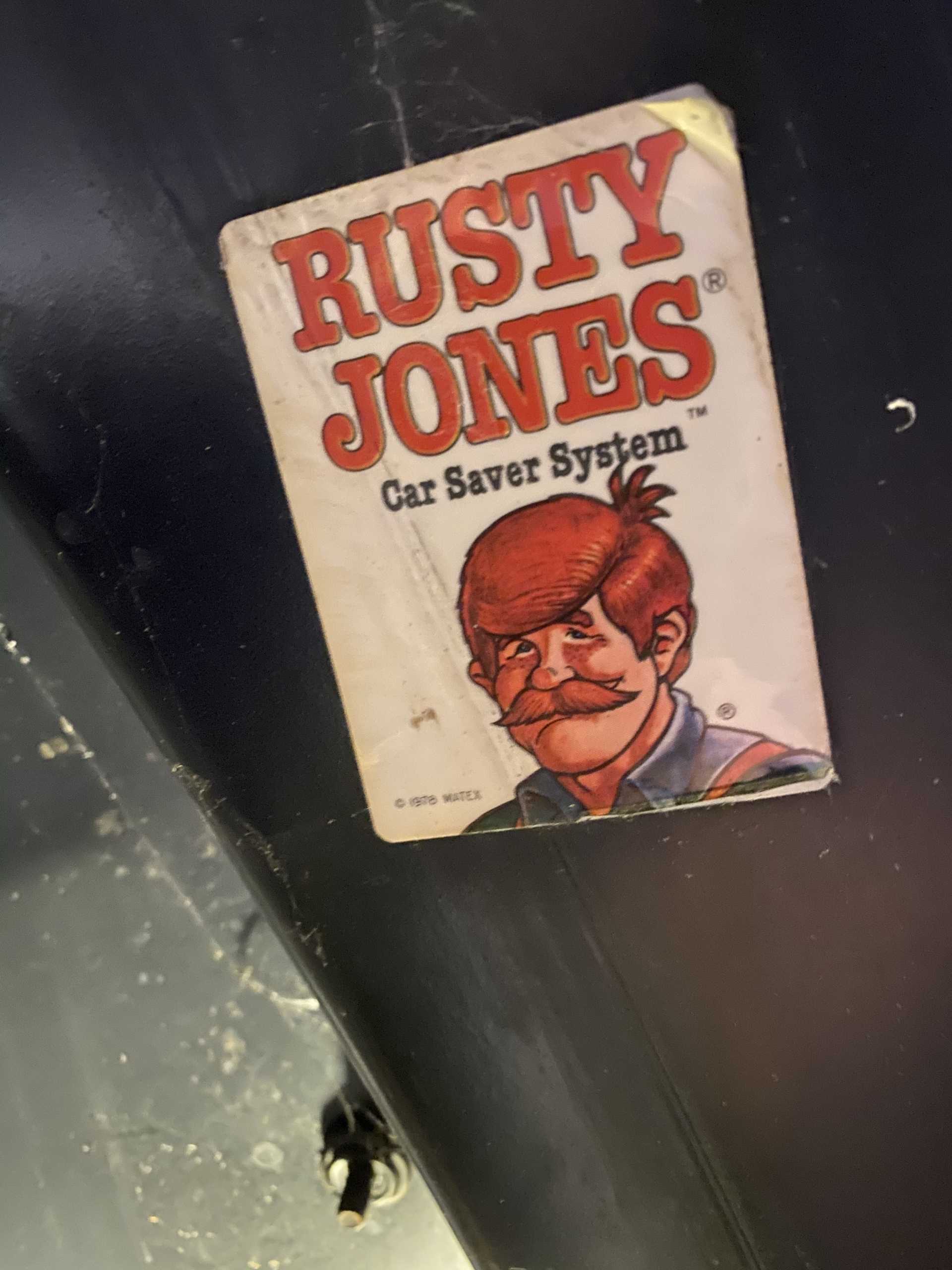

Here's the irony of this whole thing....stuck under the rear deck lid. 😂
RWDPLZ
Posts: 15087
Registered: May 2002
Total ratings: 305
Report this Post08-06-2020 10:54 PM Click Here to See the Profile for RWDPLZSend a Private Message to RWDPLZEdit/Delete MessageReply w/QuoteDirect Link to This Post
Had to look that one up, apparently they filed for bankruptcy in 1988. Pretty obvious why now
Originally posted by RWDPLZ:
Had to look that one up, apparently they filed for bankruptcy in 1988. Pretty obvious why now.
IrnDuke, I'm definately not laughing at your misfortune... but damn... Rusty Jones... protecting a rust bucket... and going broke... that's kind of funny!

I'm guessing the rust problems on the "frame" are only to be worse as you look more. More so if had RJ "rust proofing..."
