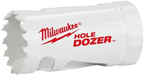

I punched out the metal core and used a hole saw of appropriate diameter to drill out the rubber bushing. My cradle was on the floor.
