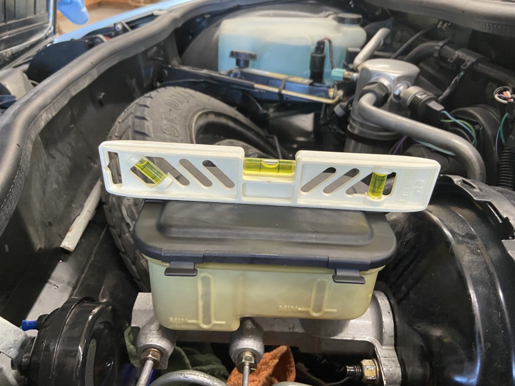

I know how to bleed, been doing it for years on other vehicles. I use a vacuum bleeder and have good results. Went to replace the master and flush the system, bench bled the master, kept the hoses on it to the very last minute, ... but the Fiero just wasn't having it, especially in the rear. Continously bubbled and the pedal was as soft as a teddy bear.
Finally read through the cave section about how the master isn't level. The car is up on stand and LOOKS level ... but for grins, I'll actually check:
Crap. So much for my ability to judge level! (Yes, I know the snaps aren't right either, but you get the idea.)

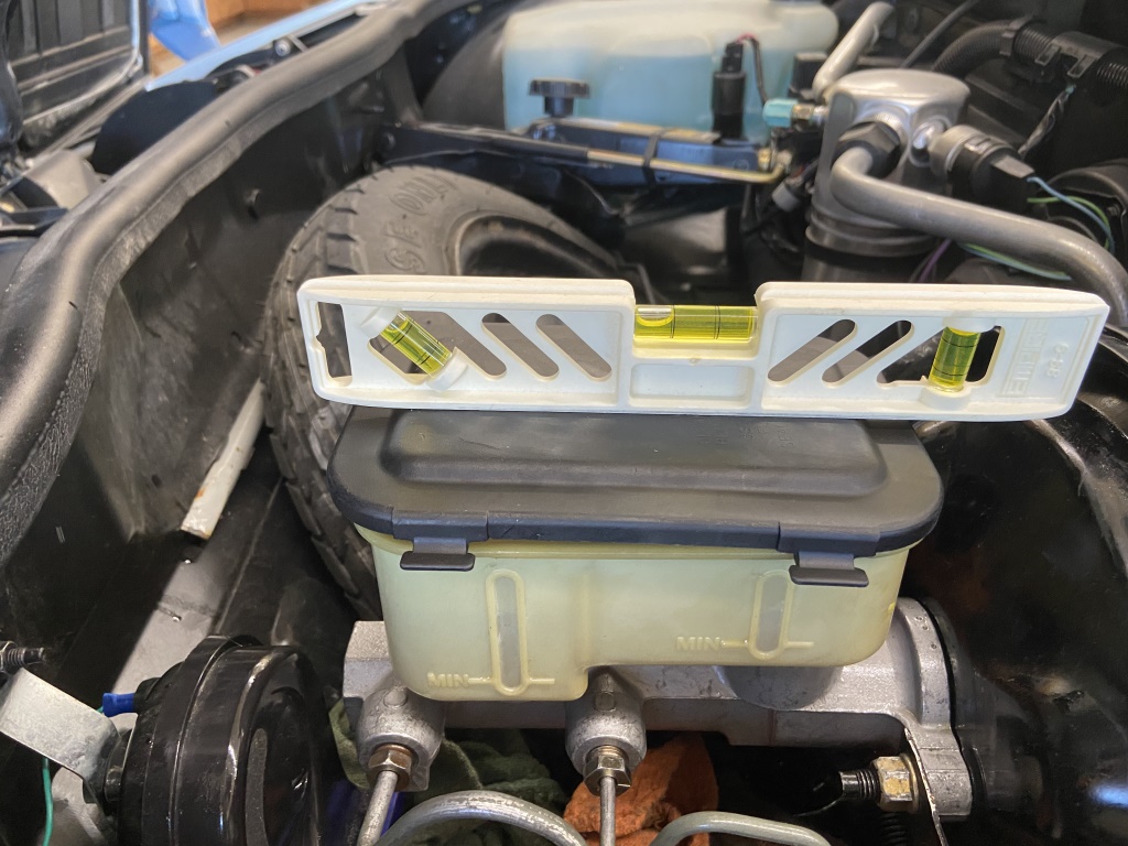

Jack up the rear end a bit more, extending the stands accordingly, and now
And whatddyaknow, the damn thing bleeds properly. Bubbles came out the back for a while and then nice, solid fluid.
So, easy thing to check and easy way to check, tip your car like you tip your barista, and a tip of the hat to the Ogre for this tip about bleeding.

Yup, it's a good tip.
I was able to get my brakes bled this way, even without bench-bleeding the master cylinder.

Yup... Fiero MC is problem to bleed.
Other cars can have same problem.
Even many bench bleed on a real bench but MC isn't level get same problem.
Tip nose down often cause same but bubbles are trap toward rear of likely both pistons.
Might move during install and exit or trap as shown in cave.
Bench bleed "kits" come w/ them can have problem too like the Plastic "Nuts" can leak air around molding defects. you have to check the "flare" side and tube side of them.
