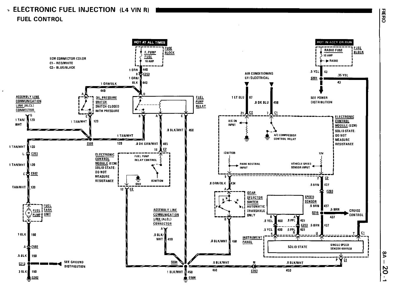

Schematic. Did you check ECM connectors?

am I correct in this: the aldl will send power Straight to the pump if jumped, the oil Sender will only send power to the pump If there is oil pressure, the relay will only send power If the ECM tells it to. so turning on the key, nothing at all. Jump the aldl the pump works and it will start. the engine KEEPS running because it is getting power from the oil pressure switch because it has oil pressure when it's running so it keeps sending power to the pump. so it has got to be it is Not getting initial power from the fp relay to begin with (New relay), so the problem goes back to the ecm not sending power to the fp relay ???
That's how it works.
Relay or ECM - or wiring/connection between the two I'd say since "key on" doesn't prime the pump.
OP switch is a backup in case fuel pump relay fails.
A test light can tell you whether the ECM is sending power to the relay.
Only a few seconds to prime with "key on", but should be constant with engine running.

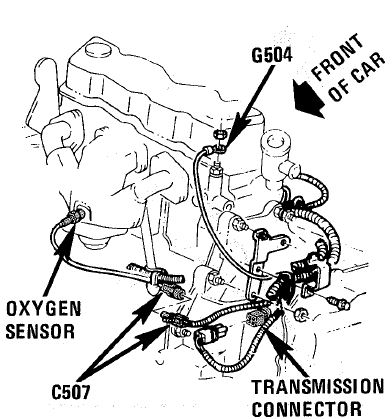

Check Ground G504 on engine near thermostat housing.
