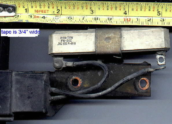

Does the fan have the resistor on it?
That's what drops the voltage for low speed operation.
Ogre's Cave http://web.archive.org/web/.../~fierocave/fans.htm
Here are the wiring diagrams.
