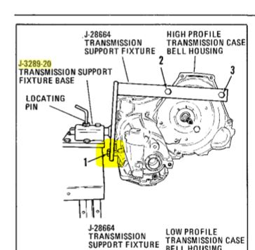

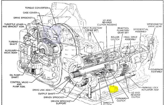

Over the weekend my transmission sprung a bad leak. A mounting tab \ screw broke off causing a bad leak. It appears this was an on going issue as the piece that broke off was covered in silicon and the screw appears to have been stripped. The mounting point that broke off is located just above the rear transmission mount. It's the highlighted part of the pic below. I think this is it because the piece that broke off is barrel shaped.
Can anyone tell me what this mounts too?

looking in my 85 GM manual, it would appear that the fitting you are having problems with is used for a maintenance/Disassembly mount- It attaches with two bolts thru the bellhousing up high and then one down at that spot...Then you lift the trans & bracket assembly and mount it on secondary bracket on the edge of a work bench.
The tool/bracket is PN J-28664 and the other bracket is J-3289-20....I would suspect that someone rebuilt your trans and somehow damaged that fixture on the case in the process....

Ok , I found the source of the leak its the upper mounting point of the bracket for the rear trans mount. It faces the rear drives side tire.

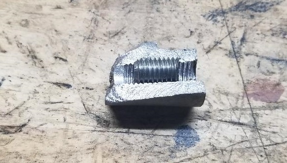

Option 1: Use JB weld do weld a bolt that I cut the head from and then JB weld the broken piece to the transmission. I will not longer use this mounting point to mount to the bracket.
Option 2: Use gasket maker and fill in as much as I can to cover the hole that's on the transmission.
What do you think?
Here is the broken piece.
