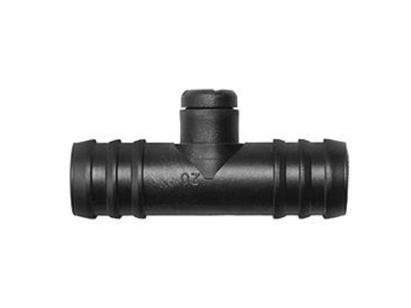

Thinking of installing a T fitting to the heater hose to help with burping but for now I want to purge it the way it is.
How should I burp the core? Hot or cold? Engine running or not? Thanks.

Can't get those heater hoses off so I'm gonna cut the bigger, upper one and install a bleeder valve. I have an AC car. I bought this one:
Wondering where to cut the hose... I guess the higher the valve is the better. Does it hurt if it won't be pointing upwards but rather at an angle? Or will it not do its job at all?
Say if it was installed like shown below with the blue arrow being "up":
[This message has been edited by cebix (edited 11-09-2019).]

I wouldn't add that fitting.
Pull the thermostat and drive it a bit.
The heater core and the rest of the system will work the air out and trap it in the top of the radiator so that it will self-burp.
cebix

Still don't understand how that fitting can hurt anything? Is it not a good idea to try it anyway? What I'm trying to achieve with this is burping the heater core as the cave states but without removing the hose and using a bleeder valve.

The heater core has constant coolant flow whenever the engine is running, not dependant on thermostat position. It has no choice - it has to push the air out due to flow, unless that flow is greatly restricted by a crushed supply tube, a kinked hose or a hose that is delaminating internally.
Even if there was a bit of air in the core, it would have absolutely no effect on the overheating of the engine, if indeed that is still happening.
I would not add the fitting because it is not needed.
