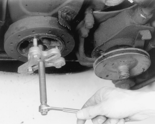

Originally posted by ttt123:
Only vid or help i seen on youtube was two pry bars...
Found this image online which is similar to the type of puller I use/have.

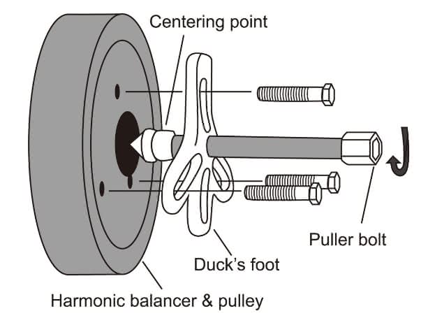

Yay!! I just got it off. So those tiny little holes lead to some 6mm screw holes way down deep. Went up and bought some and used my puller. Thanks guys and sorry for the pointless thread. I do appreciate the input, these forums make backyard wrenching so much easier now.
