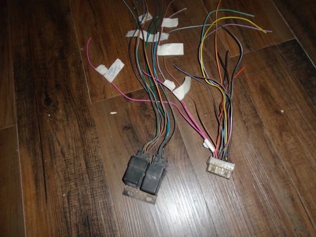

"Attempting" to put together a swap "Harness". I've got everything put together per GMTuners chart, BUT, there is NO chart for splicing in the " 203 plug" and "AC and Fuel pump Relay's". Here's what I have, but where do the other 11 wires Go to ??? Thank You for your help

Did you ask Ryan at GM tuners?

On the Sinister Performance website, go to 'Technical Info', then 'download wiring diagrams and pinouts'. The ninth item down is for the Fiero C-500 and C-203.
