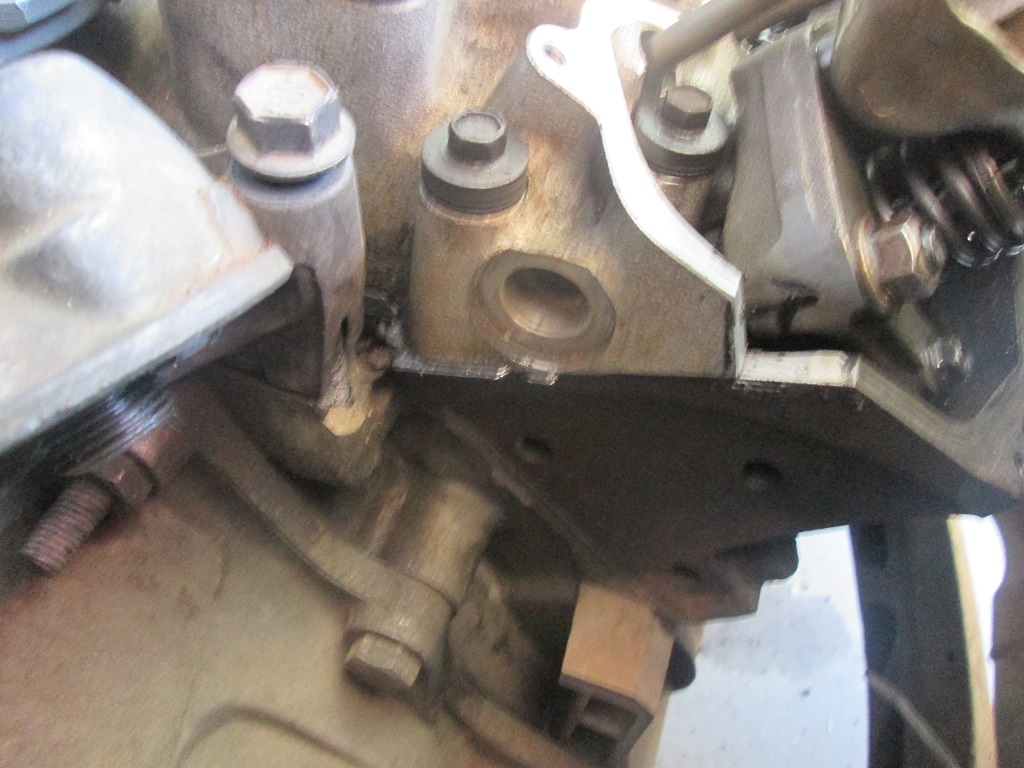

The heater hose connection to the intake is made to a formed pipe which is inserted into a hole in the rear of the intake. The pipe on my intake has come loose. There does not appear to be anything mechanically holding the pipe in place. I don't think that pushing the pipe back into the hole will hold since it is quite loose. What approaches have you used for this connection. I was thinking of getting a pipe thread fitting and tapping the hole, but there is not much meat around the hole and I am afraid it will crack. Pictures below.

I might be inclined to just clean both mating surfaces thoroughly, and use two-part epoxy or JB weld to hold it in.
If you can expand the pipe just a bit in order to make it a "force fit", it might help. I would still use the adhesive.
I have the same setup, but my pipe appears to not be going anywhere. I did, however, use JB weld to block off the heater hose fitting on the back of the water pump. Then I installed a rubber cap over it. (If yours is an 86 or older, please disregard. You will need that fitting.)

I concur. You are working with cast aluminum. JB Weld will seat that tube securely
