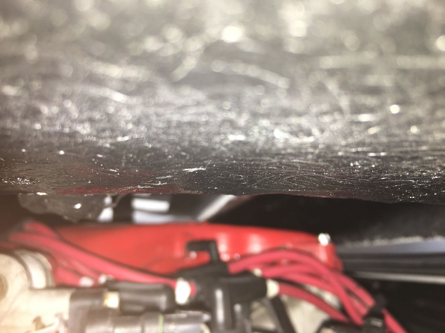

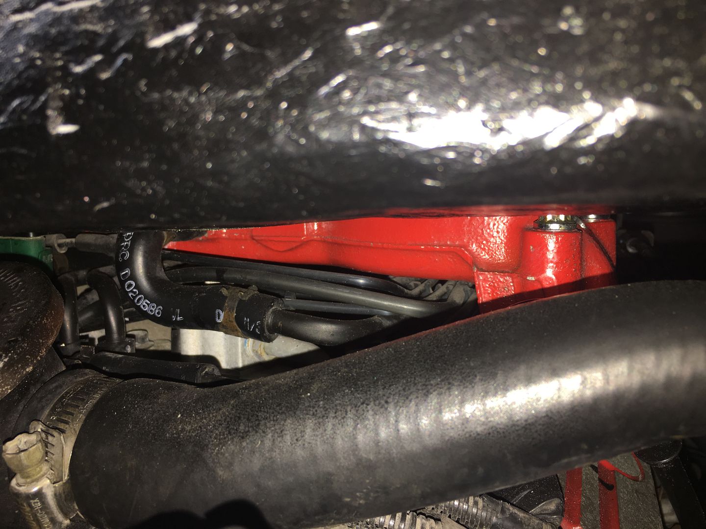

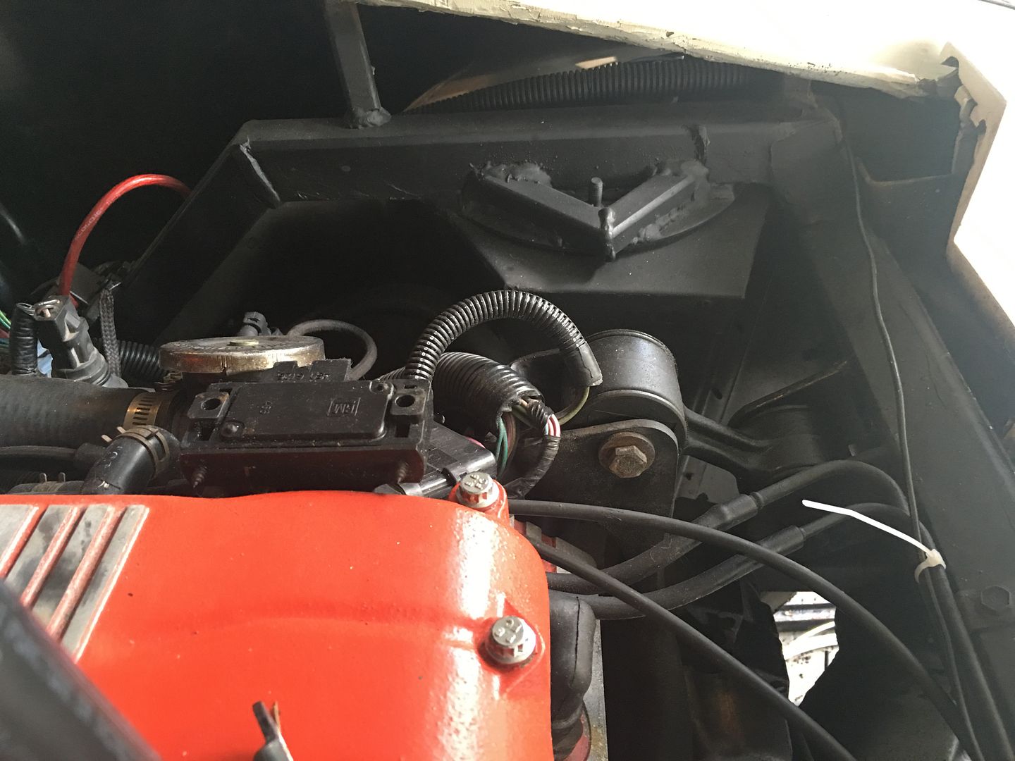

Hello I was looking to do an engine swap on my kit car and was looking to see the deference in height between 3800 and 2.8. I may have a clearance issue in the back end is completely custom tubing but stock 84-87 cradle. Any measurements would be appreciated. I was planing on using Rogers mounts unless any other suggestions.

I was planing on doing an l36 with a 4t65e then turbo later. I tried to attach some photos I have decklid clearance issues already.

If you plan to do an 3800 N/A swap, you may not have clearance issues. If your deck lid has the lifted center section you should be ok. Without it probably not.

Yes it has a small area that I hope will clear I was hoping some one can measure from cradle to top of intake manifold. I was hoping to by some mounts that are pre made mounts. I spoke to Ryan at fieroroma he said it my clear being 90 deg engine compared to Fiero being 60.

The 3800 SC is not as tall as the 2.8. You should be fine.
