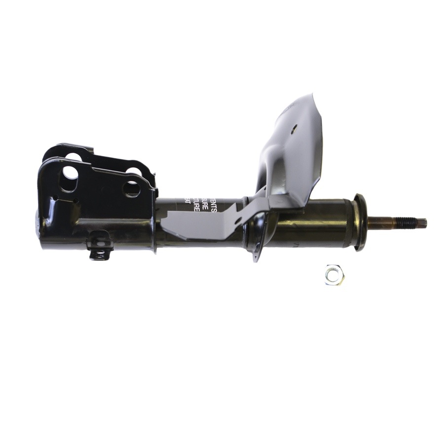

Report this Post07-17-2015 03:10 AM Click Here to See the Profile for TheDigitalAlchemistClick Here to visit TheDigitalAlchemist's HomePageSend a Private Message to TheDigitalAlchemistEdit/Delete MessageReply w/QuoteDirect Link to This Post
Found it- there's a flattish piece of metal that SHOULD be connected to the rear shock .That flattish piece isn't connected no mo.
Will I need to bring it in for alignment after I replace the shocks?

Originally posted by TheDigitalAlchemist:
Found it- there's a flattish piece of metal which connects the bottom part of the strut to the spring bottom thingie. That flattish piece isn't connected no mo.
The bottom of the strut attaches to the knuckle with two big bolts.
A picture is worth a thousand words.
Tell us again the year of your Fiero. Yes, it'll make a difference with this.
[This message has been edited by Patrick (edited 07-17-2015).]
86. You can see it here, it's the piece which connects to the middle of the rear shock.
http://m.ebay.com/itm/Monro...538258298?nav=SEARCH
Are you referring to the spring perch? What's the spring sitting on?
[EDIT] Oh, I see what you're saying. I don't know how that piece became disconnected, but no, you don't need it. I actually cut all that extra metal off my struts when I installed my lowering springs.
This silver piece...
http://www.autoaccessoriesg...or/lg/287/G55593.jpg
It's actually black ... but you don't need it. If it's rattling or banging around, take a hacksaw to it.
Plasma cutter rules, just be careful you don't melt the body panels close by.
But ya its not really needed. But yes you should have the alignment done after changing those, you can get lucky if you scribe the position of the old struts onto the body of the car, but I would have the alignment done anyway.

But yes you should have the alignment done after changing those...
Unless there is some other problem, why would he need to be removing and/or changing the struts? Heck, he doesn't even need to cut that chunk of metal off. Just bend it into a shape where it's not clanging on anything.
First, that is not a shock, it's a strut. fronts only have the old style shocks, rears are struts like on just about any other type of front wheel drives made today or back then.
http://www.shockwarehouse.c...enceshocksstruts.cfm
He asked if he should have an alignment done after he replaces the struts, he is mistakenly calling rear struts shocks and yes they do affect the alignment if you don't put them back, exactly in the same spot they were to begin with. Even then they may have been wrong to begin with so yes he should have an alignment done after changing his struts. All it takes can be hitting a pot hole to hard to throw off an alignment, or hitting a curb hard, hell it don't take much to throw an alignment off and as I said if he changes the struts he should have an alignment done, if he gets it done at a shop they will tell him the same thing. You can try and get it right by marking the holes but the chances of it being exactly right are slim unless you have some special tool, I forget what its called but it sets on the wheel bearing cap and has a level on it, not exactly the average owners tool. It can be done using the instructions in the FAQ section of the forum that shows you how to do a complete alignment to all four wheels, but like I said if he has a shop do the strut replacement they should recommend an alignment after replacing the strut, it is recommended when ever replacing anything related to the suspension.

He asked if he should have an alignment done after he replaces the struts....
I know very well what TDA said... and I was letting him know that replacing the struts may not be necessary. I have no idea why you've gone on and on "correcting" me.
