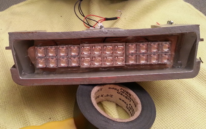

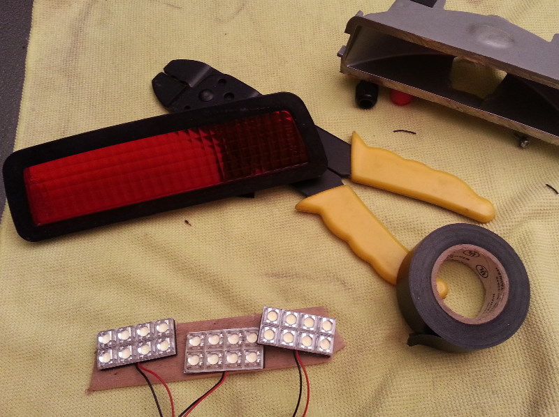

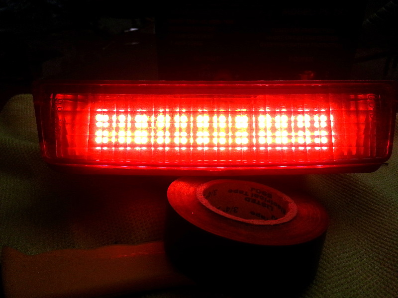

The interior part of my 3rd brake light was melted as well. When I was getting a replacement from the junk yard, same thing, melted. Seems to be a common problem. I put 3 of those small panels of LED's in there, and will never have that problem again You can either do what I did, or just purchase an LED bulb with the correct socket to fit in there. I preferred the look of the panel, as it fills the brake light evenly, and not just a glowing bulb in the center.
You can read all the details in this post in my build thread.
I used 3 of LED panels, end to end, and wired them all together. These are the panels I used.

How does it look in daylight?
I have the one from TLG and although its nice and bright, unfortunately its pink. I'll probably switch back to a regular bulb.

Is White LED? Yes then they often look pink/purple and ugly because of "color temperature" and other reasons. Anything above ~4200°K looks eh or bad from any vendor. high °K the more blue output for "white" LED.
Other reasons because White LED often in Not same White light from OE bulb.
