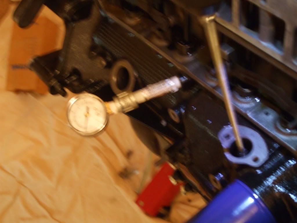

Don't worry too much about the speed. You just need maybe two hundred RPM. You'll be able to tell if you're going the right way because the drill will load up.
Unfortunately the only picture I ever took of priming a duke is pretty blurry.
