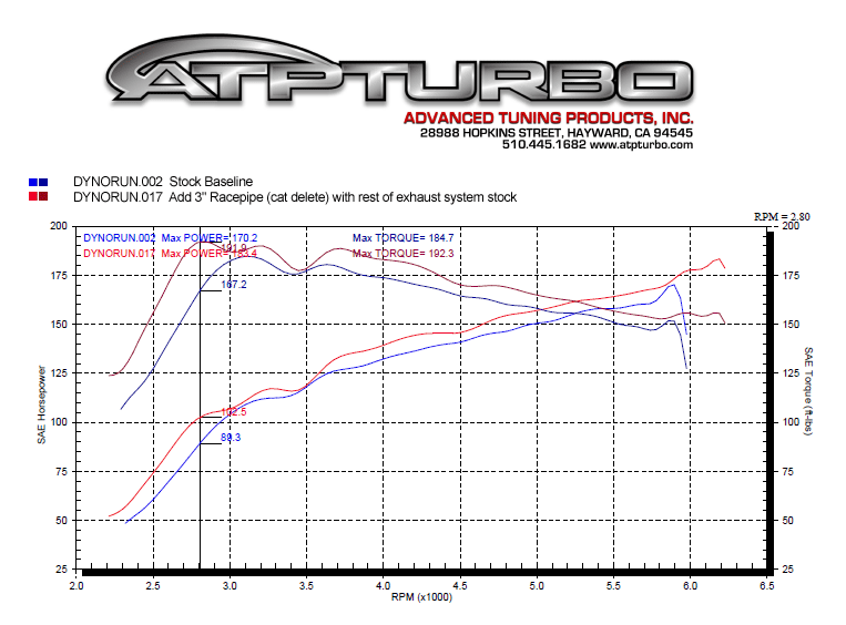

If you do some looking around, you probably won't find a lot of Fiero-based data, but there are certainly lots of with vs without Catalyst dyno plots to get an idea of what happens when they're removed, at least anecdotally.
Original link for context
Try looking around Corvette, F-body, Mustang, SRT4, etc forums for results.
You'll find almost universally that removing the restriction from the exhaust increases power.
[This message has been edited by KurtAKX (edited 01-15-2015).]
As I said, not all cats are equal. Also, not all engines are equal. There's a huge difference between modern large displacement V8s or turbo cars running 25PSI of boost, and a tired 30 year old Fiero engine, designed and built during a time when converters were still filled with pellets, and there wasn't enough sensor data or processing power and memory in the ECM, to be able to make active adjustments to changing conditions.
Likewise, removing the cat on a vehicle registered to drive on public roads in the US, which came with one originally, is illegal. You'll find almost universally that it is illegal even at the local level, as well as state and federal levels. But go ahead, and lets all burn the world down faster for that extra 0.1% peak HP number.

Simple fact is new current cat designs does not make much difference in exhaust flow vs exhaust w/ no cat.
Old OE cat could make more back pressure then new cats designs.
Entire exhaust system pressure should be < 1.25 PSI measure at O2 Bung at idle. Many are 1 PSI or less, even at 2000-3000 RPM. FSM and many others says 3psi at 2000 RPM is ok
Can change the exhaust sound because give space to expand similar to the muffler.
There is no difference between 30 year old engine and a new engine in terms of power lost due to backpressure.
There are no "magical PCM adjustments" to overcome the laws of thermodynamics.
Regardless of the number of valves, cylinders, cams, or turbos, power is a function of the mean effective pressure on the piston on the way down, MINUS the mean effective pressure on the piston on the way up, times how often you're completing the cycle. As you can see below, the higher the pressure is at the end of the stroke (the more backpressure there is at point 6), the less work (work is the yellow shaded area)
If you do less work per stroke, then you make less power since power is work per unit time. This is true in everything from Briggs and Stratton flatheads to current F1 cars.
