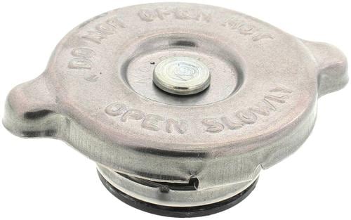

Does your radiator cap look like this:
or like this:
The one on your radiator should be this one:
The flat cap is for the thermostat housing on the engine.

The lever action cap also will NOT work. I always bought Champion aluminum radiators if I could. I had their 2 row replacement in my 413 CI SuperBee and it worked great. If I needed one fast locally, I bought Modine. The ones for my Fiero and one of my C4 vettes were identical...so if it can keep a 350 V8 cool, it should have no problem in any Fiero. All mine easily kept 160* temp no matter how hot it was outside.

Depending catalog use... Number listed could be non-vent, vented, or both types. Non-vent is correct.
