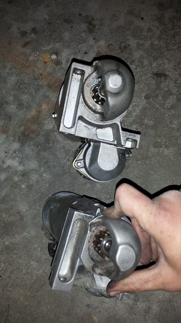

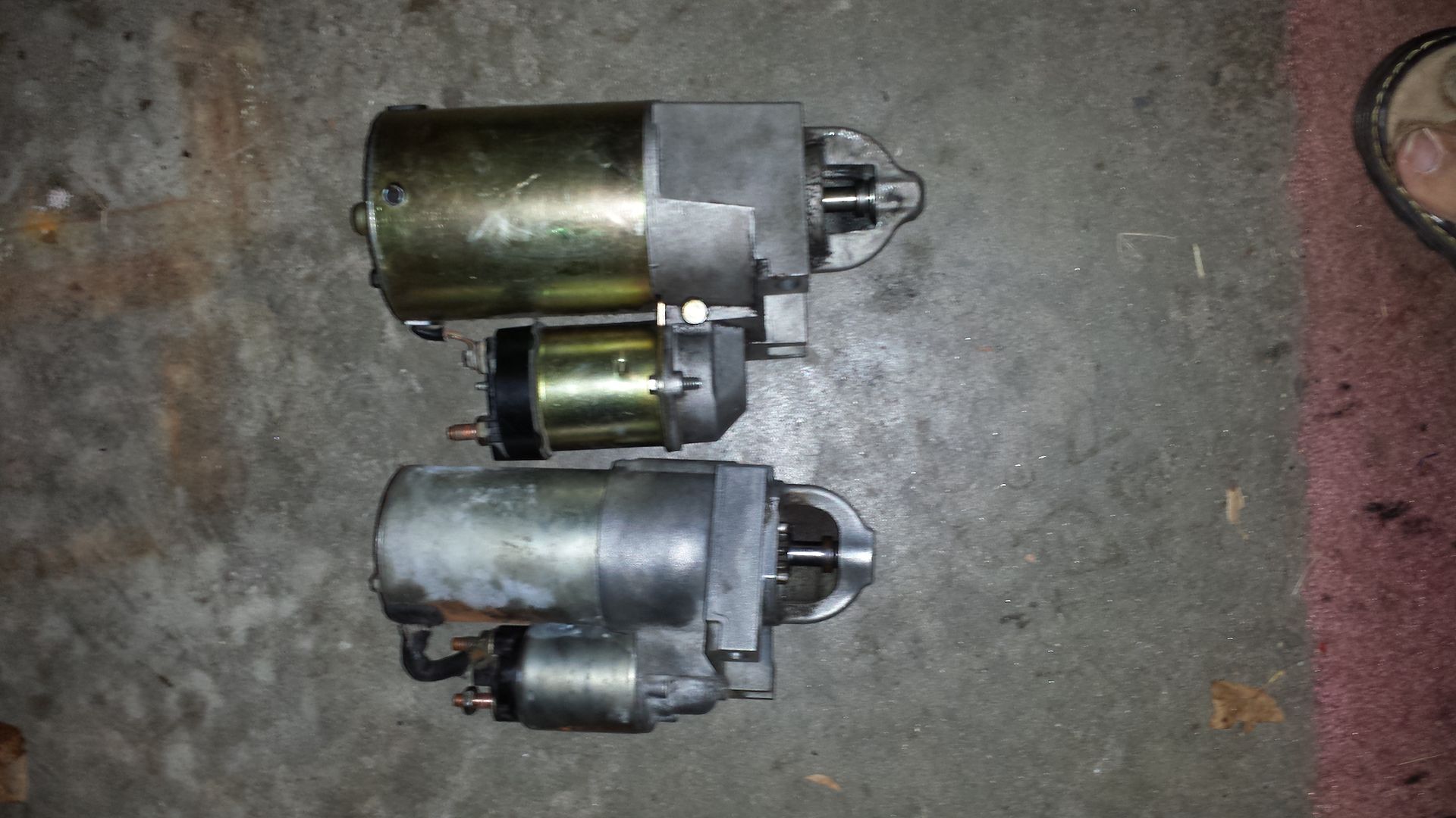

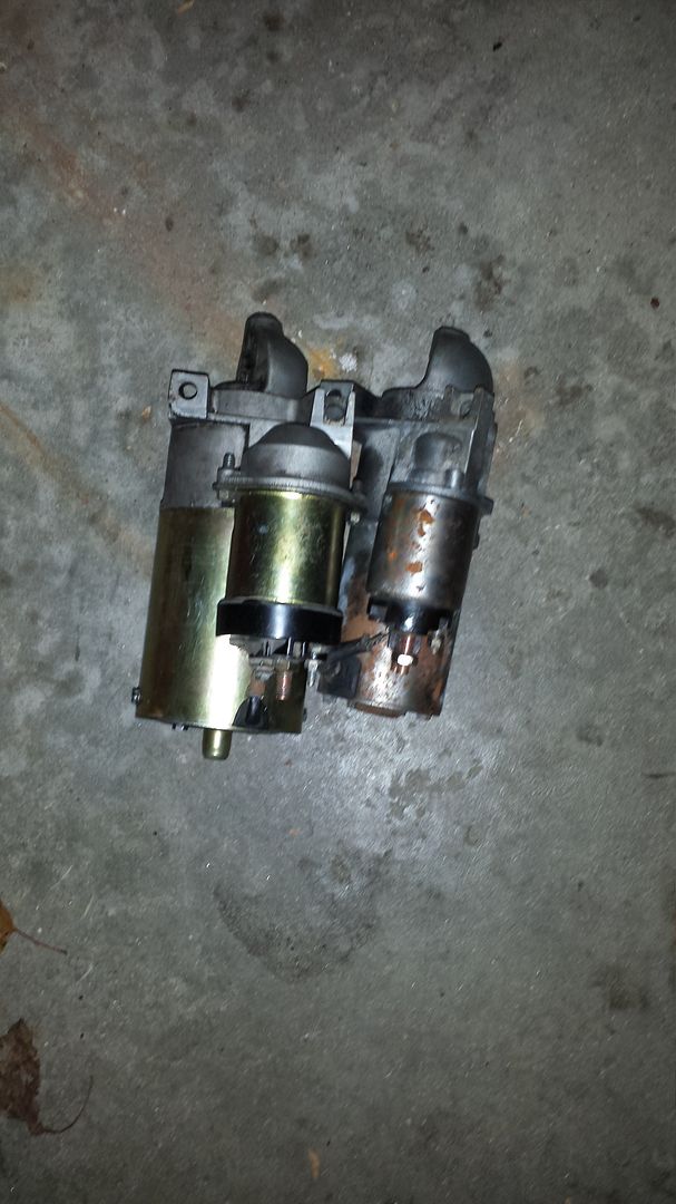

My 3800 will crank really slowly, and take a few tries to start if it has sat for a most of the day or overnight. If it has been run in the past couple hours it fires right up with no issues. It has a brand new battery in it already. I thought maybe the starter was weak and on it's way out. After reading a bunch of threads on here I read that my new low mileage 2.8 starter should bolt up and work with not problem. I swapped it out it bolted up with no issues. However the starter from the 2.8 was physically larger, so the + wire coming from my battery was just barely too short to reach the post.The car has a front mount battery so I went and bought 2 gauge welding cable and ran a new lead to the starter. When I tried to start the car, the starter sounded weak and made a grinding sound. I installed it with no shims, just like the original 3800 starter was. So I took the shim that came off the 2.8 starter and installed that thinking maybe that was my issue, same result.
Side by side comparison of the two starters
I then took the old original 3800 starter down to autozone and they tested it twice and it passed both times. Any ideas what could be causing my problem? When it takes a few tries to start it drains enough power to reset the radio.
