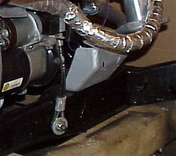

On my GT I installed a torque strap to limit rotation under torque.
It's just a cable attached to a transmission bolt and cradle.
Maybe your driving style requires one.

You shouldn't need a torque strap nor should you weld the engine in place. We are talking about the 2.5L (I have owned more than a few and never had a mount break)
